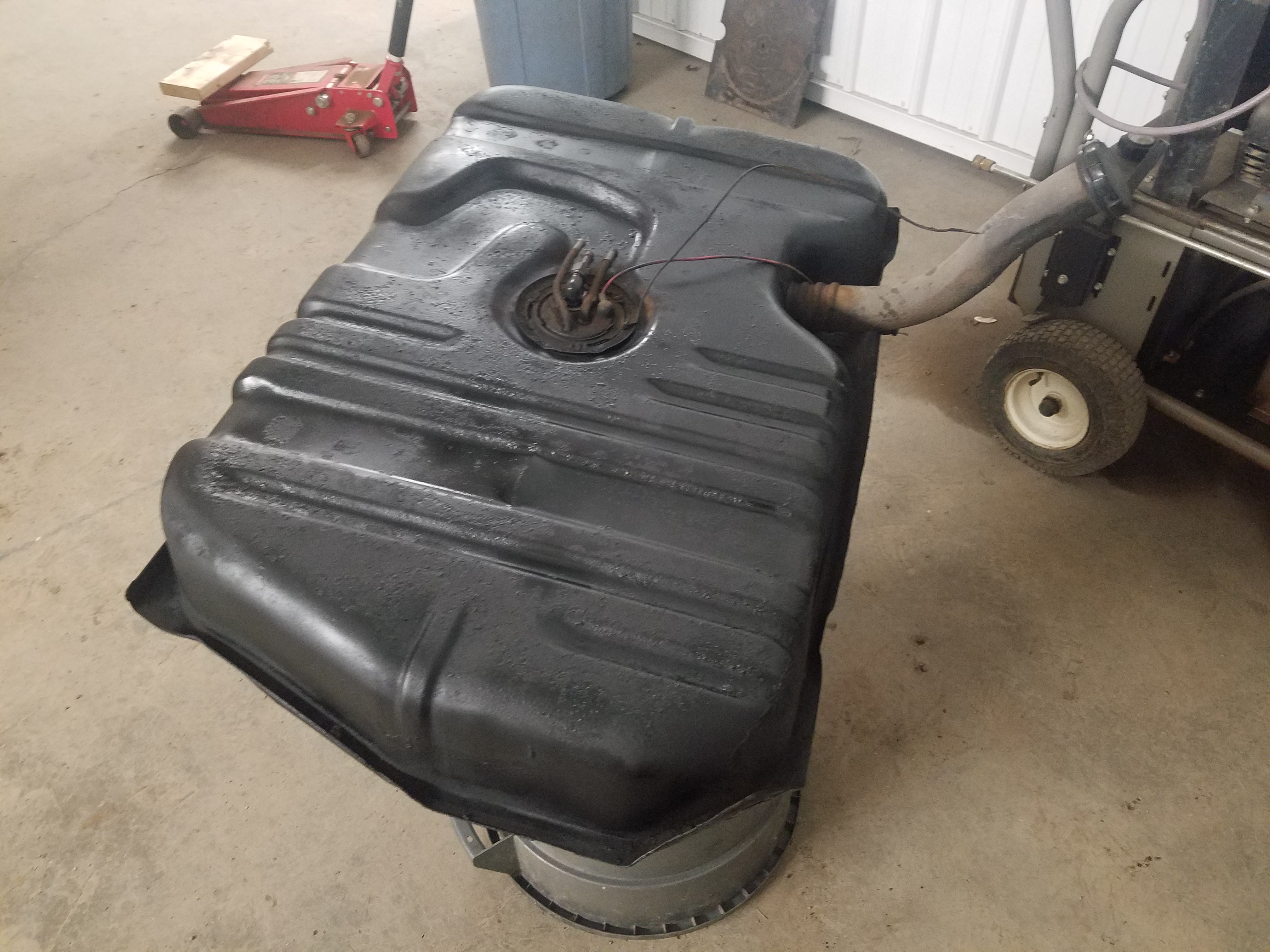

While my buddy is still doing the heavy lifting, between stuff I was doing at the shop gave the tank a quick scotch brite and then some flat black
that reminds me when I had the tank out I made shorter fuel and return line that ended close to the front of the gas tank and used fuel injection rubber hose to go from the pick up to the lines at the front of the tank. I find it easier to disconnect the lines before dropping the tank instead of dropping the tank just far enough to get the lines off the pick up and it's easier to put the tank in place then connect the lines...
