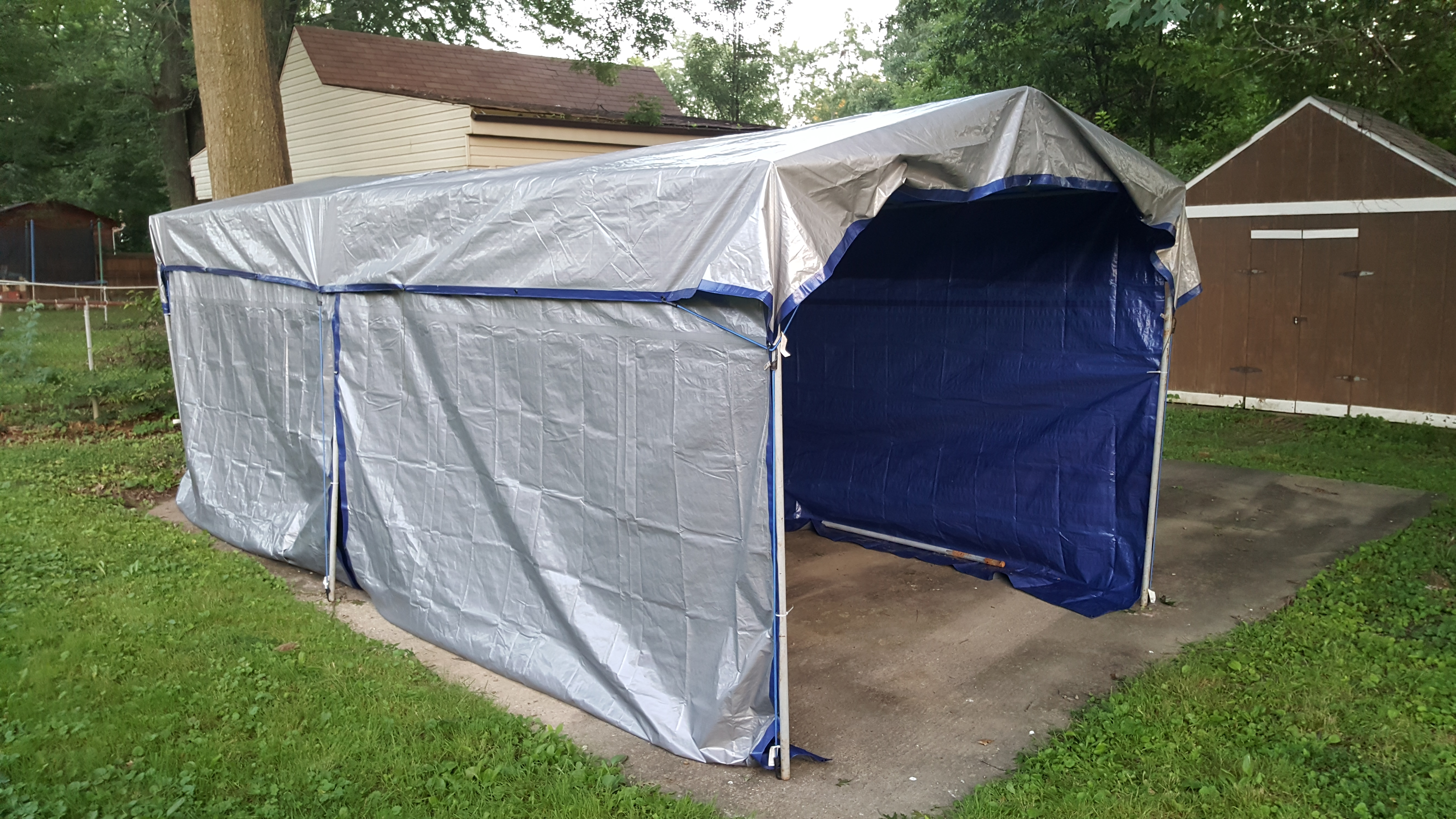

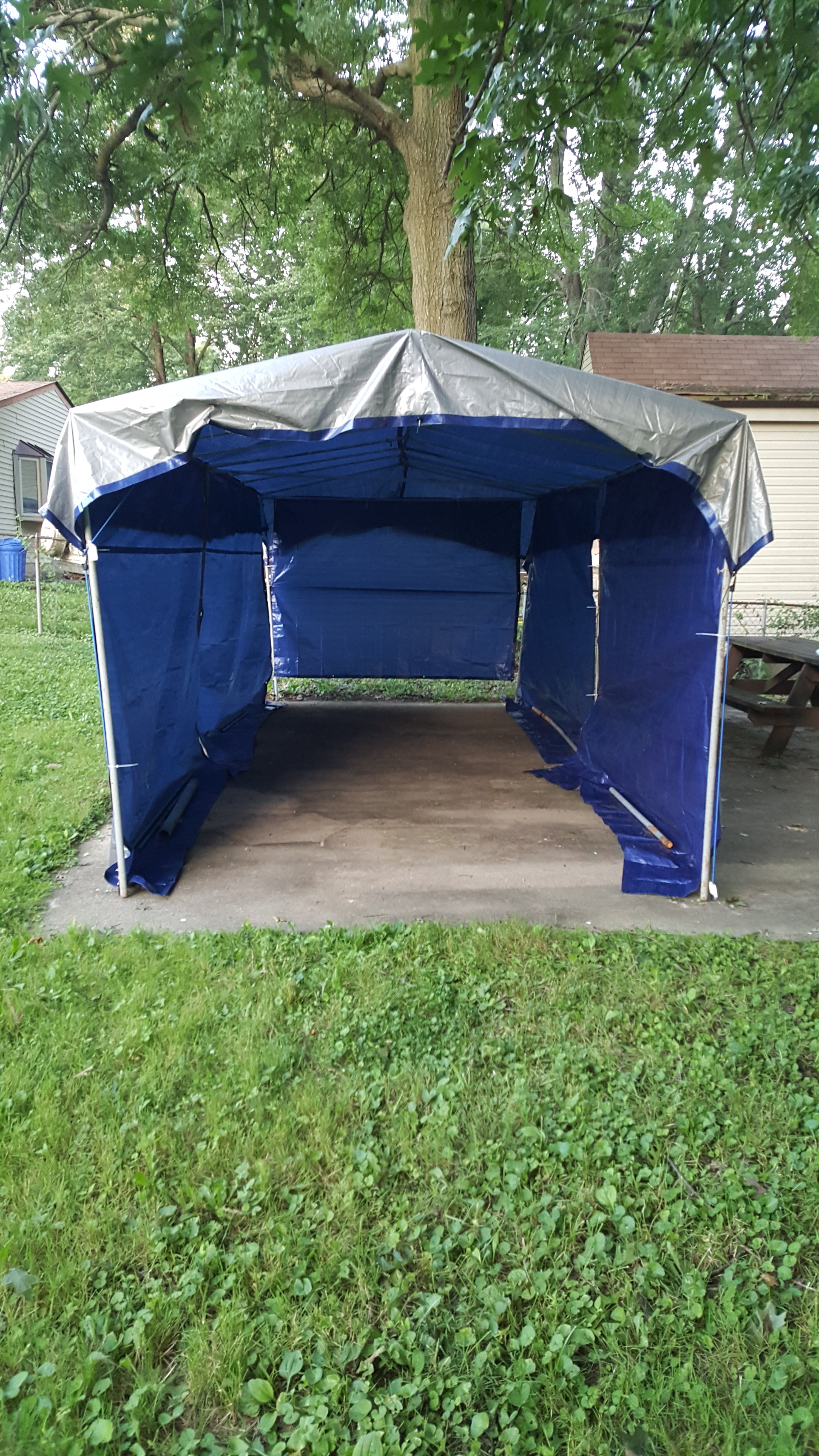

Didn't do anything to the Cutlass, but something for the Cutlass. I'm finishing up a temporary storage solution so I can bring the ole girl home! So with a healthy dose of backyard ingenuity lol, some tarps, paracord, zip ties and bungies it's looking decent! I still need a "door", and an anchor system, but for around $100 invested I'm pretty happy!!!!
