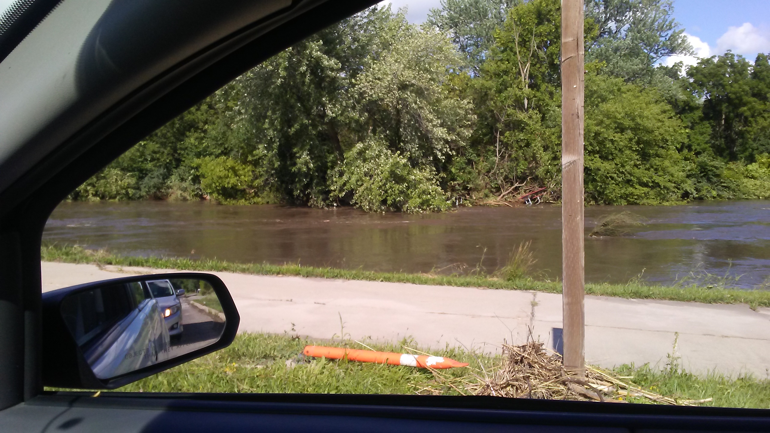

Changing my oil and filter 1900 miles early due to having to drive through rivers on the way home this past weekend and water getting in. Its a lil frothy especially in the breather, I think thats where most of it got in. Dipstick doesnt read over full so its not a lot, but any is too much. Midwest got tons of rain. Everywhere near a source of water got flooded. This is a creek near me... Usually about 2 to 3 feet deep at the absolute max. Here its about 18 feet deep.

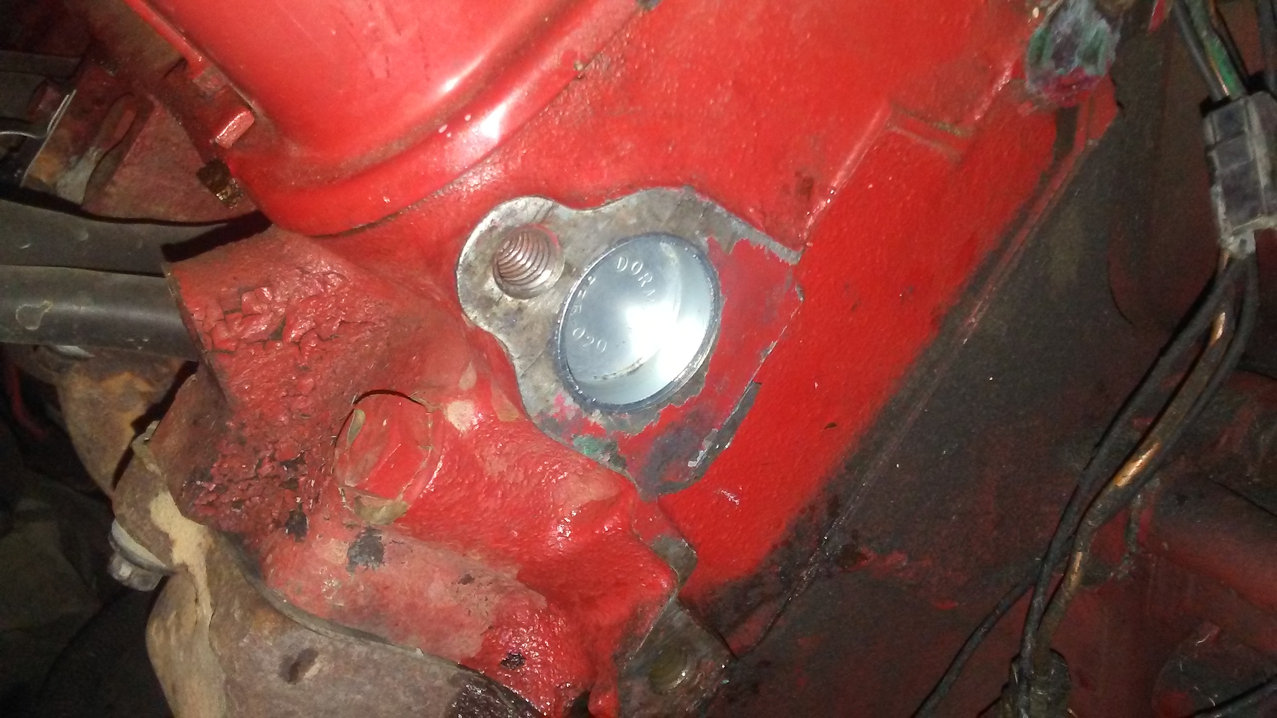

Replaced a leaky freeze plug in the passenger head.

Addendum, changed oil. No froth. Water in the breather confirmed as the entry point. Engine is fine.
