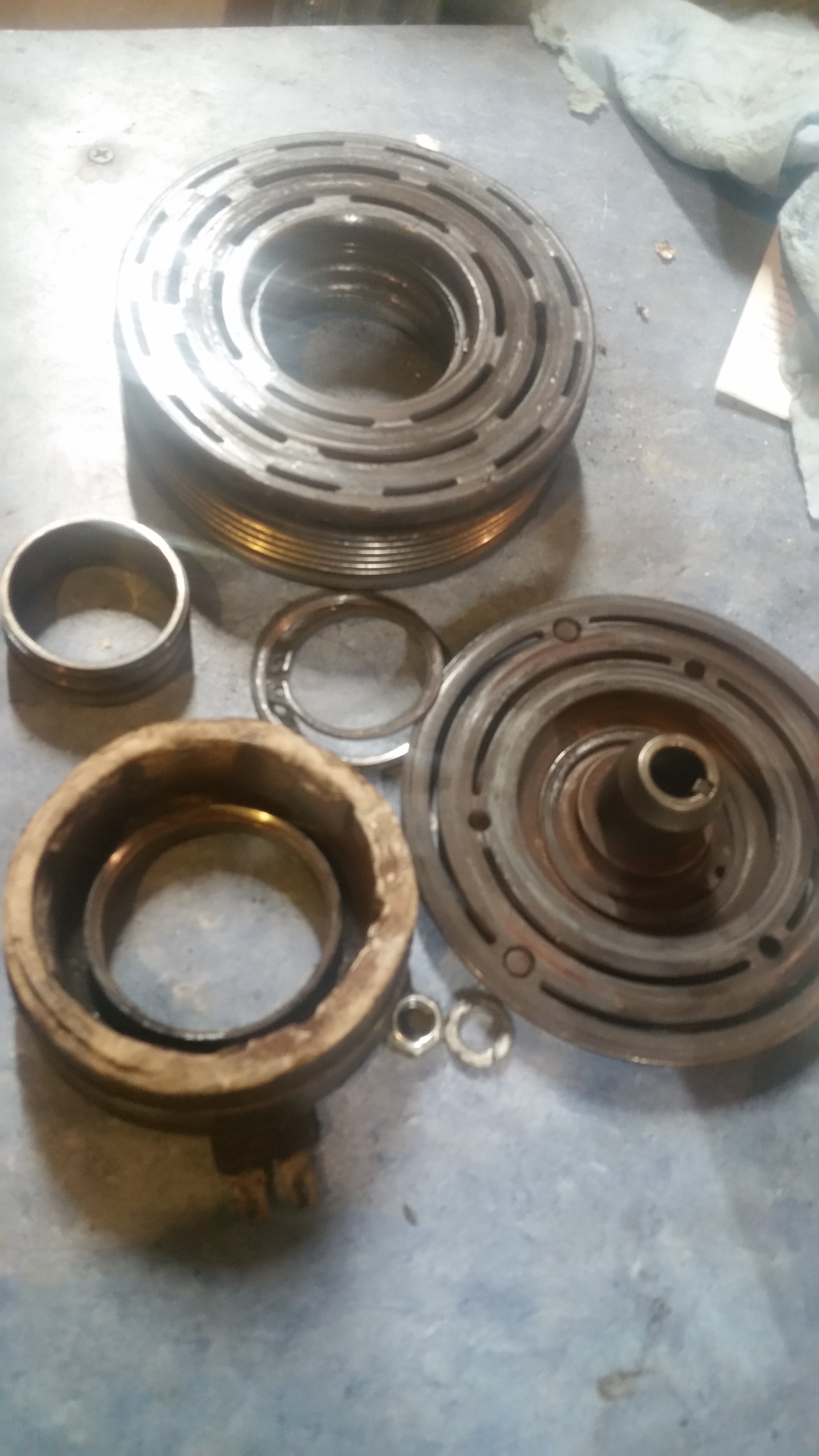

I decided to try and set the air gap on my A/C compressor clutch. It was too tight. I tried my A/C out. I seen sparks. After I changed the exhaust a while back the car is a lot quieter now. I have been hearing kind of a ruckus. I thought it was my belt tensioner. I am hard of hearing too. I took a bar and I could move the A/C pully around. Not good! I took the front of the clutch apart and this is what I found.
The bearing is out. I guess I caught that at the right time. So I took the rest of the clutch apart.
There is a car show four miles from my house on Sunday I want to go to. So I two day shipped a new A/C clutch assembly from Rock Auto. My wife and kids might go with me so that is why I was trying to get the A/C working to begin with. Wish me luck!

I decided to try and set the air gap on my A/C compressor clutch. It was too tight. I tried my A/C out. I seen sparks. After I changed the exhaust a while back the car is a lot quieter now. I have been hearing kind of a ruckus. I thought it was my belt tensioner. I am hard of hearing too. I took a bar and I could move the A/C pully around. Not good! I took the front of the clutch apart and this is what I found.View attachment 116585 The bearing is out. I guess I caught that at the right time. So I took the rest of the clutch apart.View attachment 116586 There is a car show four miles from my house on Sunday I want to go to. So I two day shipped a new A/C clutch assembly from Rock Auto. My wife and kids might go with me so that is why I was trying to get the A/C working to begin with. Wish me luck!
