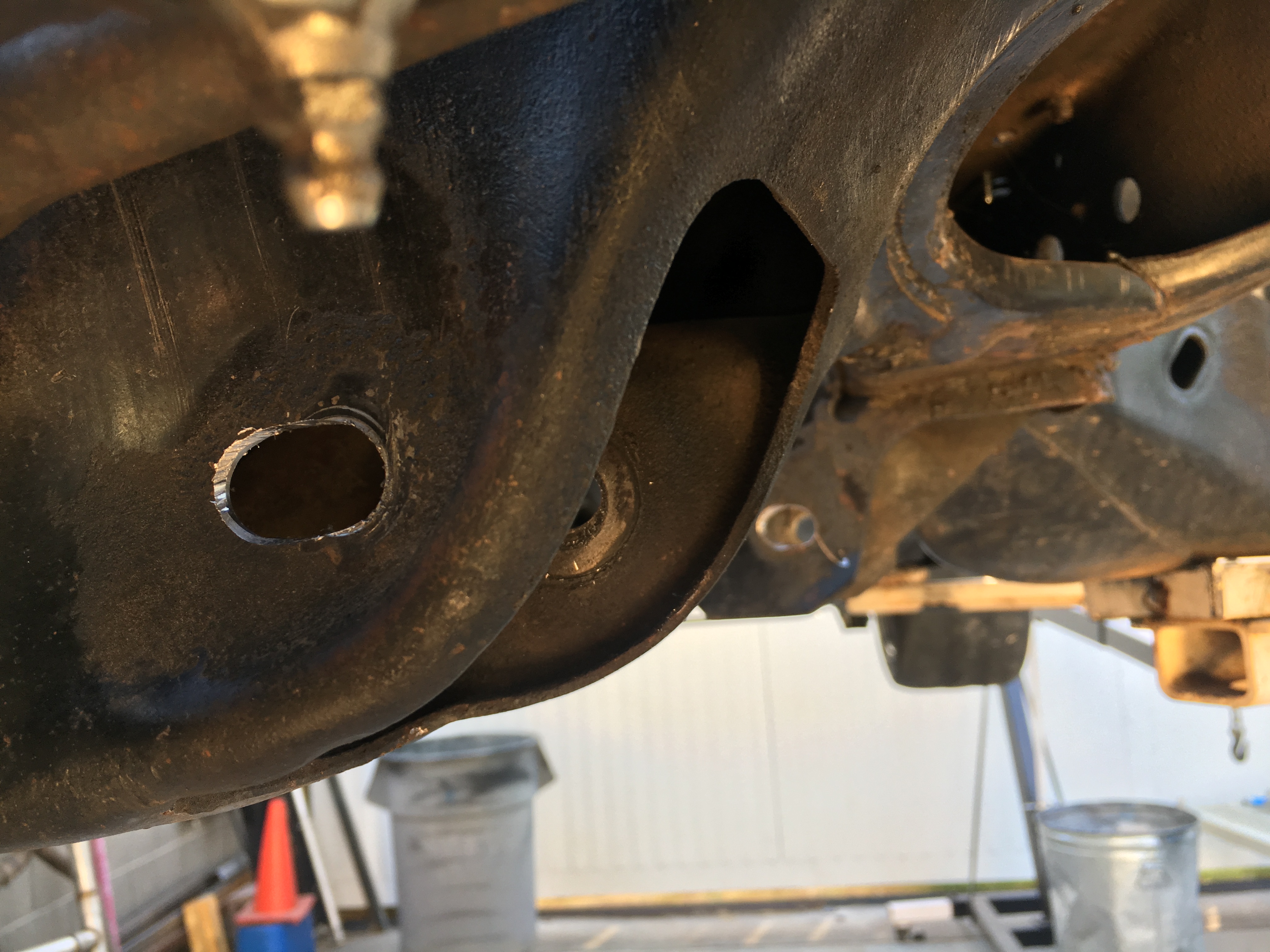

Spent some time with a drill and carbide grinder to optimize the front end geometry. Moving the LCA mounting holes so they line up and move the ball joints forward to gain caster. That coupled with the spc adjustable uppers should put me about 10 degrees of caster and 1-2 degrees of camber
What are you going to fill the ovals with?
why?
Spent some time with a drill and carbide grinder to optimize the front end geometry. Moving the LCA mounting holes so they line up and move the ball joints forward to gain caster. That coupled with the spc adjustable uppers should put me about 10 degrees of caster and 1-2 degrees of camberView attachment 116746
Nice.
