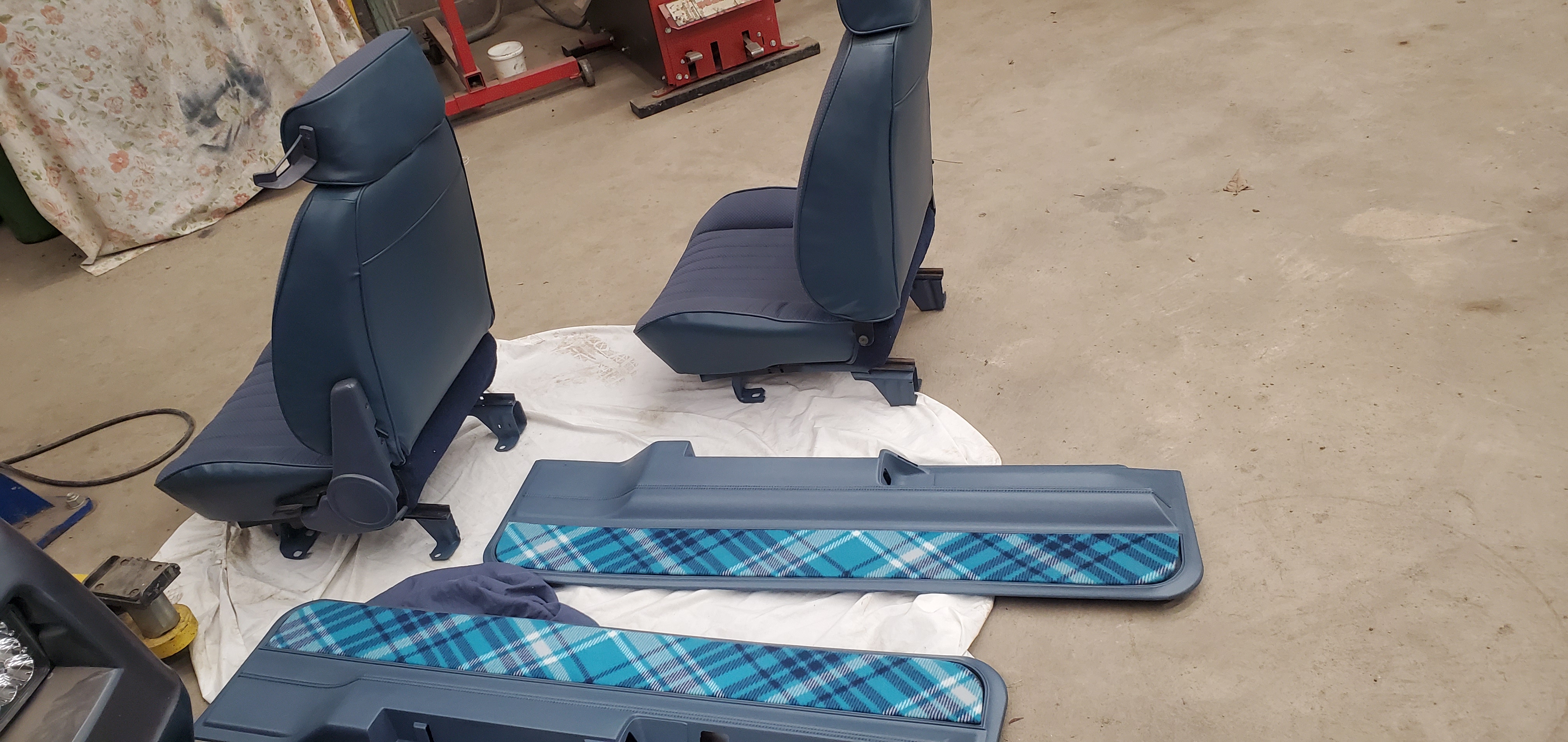

Finished door panels and put the dash back together. Also installed new carpet. Ok took more than one day.

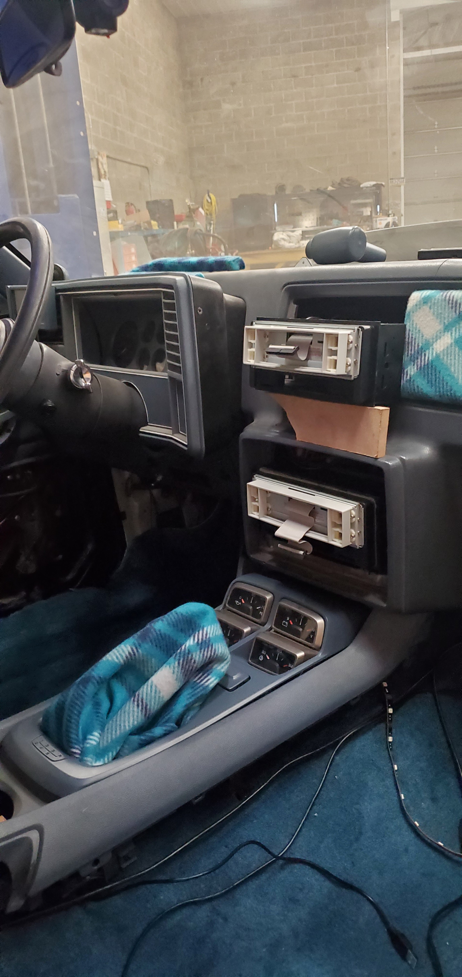

Makes me jealous it was "more than one day", my quick interior and stereo tear down ending up being close to a year now. But hopefully got the last of it done by getting my door panels finally bonded together and the stereo very close to completed with the wires in all the right places. Just have to wire maintenance them and "then she should all be back together", which is what I have been saying for close to a year now but hopefully true this time.

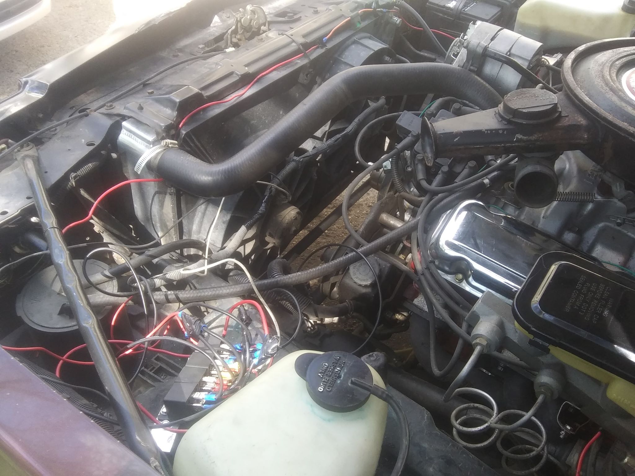

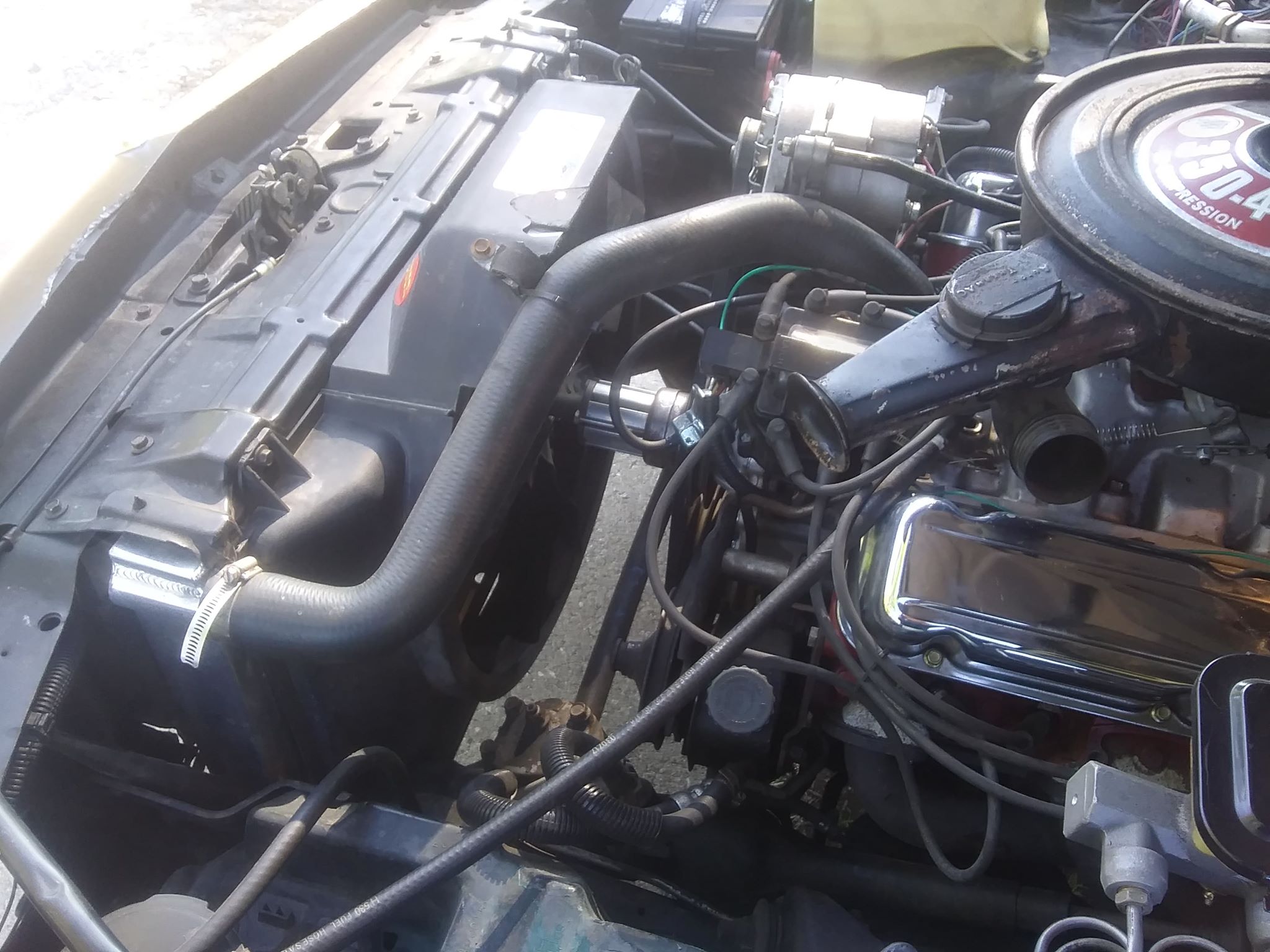

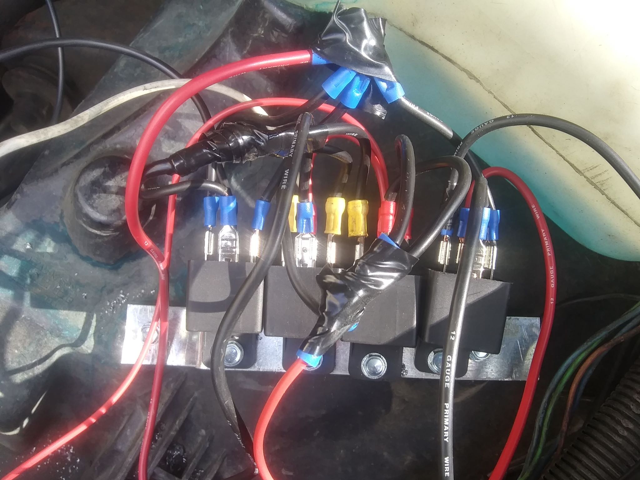

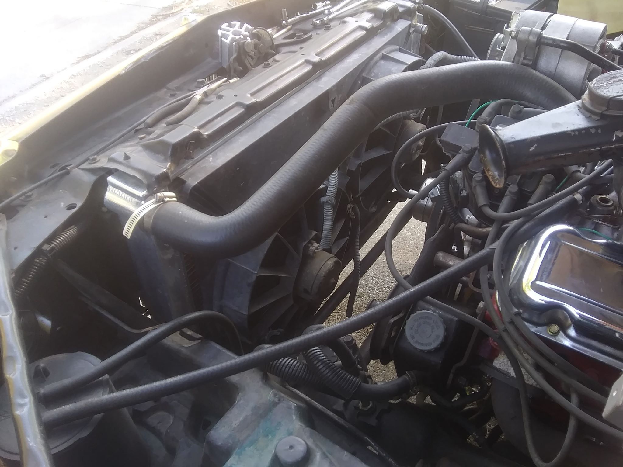

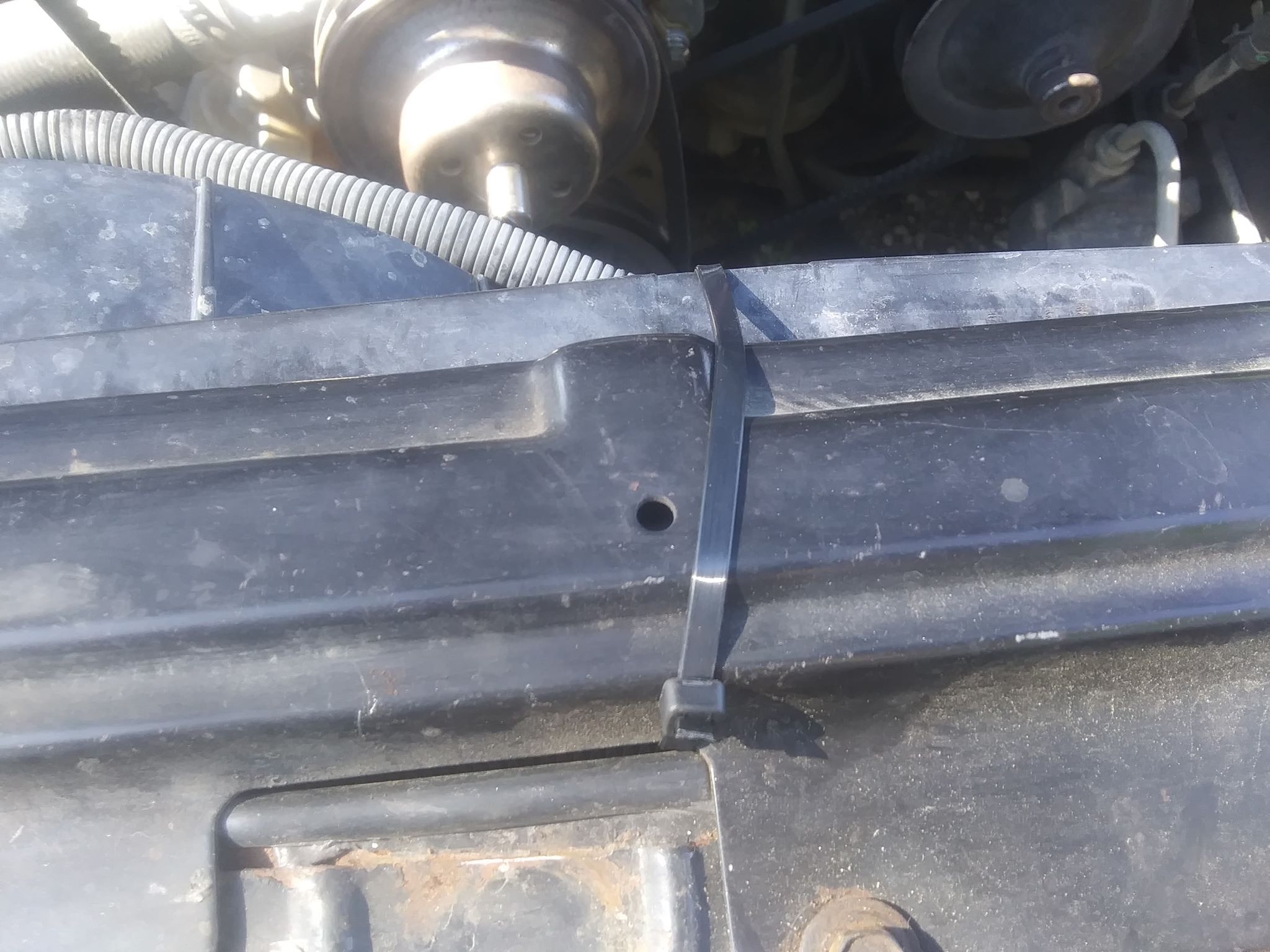

4th gen F body electric fans are in. Fit well, used a ziptie to hold it in for now lol. Wiring is messy, but it works. Yes, I did have to use small machine screws and eyelets to connect a lot of it. If I were to do it again, I would buy the controller. Took me about 5 hours, I don't wire. I don't like doing it. I don't like thinking about doing it, but I like the results every time. Low speed is all for now, and that seems to be enough. enough to suck cardboard to the rad so thats on par with the 7 blade. High will be activated when I get a temp switch that turns on at 195/200.
I've cleaned up the wiring a bit after I confirmed it worked. They're quiet. I keep checking to see if they're on lol.
View attachment 145468View attachment 145469View attachment 145471View attachment 145472View attachment 145473

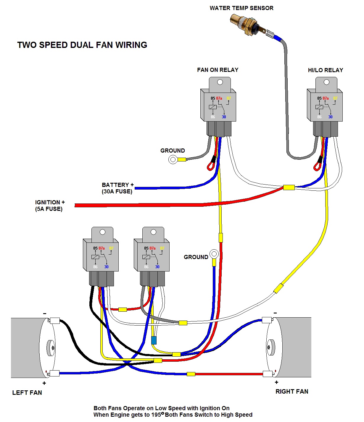

I'd peronnally would get some realy bases/plugs to get rid of all those crimp ends to endure nothing come off at the worst time. Then try to get some other colors to ensure future trouble shooting. Invest in some shrink tubes to better cover those splices. To be honest if I lived near you I'd be over to redo that to make it cleaner but I'm anal about my wire work.
I was looking at that mess too. Color codes are used for a reason. As far as I was able to interpret between those drawings, I did not see anything wrong, but I did notice an unneeded redundancy, no biggie.
