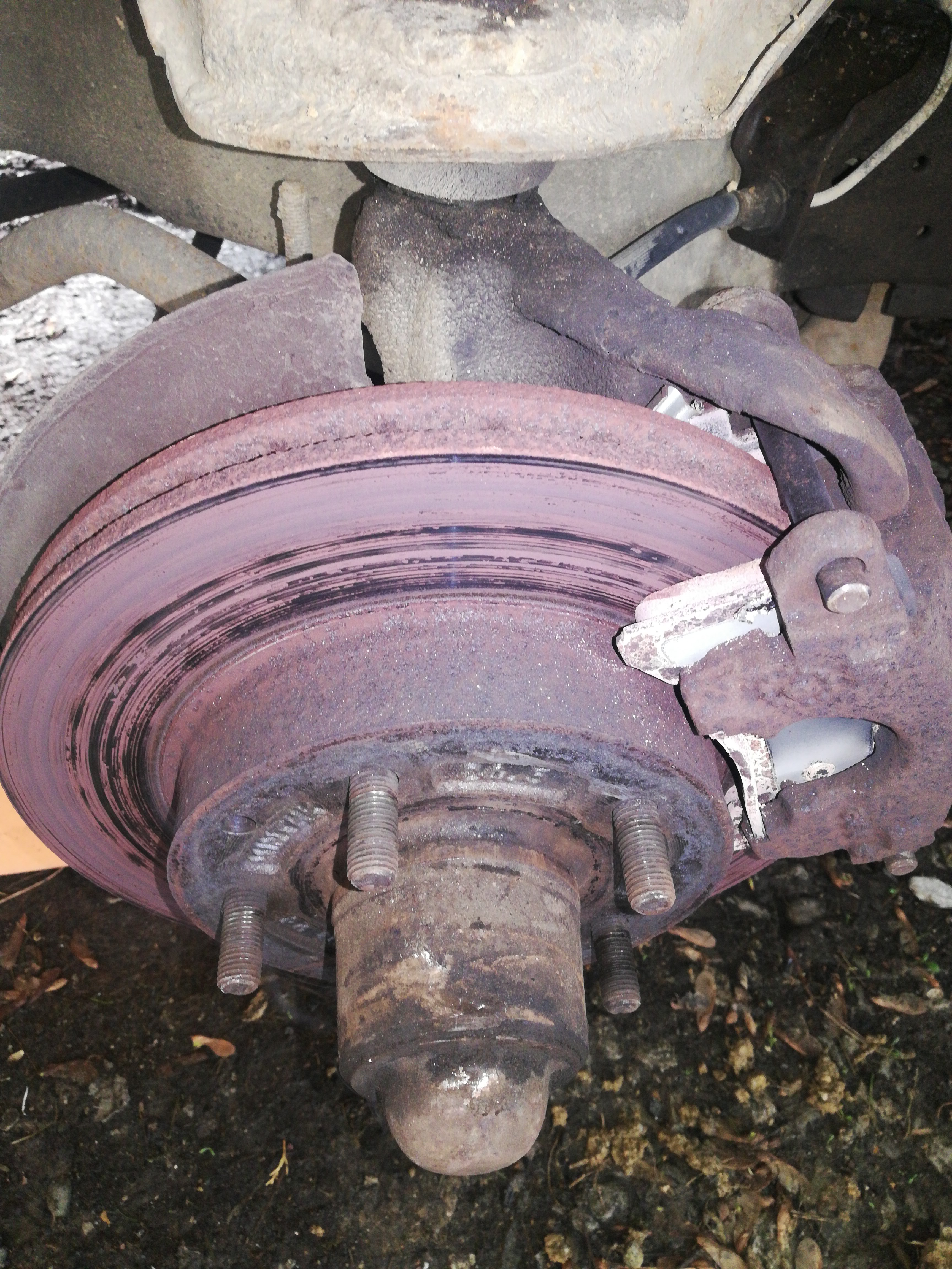

I replaced the passenger side brake hose and stole another caliper off of the El Camino as it was still sticking. I got everything together and bled, and the passenger side worked well. Unfortunately the drivers side decided to stick hard on the test drive.
The brake pad in the picture started out as black, and when I took the tire off the lugnuts were smoking.
Guess the El Camino is going to be giving up the other front caliper as well.
Dude, you know exposed slider pins never end well....
Everything seemed good with the way it was set up. I ended up buying a new caliper, and it was set up the same way. Still dragging a little bit though. I may say screw it and let a shop handle it, as the fluid is nasty as hell and I likely need to replace both rotors and pads again to get things right. I am pretty much just over this project.
