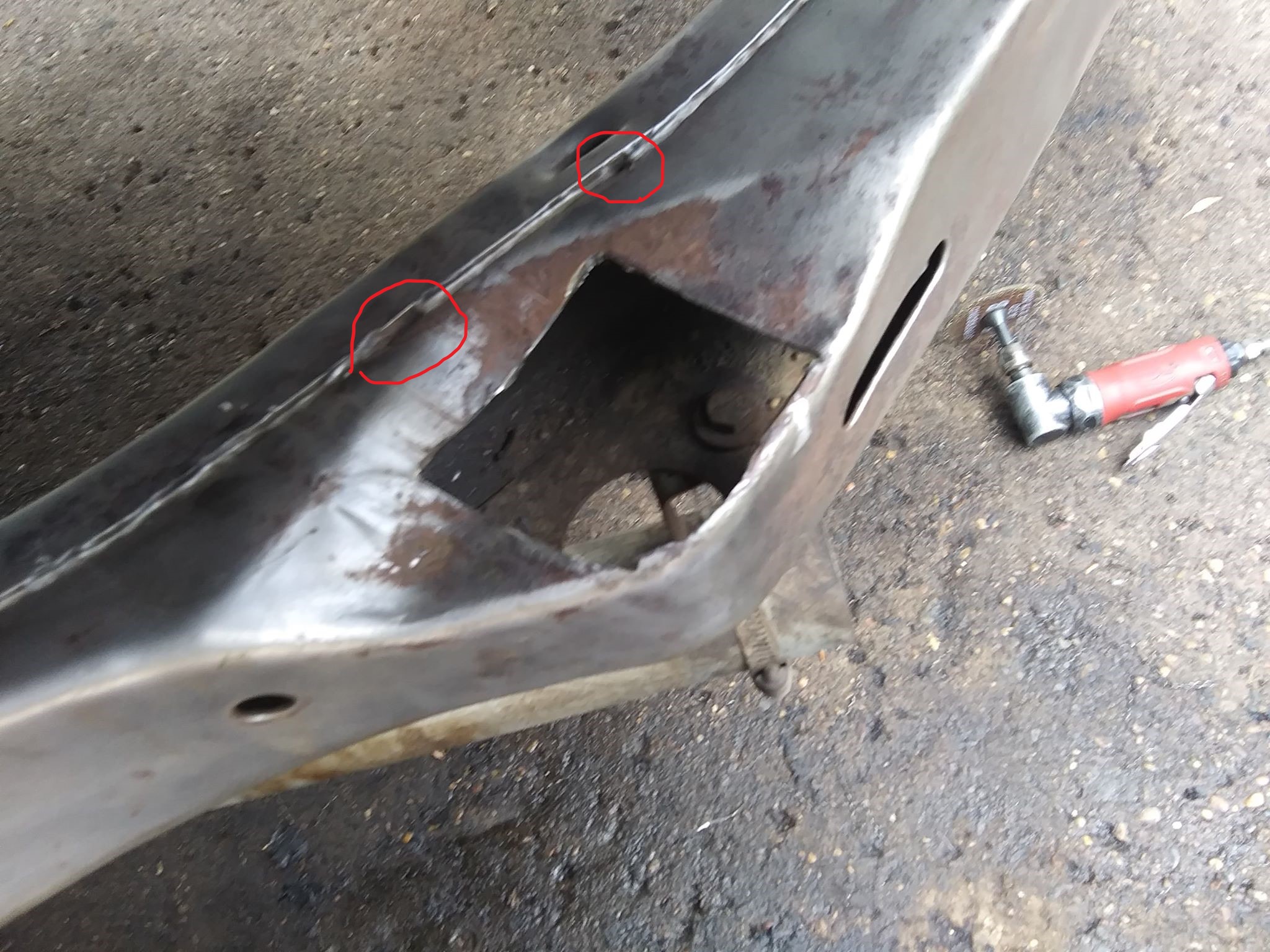

Nice patch but now I am curious about how you plan to re-install the body mount bolt once you start to re-assemble your project cause I am thinking that your hole used to be about where one of the body rubber biscuits used to be????
Once I get the rest of the frame done, i'll lower the body down, do up a few mounts to ensure it's square, then set a mount there, trace around it, and use a hole saw. it'll be one of the last things I do.
$20 says I forget.
when I did my patches I cleaned up the frame and laid the patch with the hole already cut on top of the frame. There was enough of the original hole to line it up. I was not worried about the thickness of 14 gauge metal affecting the body sitting on the frame.
and I added weld at spots on the frame that was missed at factory
Once more of the frame is cleaned up I fully intend to "fix" any factory welds I see. There is a sh*t ton of slag by the spring pocket on the driver's side rear as well. like the guy was practicing on my frame lol.
Yup. About what I ran into as well when it was time to mess with those holes. For most of them I was lucky enough to have enough of the original hole still there that I could clean up the nastiness and then build up the edges of the circle back to about the original shape and finish them out to being round. Lots of work but frame off wasn't an option so in situ had to be the way to go. As for shitty seams, under the fire wall body mounts on the bottom face of the frame where the curve out from the front clip mates to the side rails is also a miserable site. Had to visit the driver's side and will do the same for the passengers when I cut away the rocker panel on that side and replace it.
