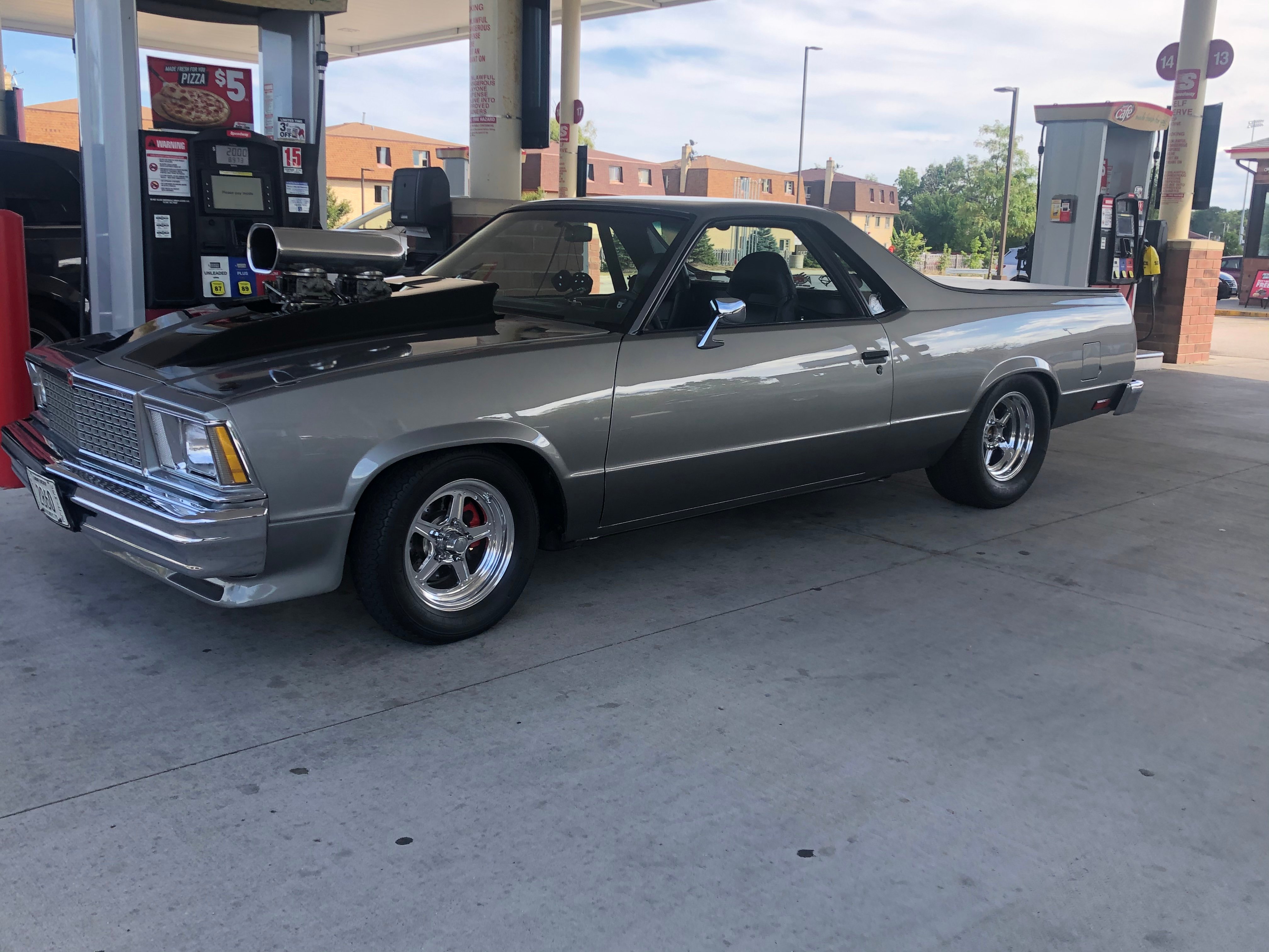

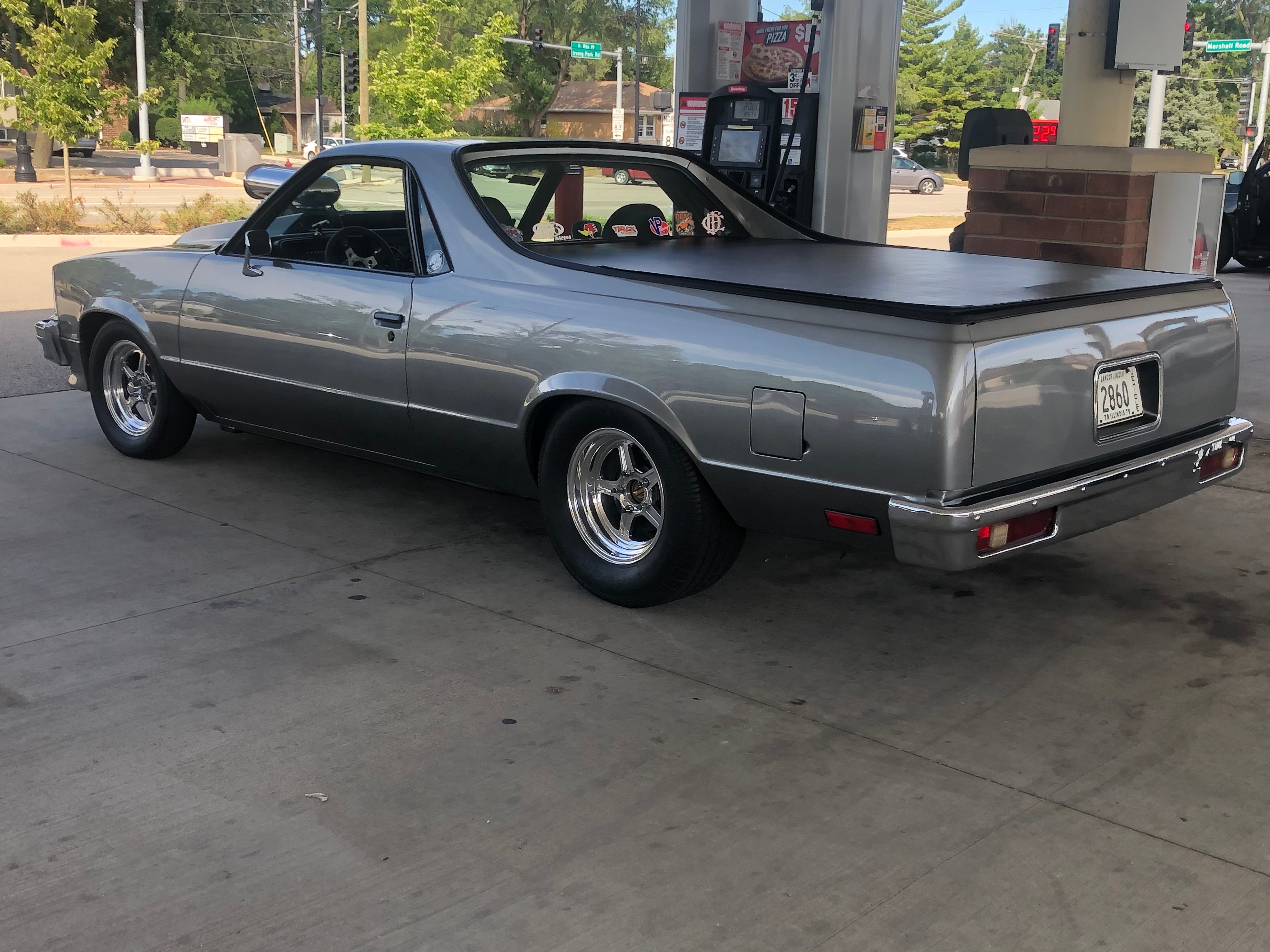

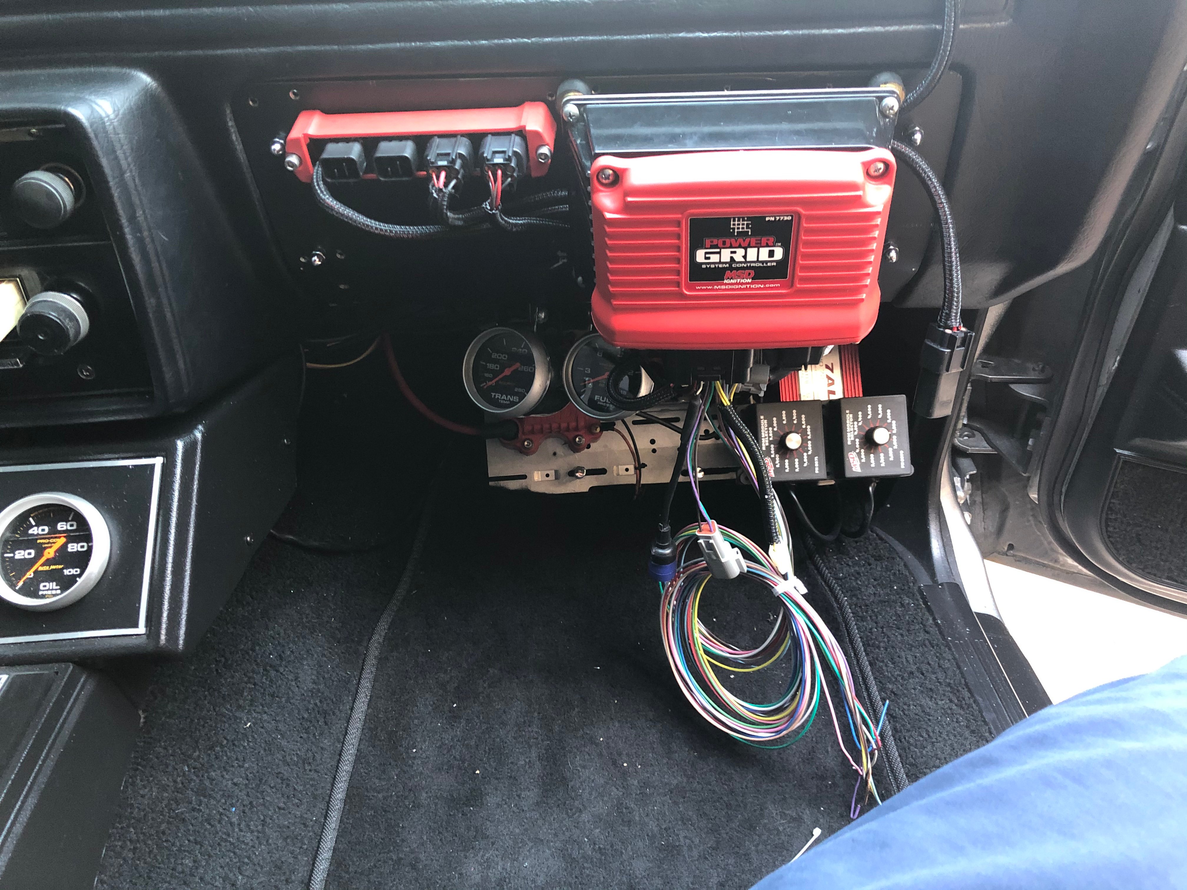

MSD grid was taking up space in the tool box so I decided to use it on the elco made an aluminum glove box door to hold the ignition, looked like swiss cheese but all the holes that weren't used were filled, I also change the look of the car and installed new wheels.. and finally got to take it out for the second time this year
(knee surgery]View attachment 156332View attachment 156337View attachment 156338View attachment 156339View attachment 156340
looking up the power grid it looks like it's the black box for drag racers.... :popcorn:
