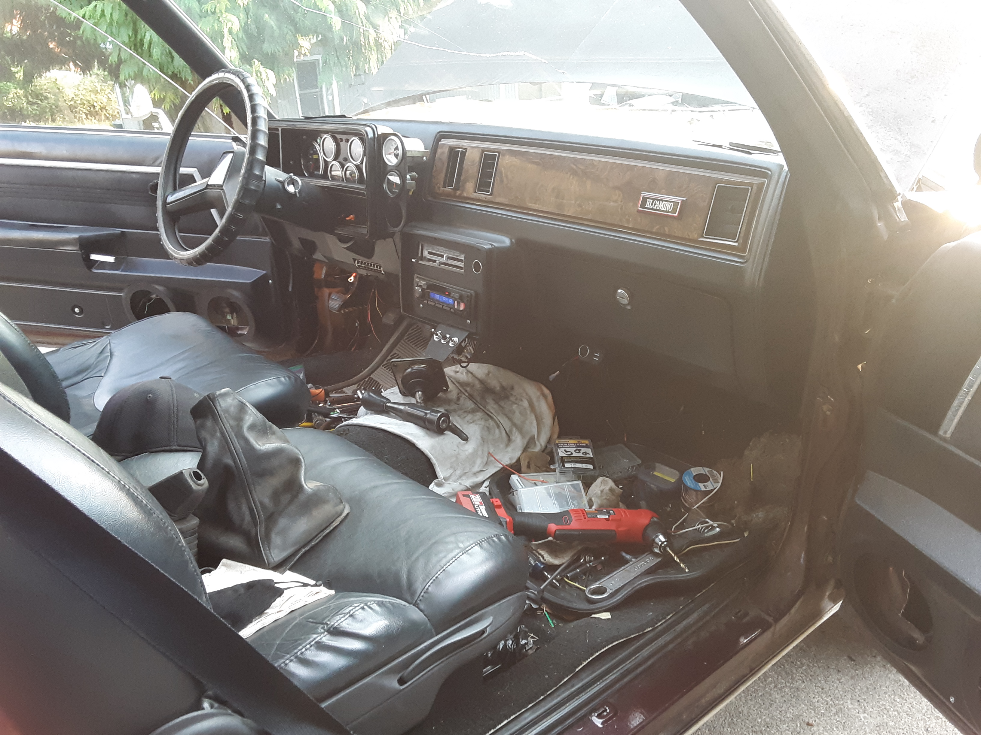

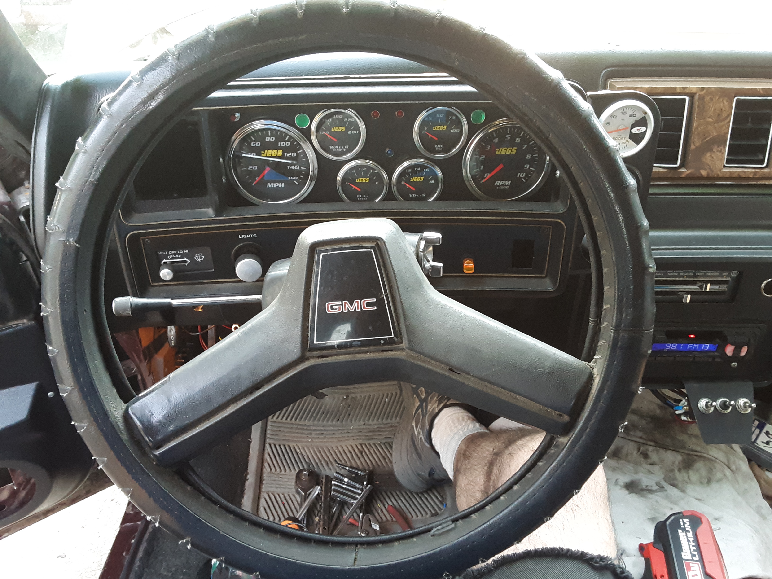

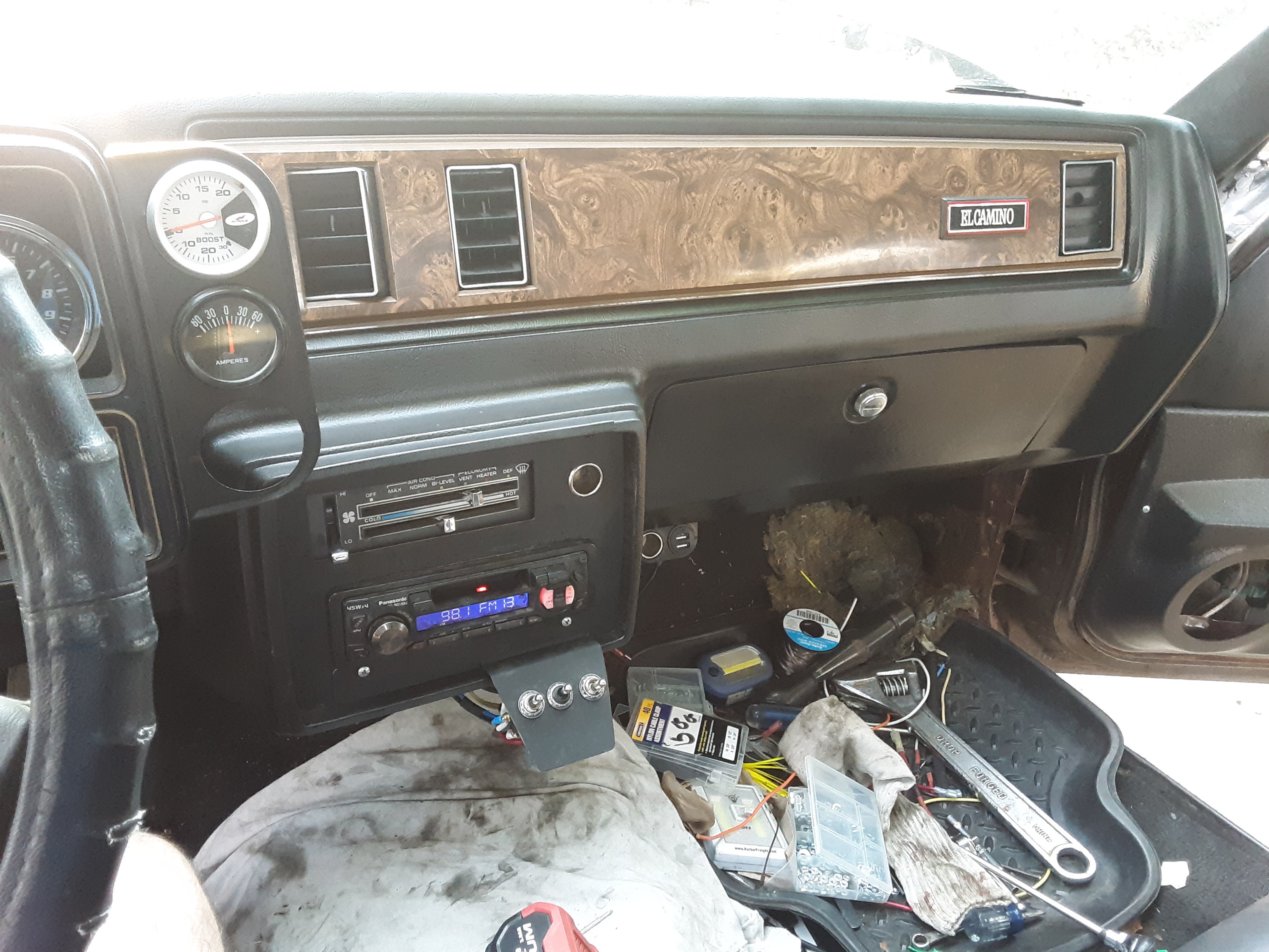

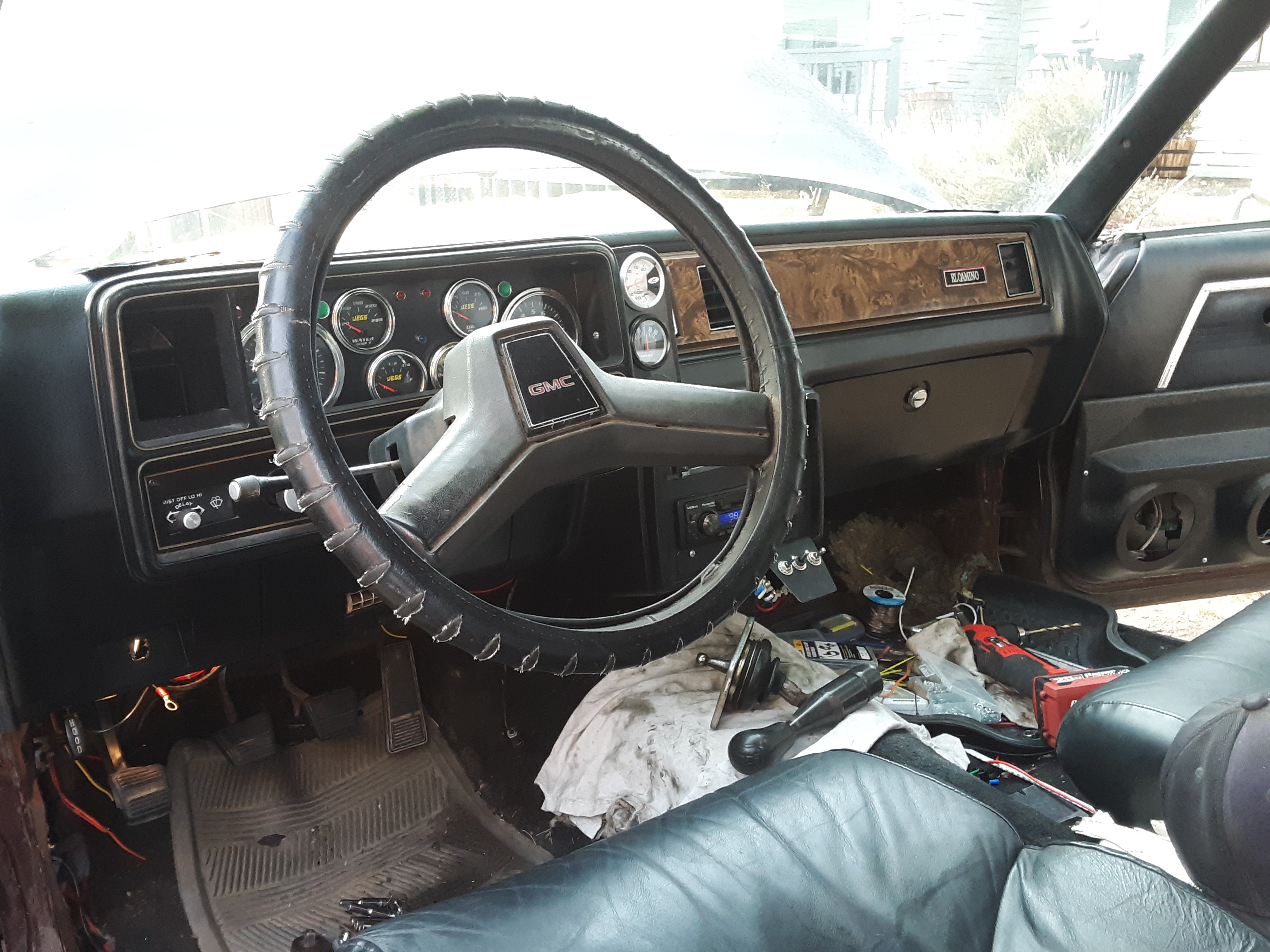

Got all of the under dash connections completed, a junction block for the power window and door locks, stereo reinstalled, glovebox reinstalled, and under column panel installed. I tested a few accessories along the way, but missed checking the AC/heater blower. It's not working, so I will have to check that out. I also was able to start the car, and found that the mini starter I installed earlier is dragging a little bit, it will need a shim. The oil pressure is reading almost 40# at idle, but the warning light that I installed doesn't go out, so I will need to look into that also. Mostly, I am very happy, and am excited to be driving it again soon.
Here are two driver's eye pics of the dash.
Two more "big picture" pics.
I showed pics of the dash when I painted it, but when I went to install the under column panel, and the glovebox which were already black, I realized how dirty and faded they looked, so I painted them also.
Next, I need to put the gear shift handle back in place, and take care of the starter, oil warning light, heater fan, and I had forgotten to mention that the delay wiper switch was missing it's dark green wire, so I soldered one on and it is currently wrapped up waiting to be pushed through the firewall to the wiper motor.
