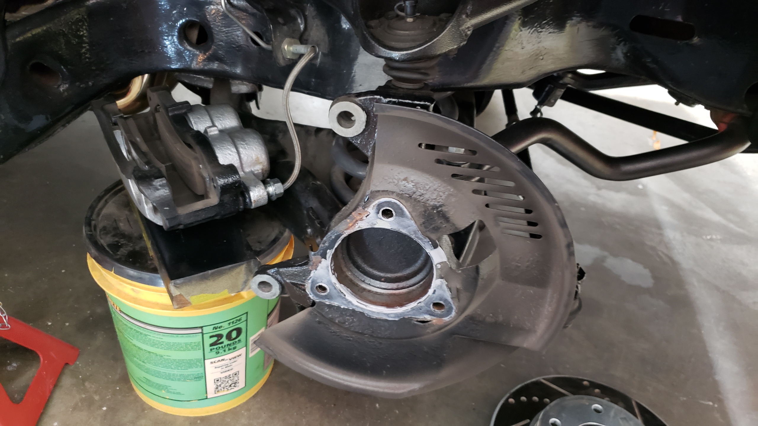

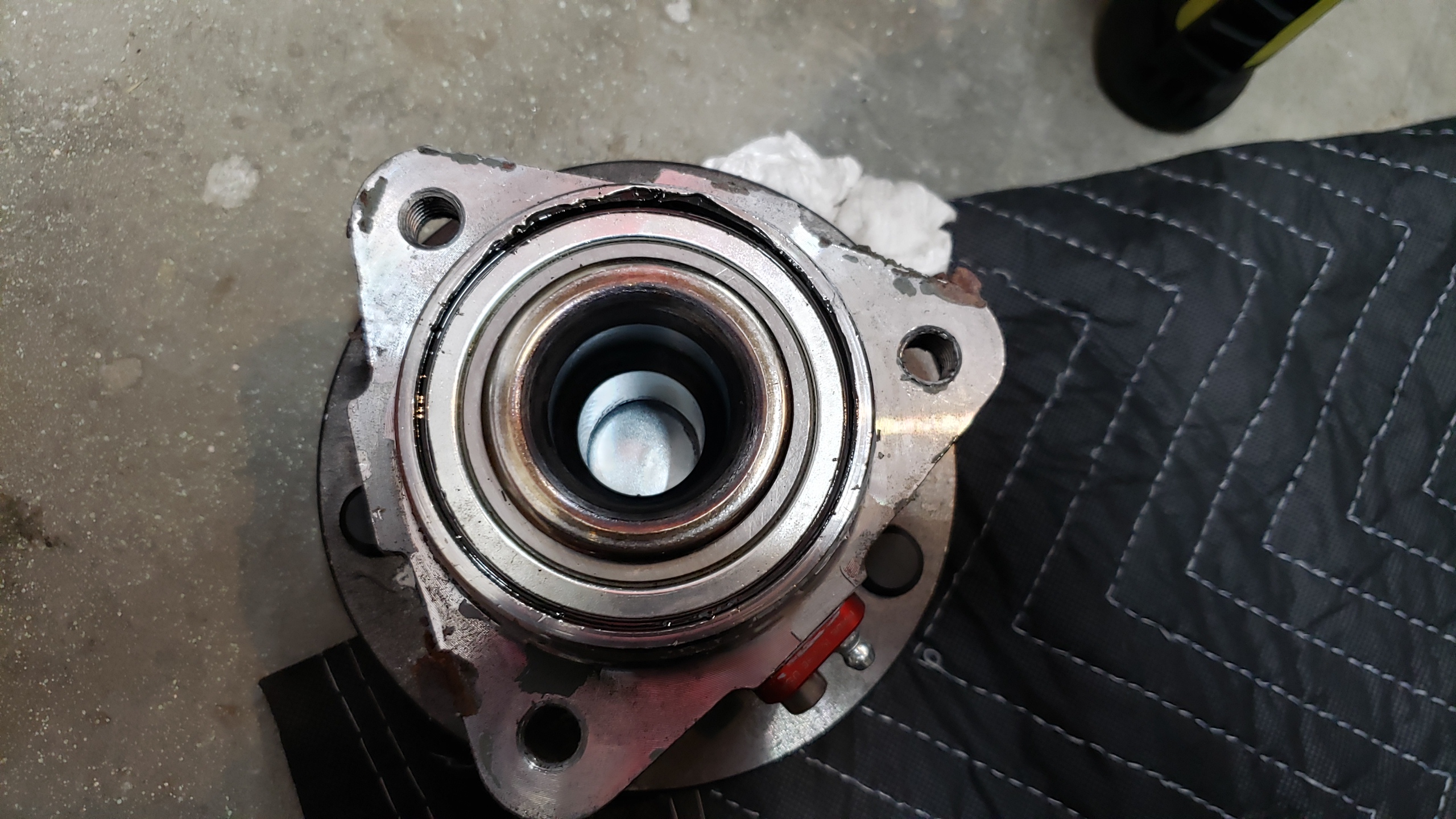

.....my hunch was right. I was thinking the hubs were the issue. The rotors were spinning freely, but I could hear some noise in the hubs, so I pulled the caliper and rotor and sure enough it had some crunchy noises 😡!!! Gotta love china's finest hubs, they don't spin easily after only 200ish miles, and already have grease exiting the inside! I'm open for recommendations on good hubs, need them by midweek since there is a show next Saturday I wanna go to.
.....my hunch was right. I was thinking the hubs were the issue. The rotors were spinning freely, but I could hear some noise in the hubs, so I pulled the caliper and rotor and sure enough it had some crunchy noises 😡!!! Gotta love china's finest hubs, they don't spin easily after only 200ish miles, and already have grease exiting the inside! I'm open for recommendations on good hubs, need them by midweek since there is a show next Saturday I wanna go to.View attachment 157691View attachment 157692
So far the parts stores have their house brand hubs with the same #513200. AZ are from Chyna, so likely the same for other stores. However, I did find online that Timken makes alot of the house brand hubs and it's a toss up if a Timken is US or not.
Timken for the win!
