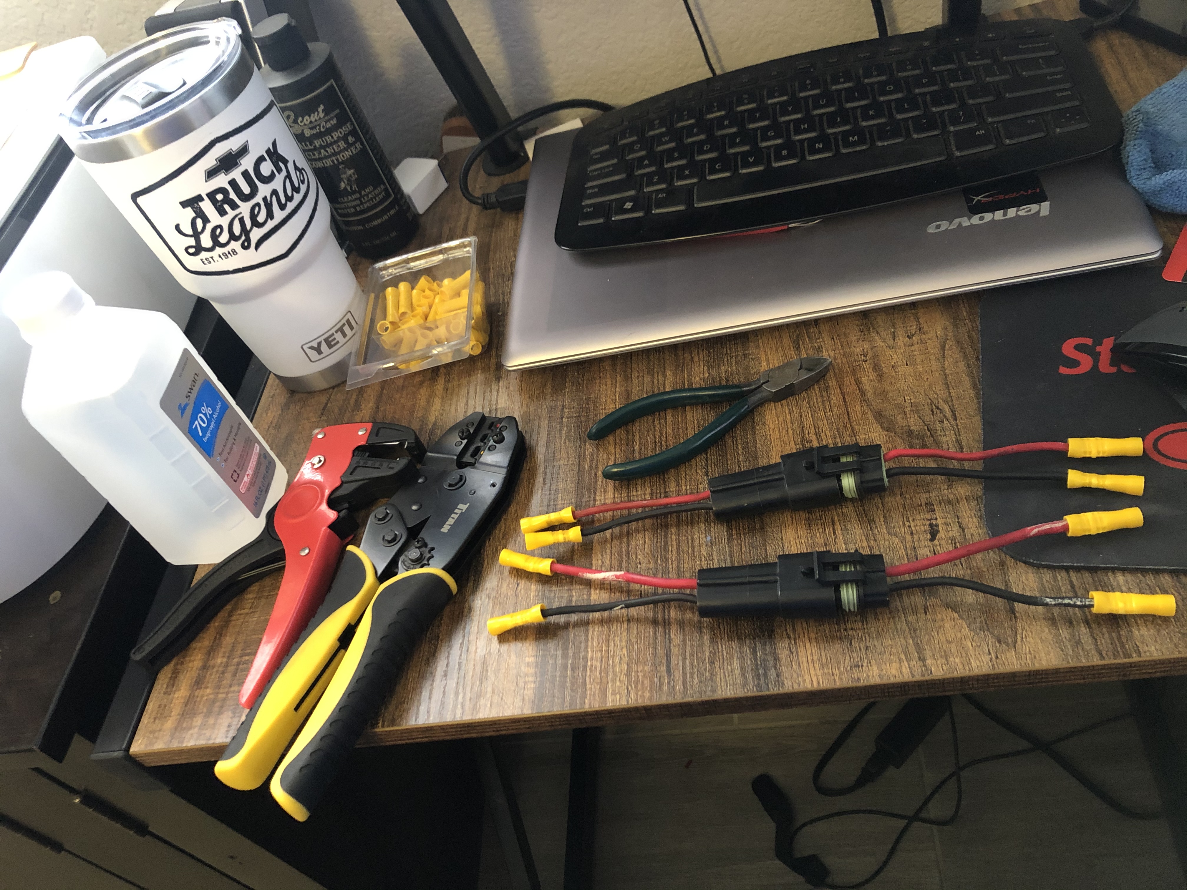

Cut down and crimped butt connectors to some connectors I found a while back. I installed the heavy duty relay harness for my power windows and need a break in the power and ground wires that go to the battery. There are one of each for each side so I grabbed two of these connectors from an 80s Cadillac engine bay and they’re the perfect size and gauge wiring. I’ll put one on each side behind the dash so I can easily unplug if I need to pull the doors.

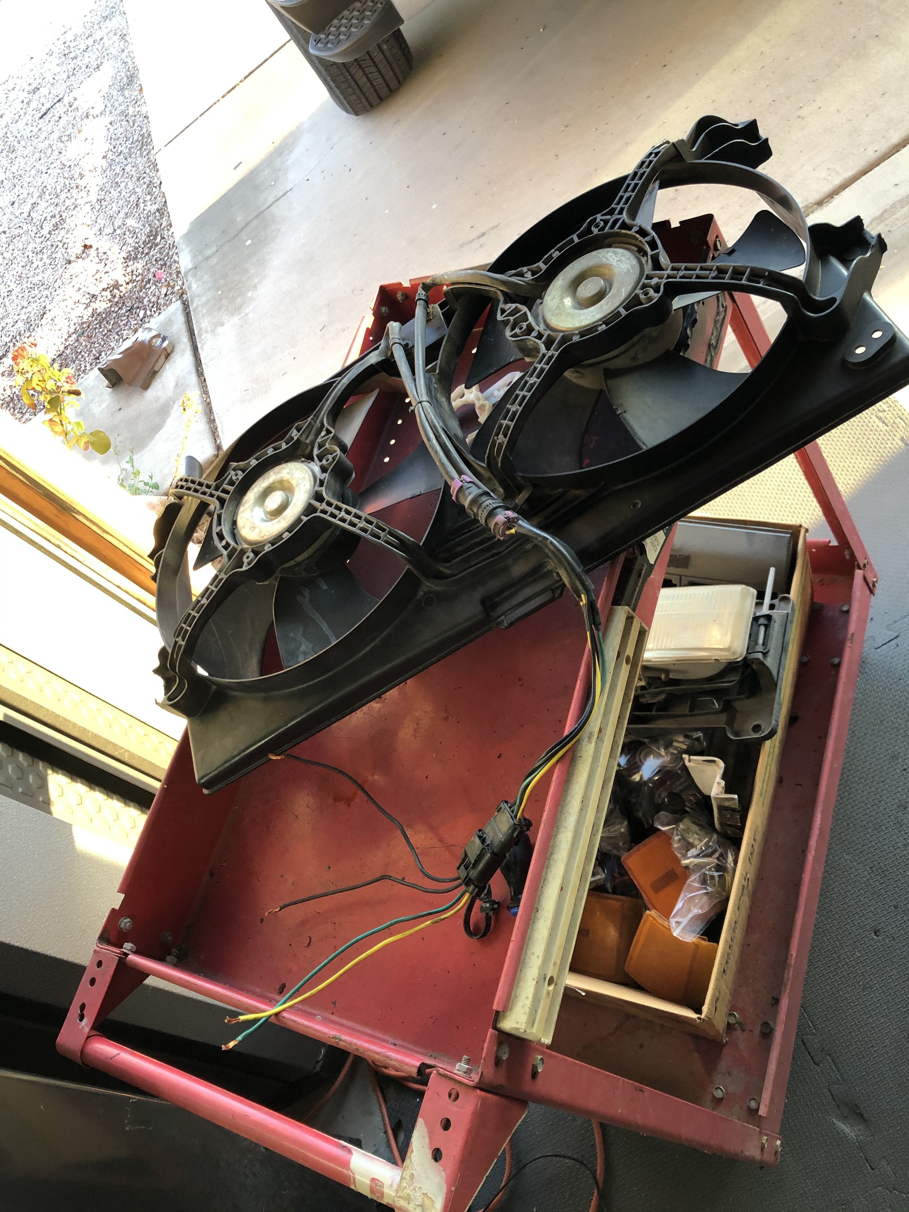

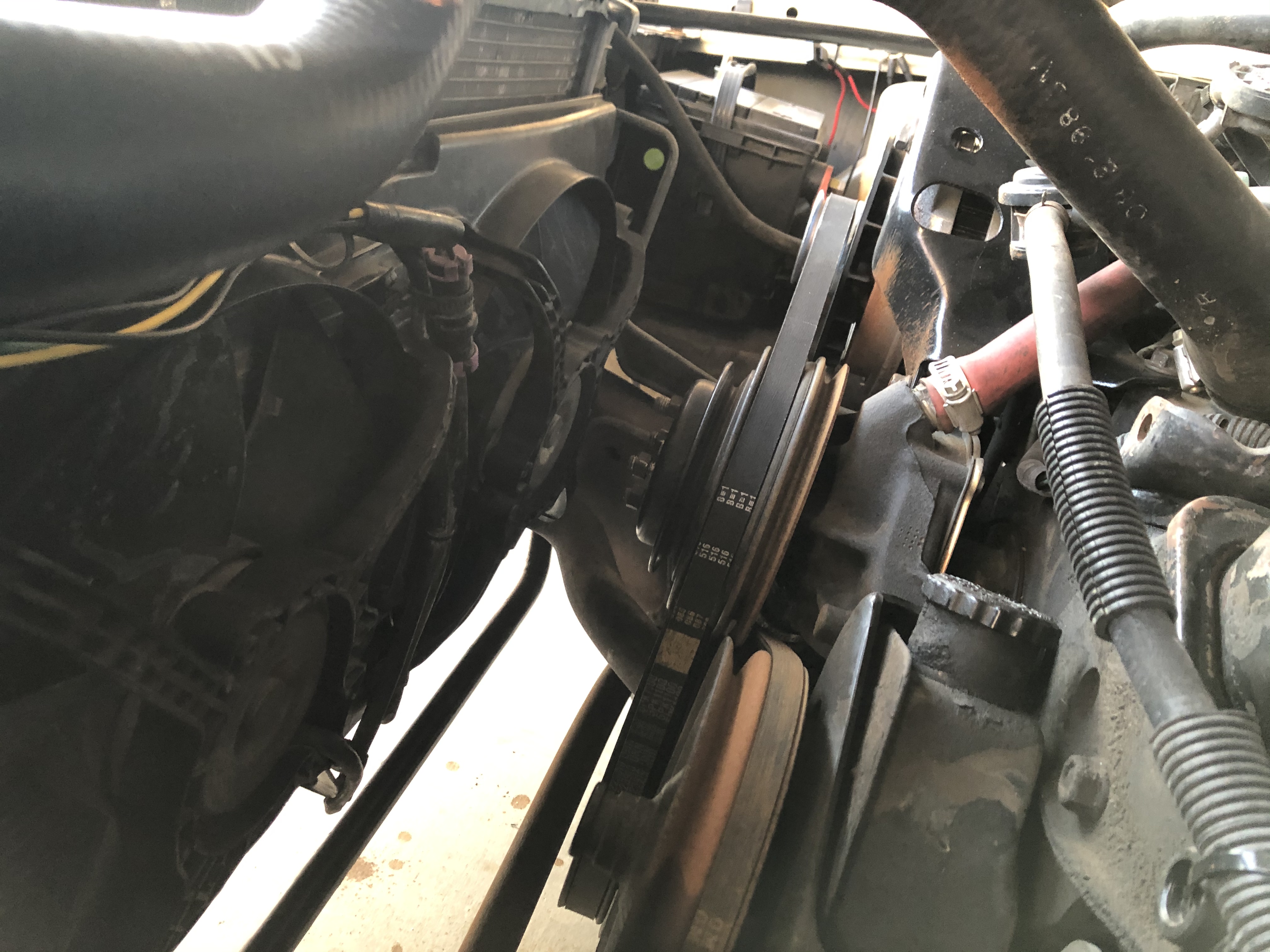

I then started test fitting my electric fan setup. These fans are from a Chrysler 300M. I’ll need to make up a bracket for it to mount to the top plate. Cut off the side ears and it fit good other than being short. Any suggestions on how to mount securely are surely welcome.

I just made some simple brackets out of flat aluminum or steel. I have 4 total (2 holding the fans to the top plate, 2 on bottom at core support.) If need be I'll get pics, just let me know.
Use the KISS principle.
