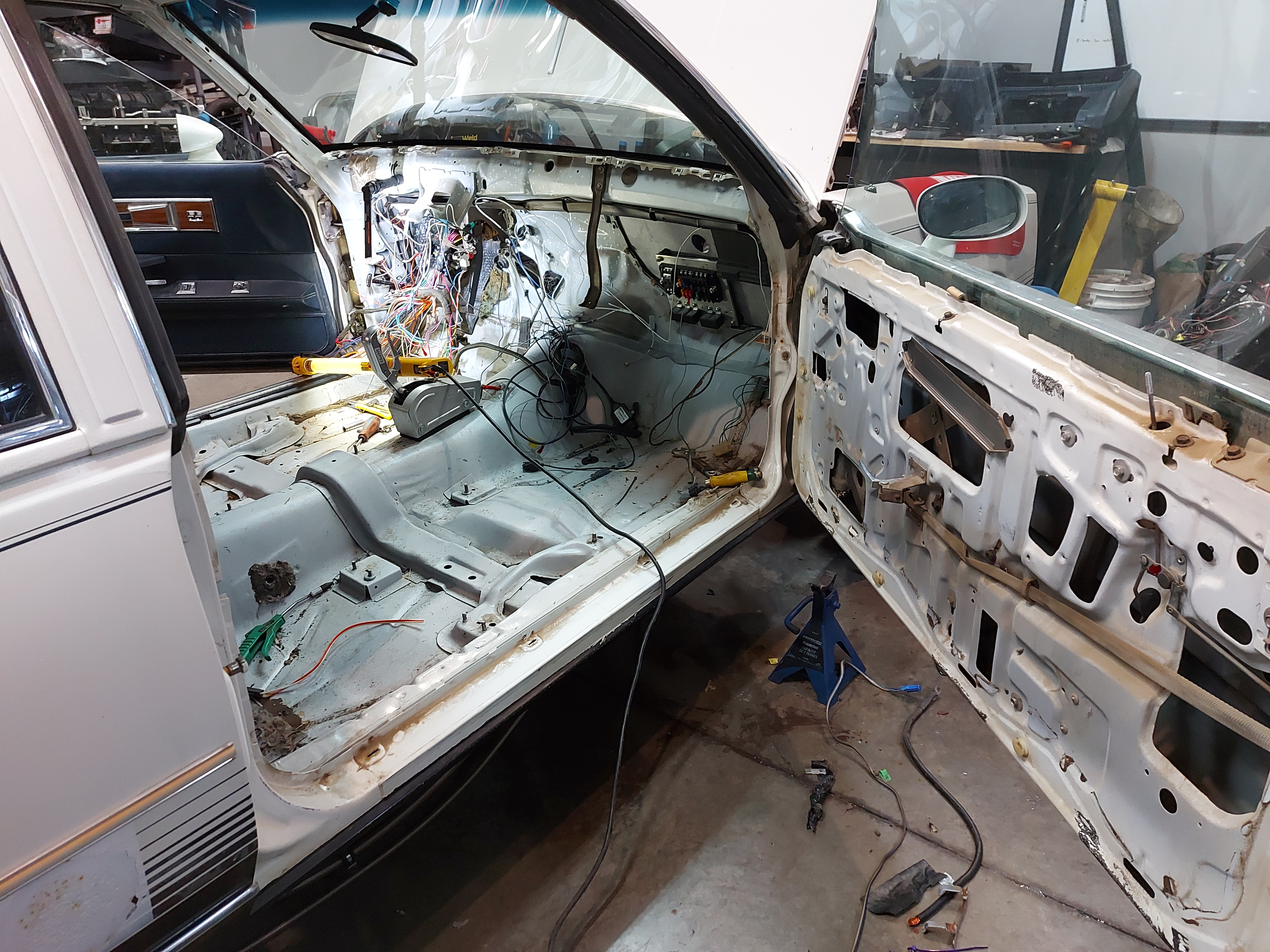

This have escalated in the weight reduction department.
I started my front wheel well/tub replacement fabrication. Made initial cuts on a spare Malibu fender for trial & error purposes. I knew almost immediately I complicated the install by trimming higher than necessary (I laid out 3 possible cut lines & chose the middle of the three). This is why I do things as I do. I get a visual & better understanding of the needs....
Please post updates on this and your progress in detail and as often as possible please. I have the same modification slated for my Juggernaut Cutlass project soon and will be watching with great interest.
Thanks!
Got my rear-view mirror hung back up, if only for a little while.
