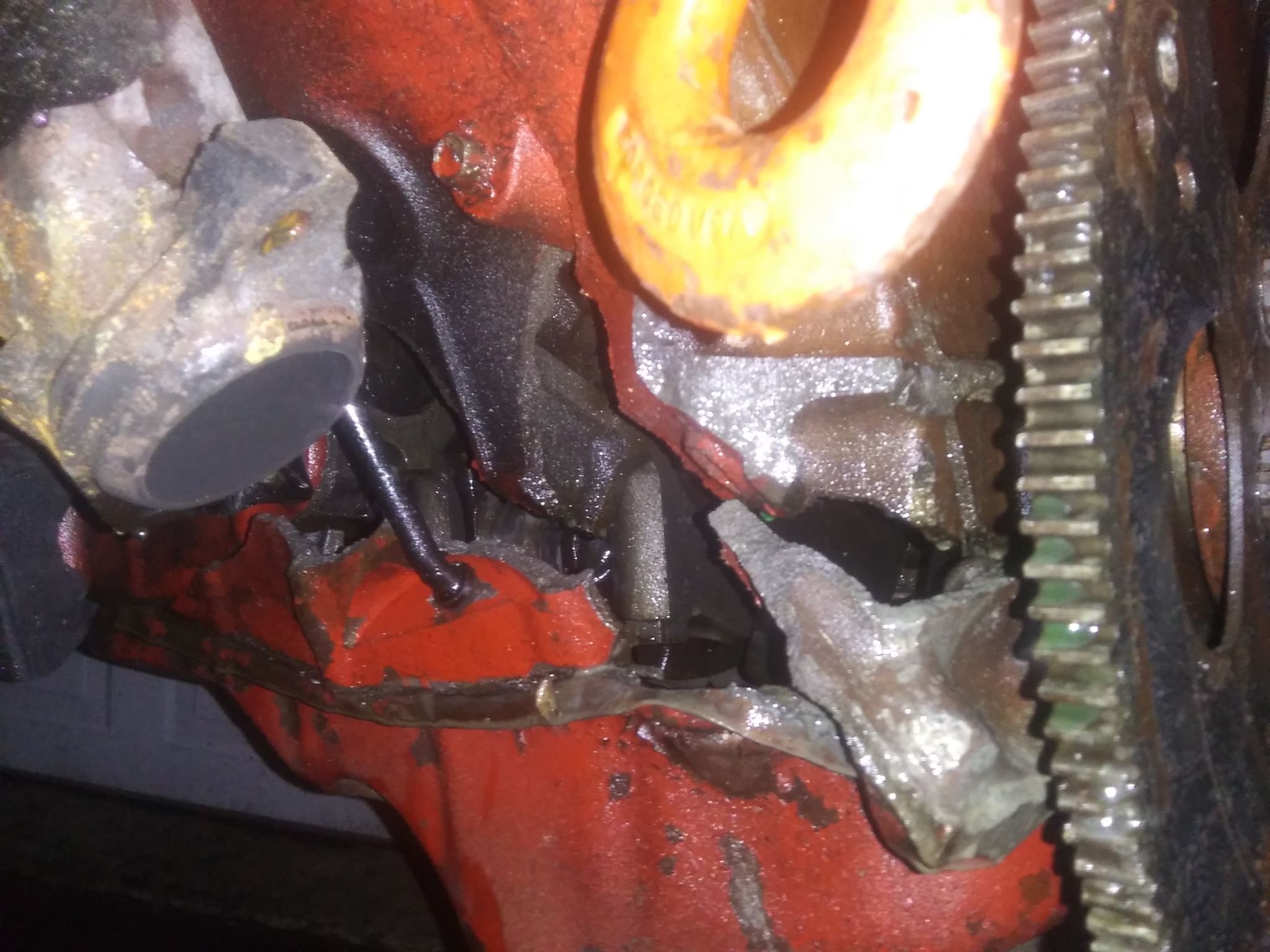

So, what broke first? How did the cam go out the back of the block?essploded motor is out
more pics of the carnage
found the half of the cam
and some rods

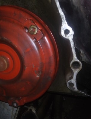

cam beat the hell outta the flexplate and dented the converter as well as sheared the bolts. $370 later, new converter, bolts, and fp on their way.
View attachment 138786 View attachment 138787 View attachment 138788 View attachment 138789
This thing was still running after this. it only died when i shut it off. i was only at like 200rpm, but it was running.
Assuming rod bolts failed, rod hit cam, broke cam, cam piece was pushed back (rear cam plug is gone, rear bearing mangled, plus the flexplate damage), flexplate hitting the cam piece was forced back into the engine contacting the other rods (there is at least 2 in the pan, shattered piston pieces as well) and it all went to hell from there.So, what broke first? How did the cam go out the back of the block?
