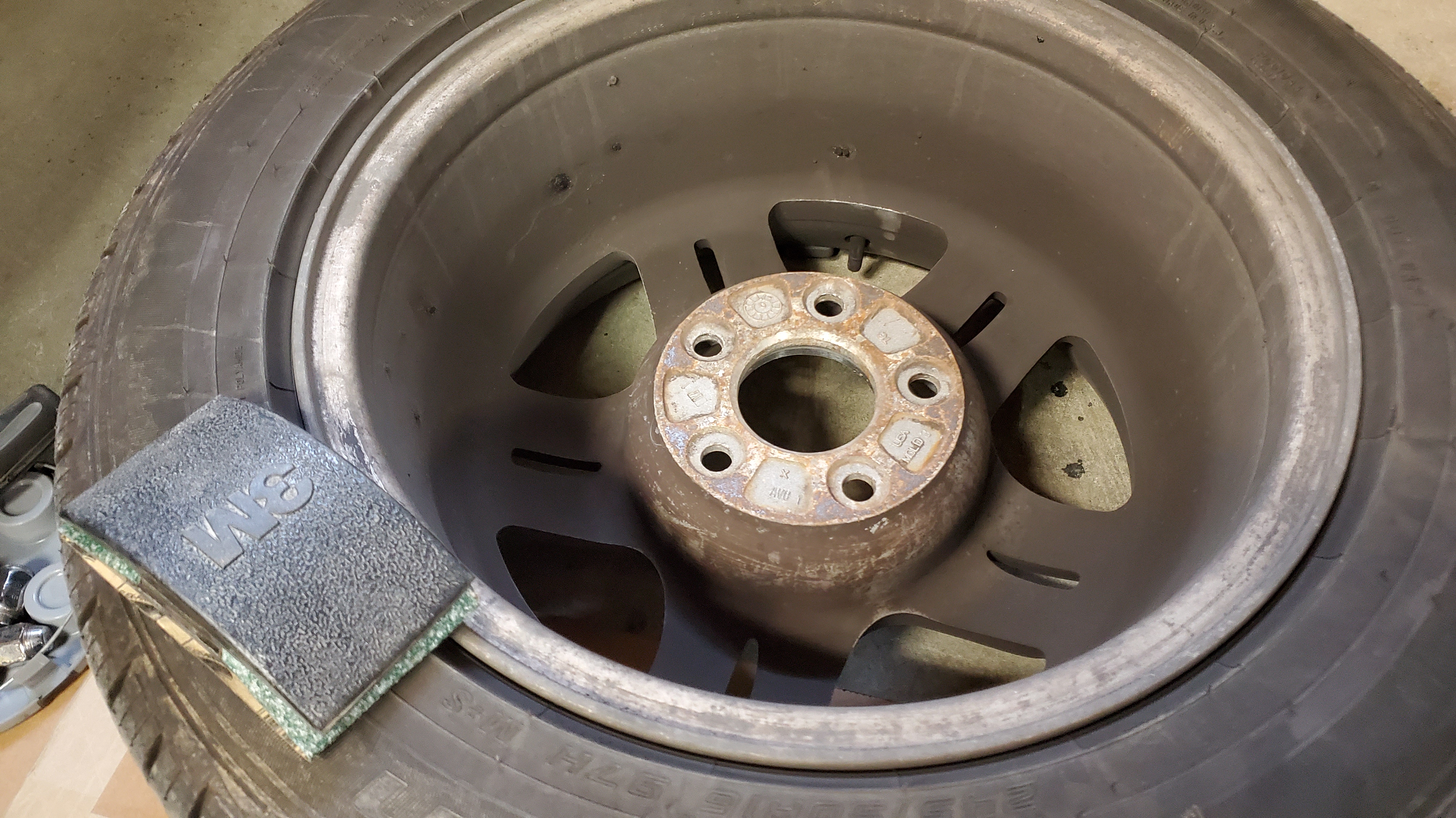

I hate self inflicted things and doing things twice. I rotated my tires yesterday during my pit road bodywork exapade, only to have a nasty vibration at highway speed. So, I took it apart, threw some 80 grit in the sanding block, and sanded the hubs flat. Donovan will be happy to know that the dust chute prevented fitment of the beltsander within the rim. Then, I wire brushed the hubs, retorqued the wheels, and sent it. We'll see on the commute tomorrow as I traverse Planet COVID19.
Pics for proof (1 wheel, anyway)
View attachment 139423View attachment 139424
I fixed it !!! :banana::banana::banana: Then, celebrated on the way to work by laying waste to an older Benz S420 that thought he had some shirt for the Pig. Bye-bye, sucka!
