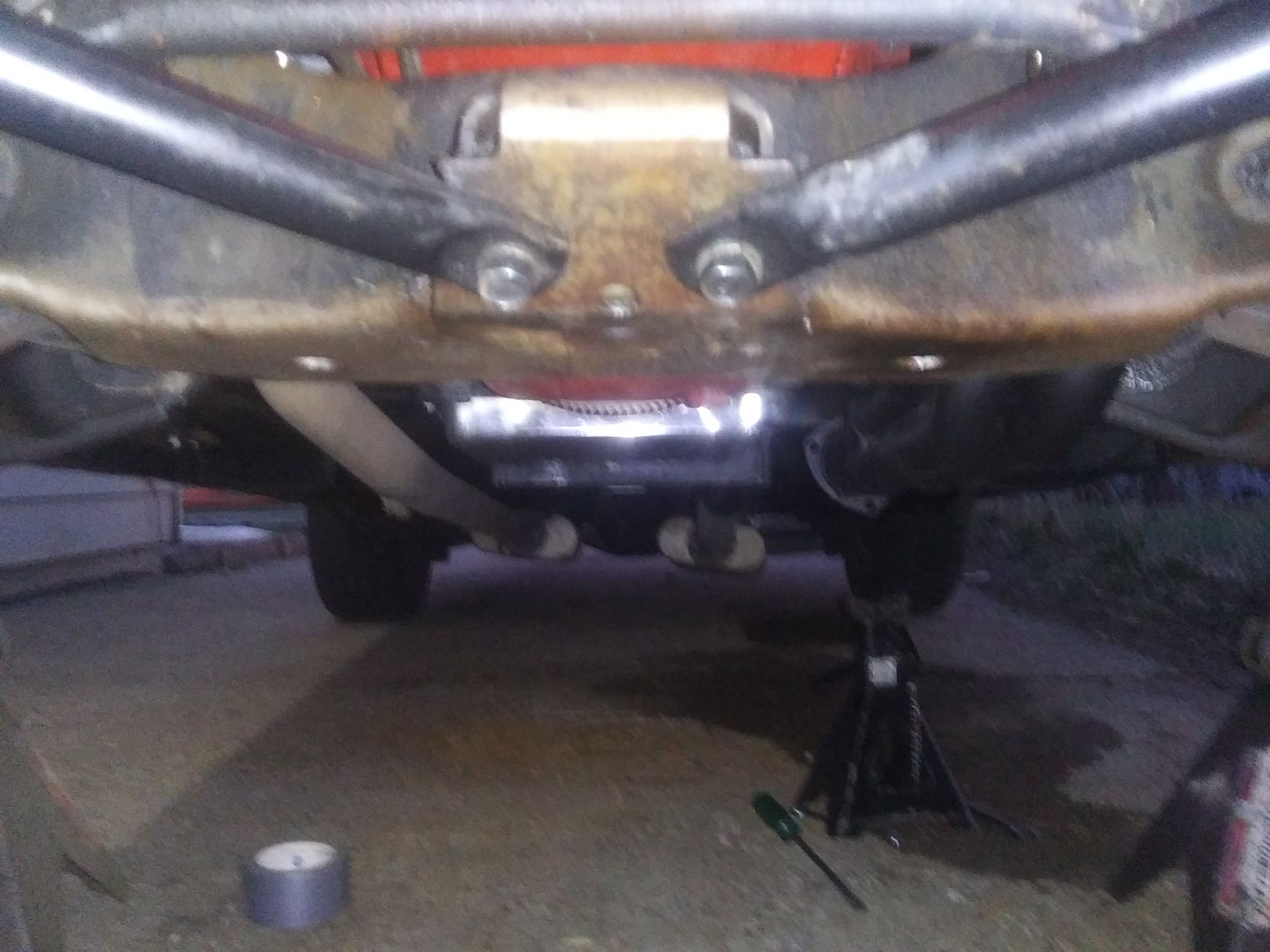

Drove it around town with a buddy. Did some donuts. Watched a very unqualified motorcyclist.
It's ****in loud.
sounds like a dirt car lol

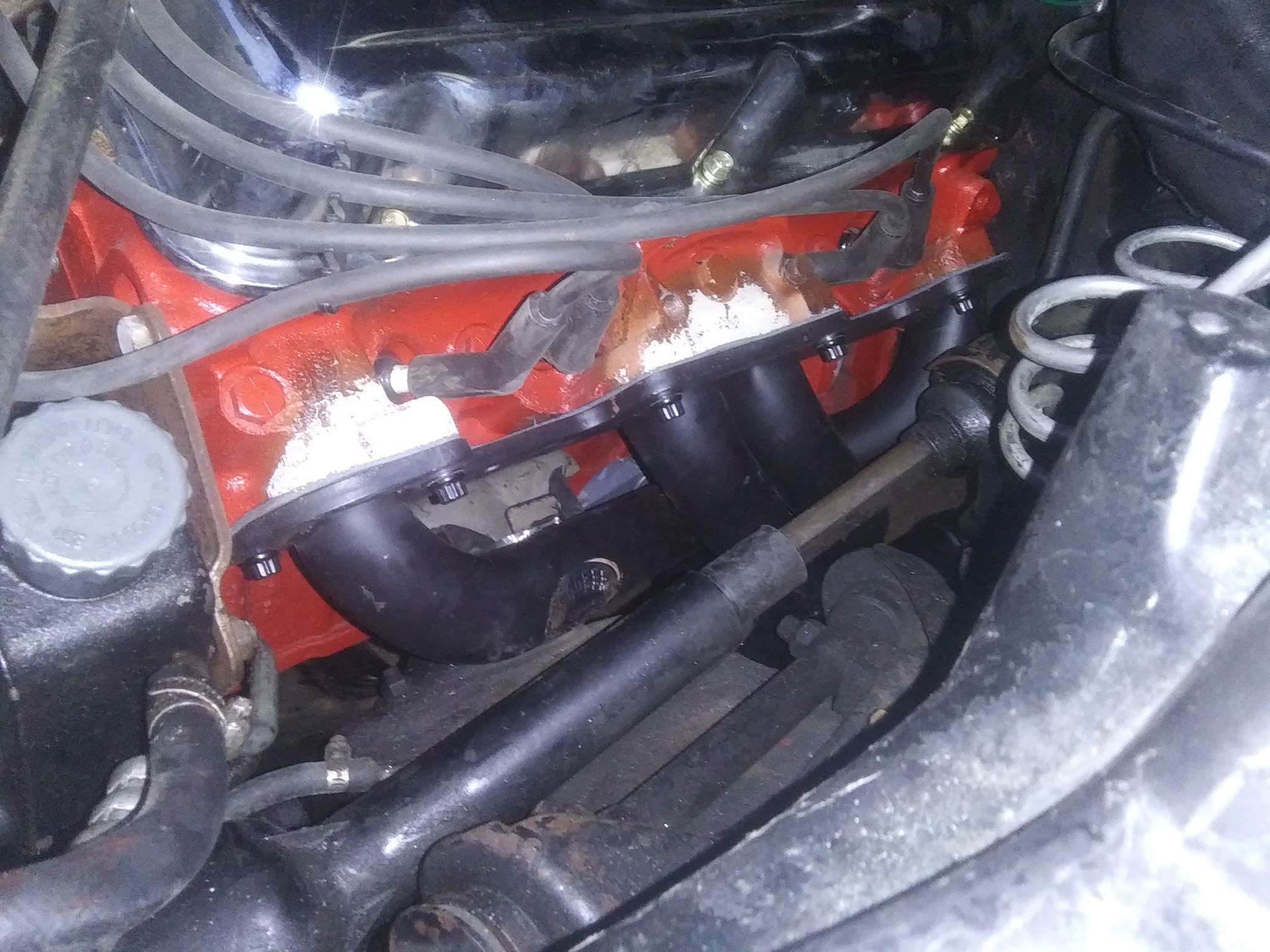

got a little bit of a late start to it, but I got the driver's side header in. Had to chop some of the motor mount off for it to fit. The header just kisses the driver lower control arm mount might take it back out and smack it. It went in about as well as headers do, have to have the car at least a foot and a half in the air to get the header in. the bolts are barely long enough to do the job. why.
passenger will be done later tomorrow (today), although it's supposed to rain the rest of the week. yay.
I like the fitment overall, however. despite being long tubes (only style available), they sit up reasonably high. I dig em.

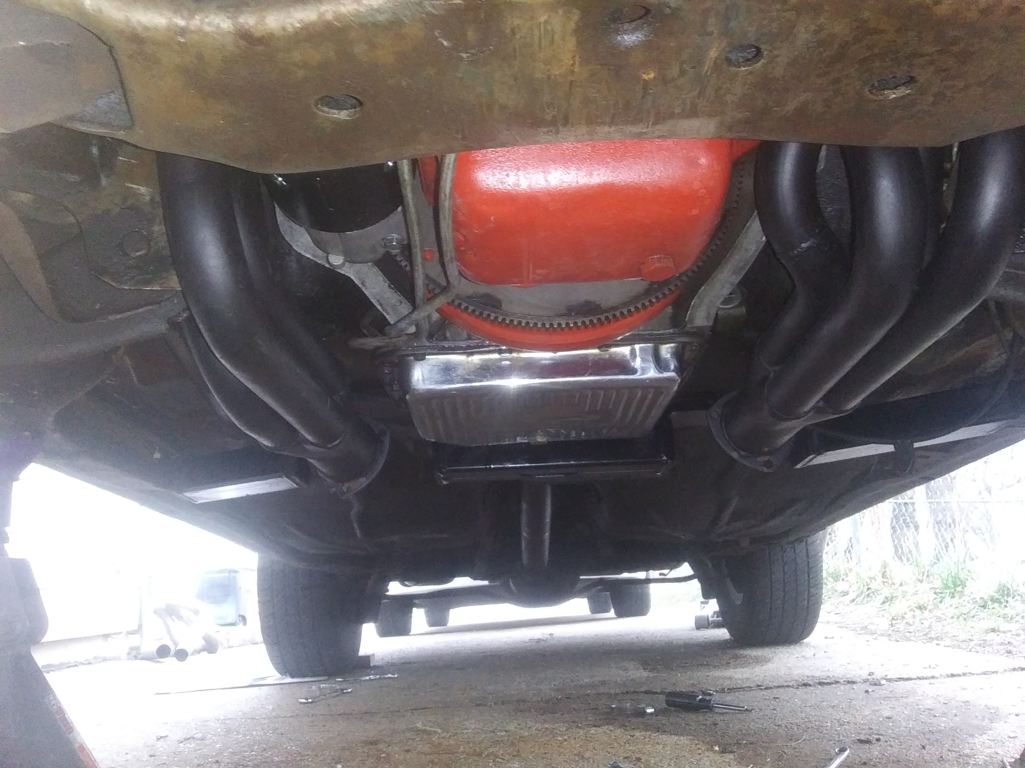

Got the passenger header on. Tbh the fitment is pretty damn great for them being A Body only headers.
It's loud.

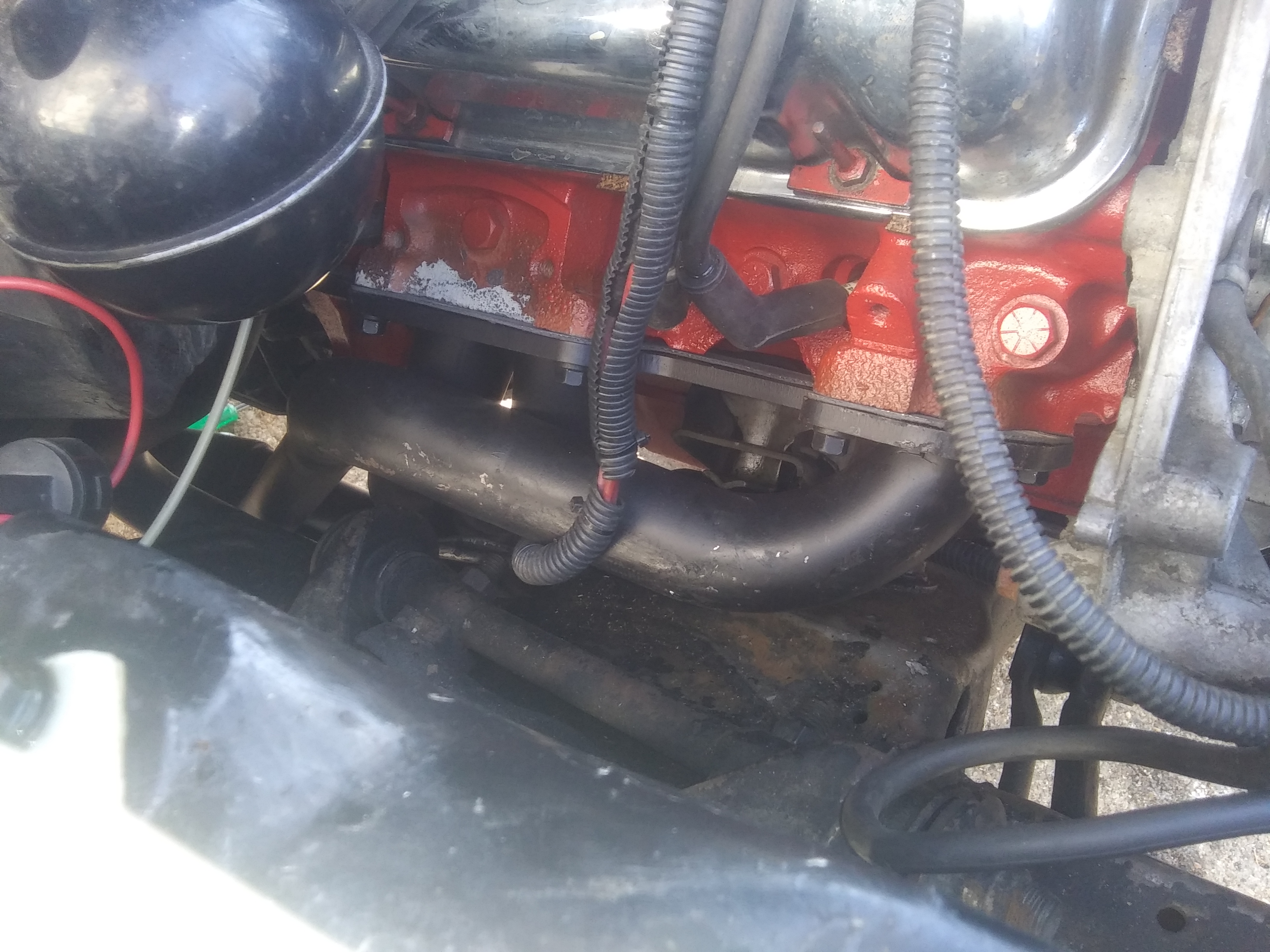

Take note joesregalproject, if you use headers, you'll want a ministarter. You'll need to trim the starter heat shield regardless. Do yourself a favor and trim the front LCA mounts (or take a sledge to your headers) for a lil extra clearance. The driver middle lower bolt is the hardest thing about installing these. But that's always the case with Buicks. At least the header tubes aren't in front of the spark plugs. 🙂
YES I MOVED THE WIRES ON THE HEADER BEFORE STARTING.
