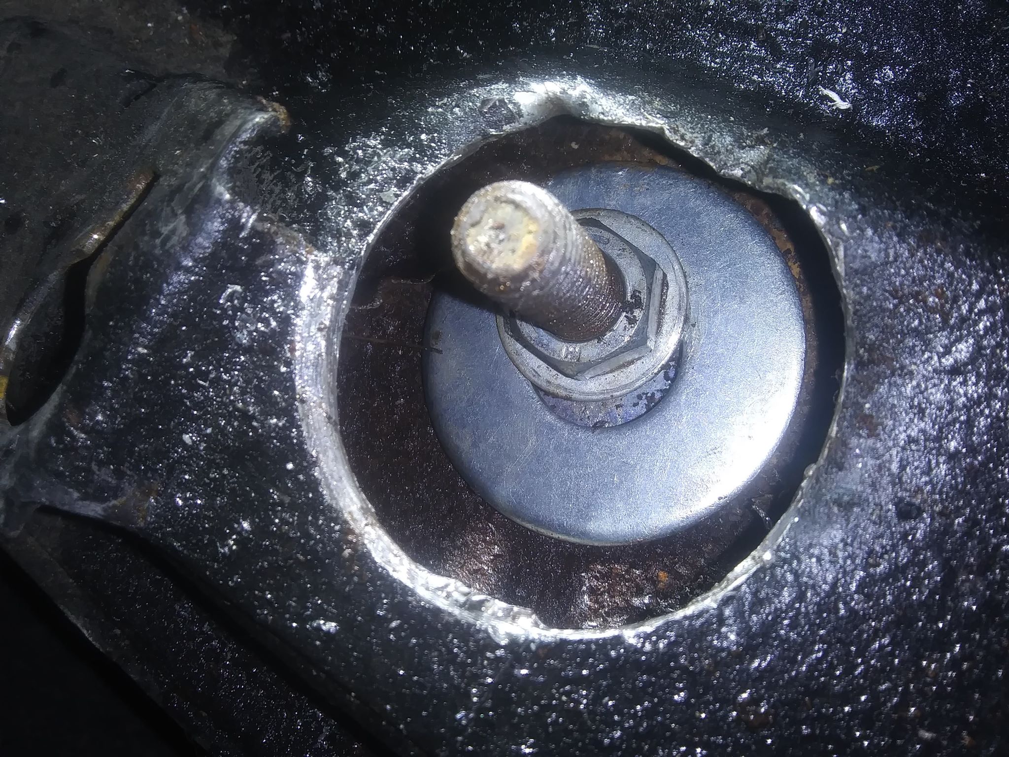

Attempted to do my rear 4 body bushings. Went about as terrible as I expected.

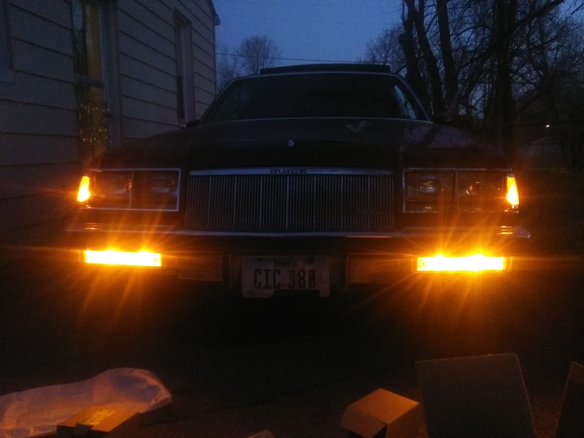

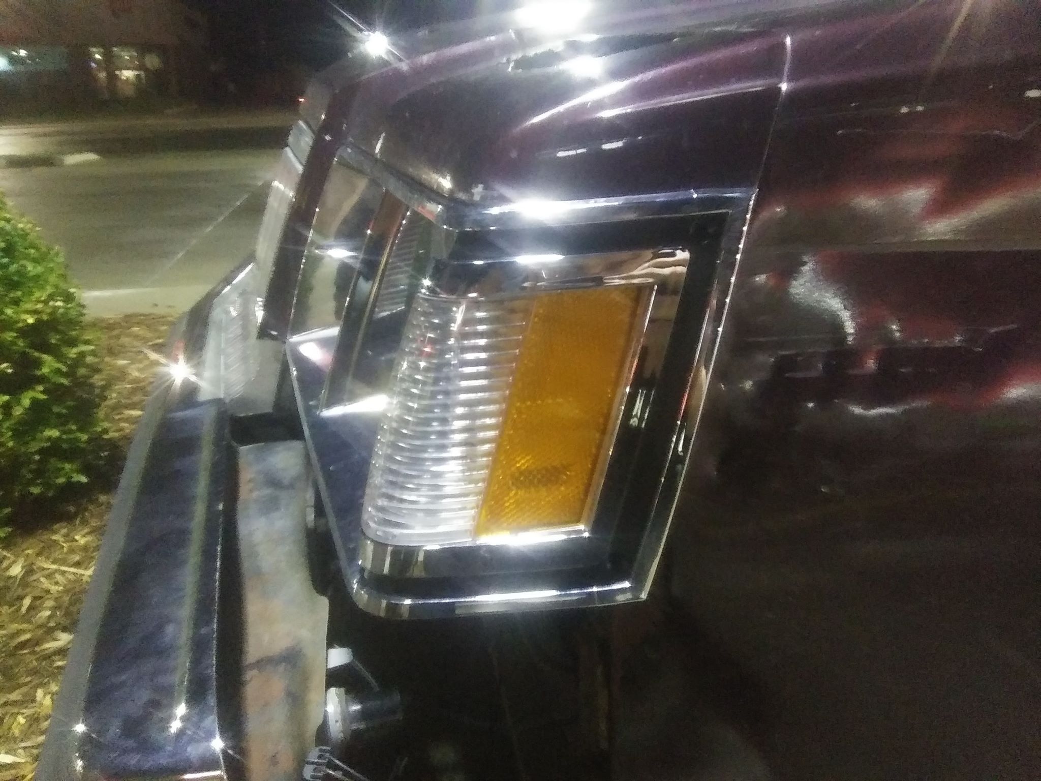

Also some sh*t showed up. All from rock auto, headlight bzels, marker light, driver bumper marker light. Bezel+marker fitment is meh at best. have a dremel at the ready. No hardware included, as expected.

Seen that one coming! Now what are you going to do?
hole saw. nuts on back side. ****in send it.
dad (understandably) is tired of car sh*t going on in the driveway, landlord scoffs at any car that isn't shiny, and the property is just too small for a frame swap. So, fix the 4 rears, and just leave it at that for the foreseeable future. All the other ones are at least where they should be.
I hole sawed my trunk floor too man, all 4 damn locations! Installed longer bolts, doubled up thick washers and locknuts and sent!
****in sent it
car sits higher too
yes i changed out the large washer.
Should handle better, too. Mine did; took the tail wag out of it. Did you get some tapes?
It does. Less bangy too. And nope. 😀
