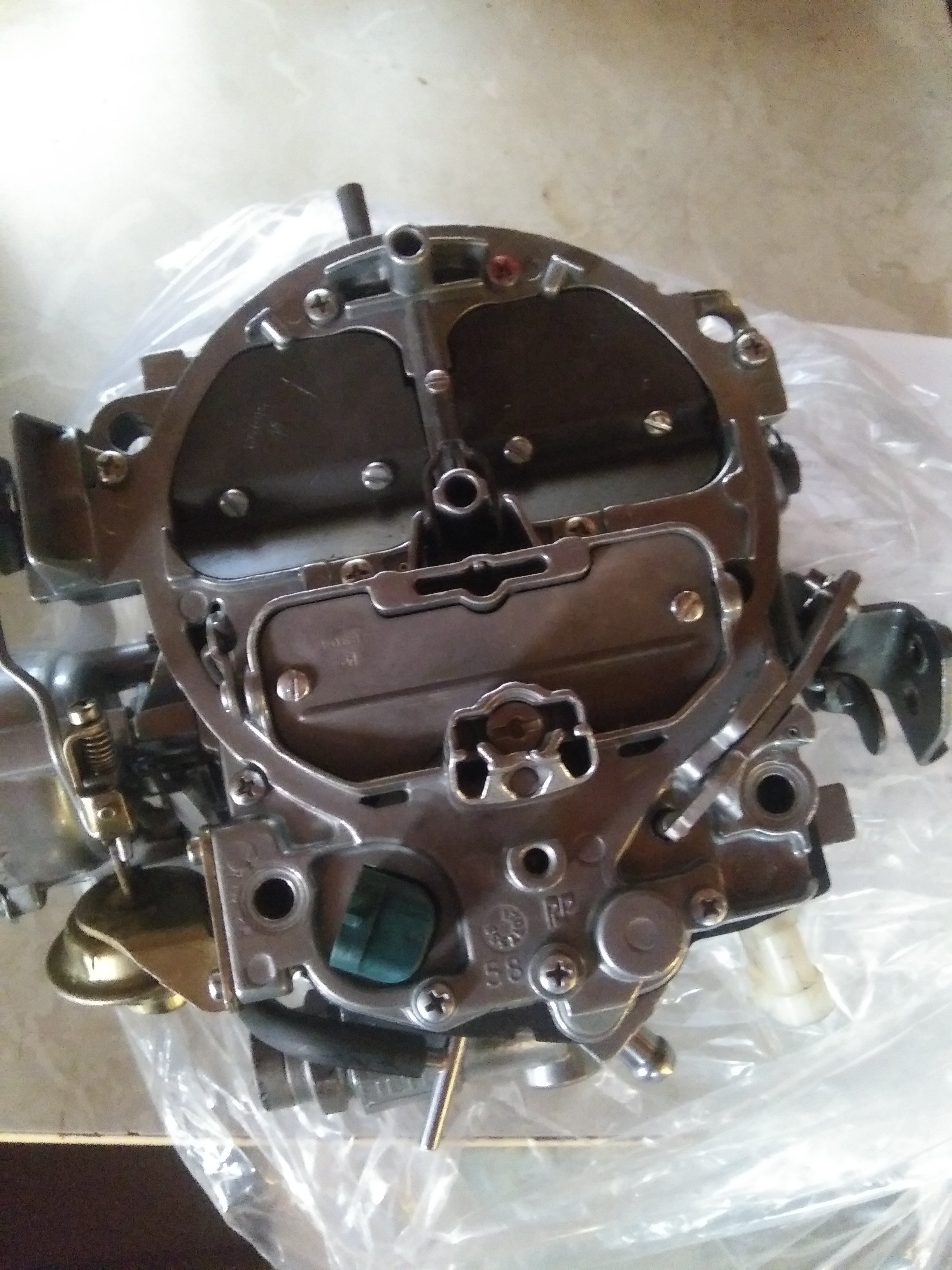

That's not going to work well unless you have an ECM and the emissions stuff on the car.New Carburetor Came in from Amazon today. Going to find out some time this month if it works with the Engine I bought. Many more parts to acquire, which will be happening soon, but they are coming from Rock Auto.
I had my q jet built with 72 upper and later model base for the 2004r transmission. Worked great till I went to efiThat's not going to work well unless you have an ECM and the emissions stuff on the car.
If not, you'd be better off with a carburetor from late 60s through the late 70s, assuming your mechanic knows how to set one up and tune it.

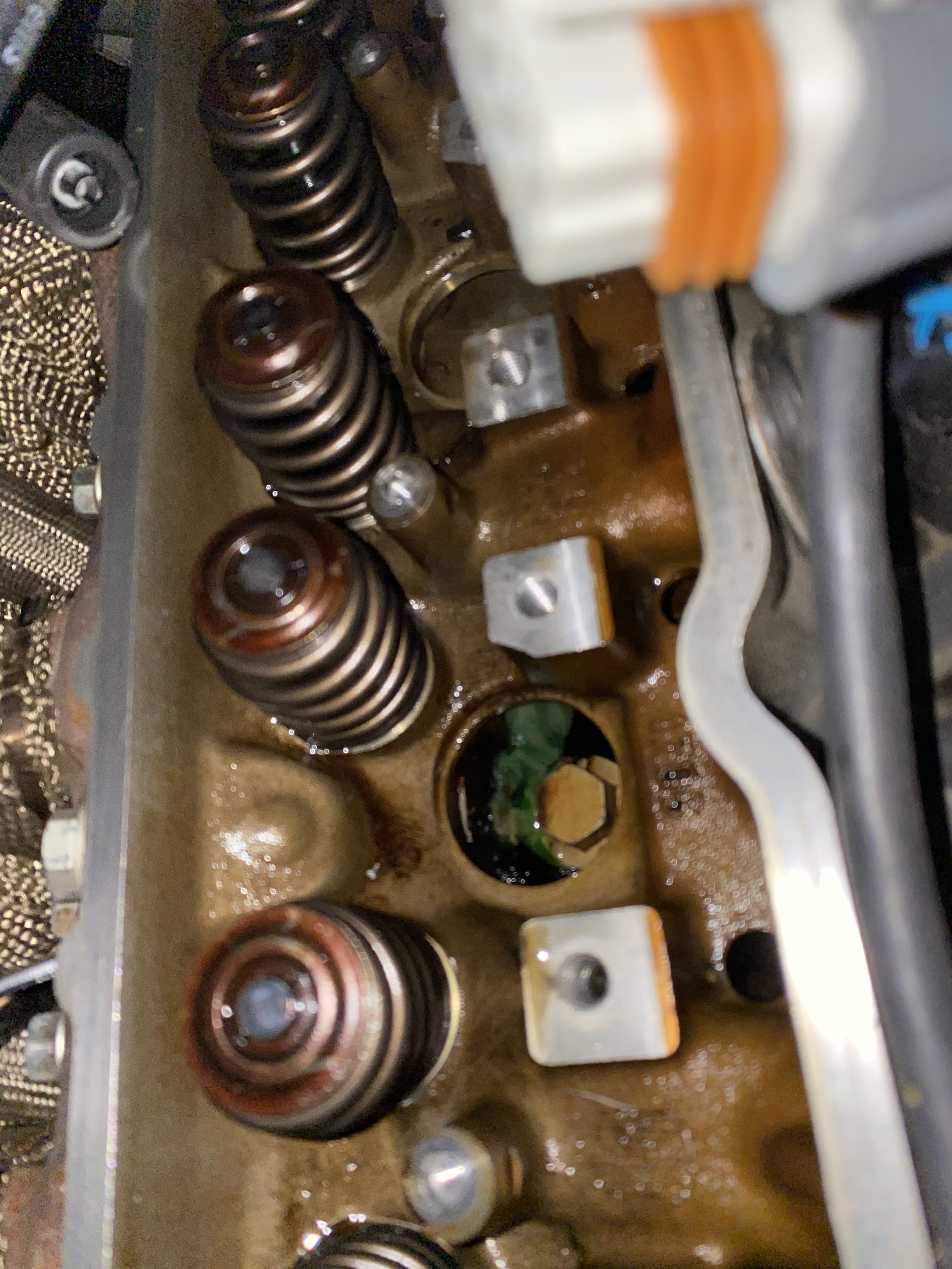

Chasing a noise lead me here:
Pretty sure coolant isn’t supposed to be in the valve train area 😅
Any info on your car? Mine was actually in the distributor timing with vacuum advance. Distributor was curved wrong and had wrong vacuum portaluminum radiator with electric fans installed to see if it helps my overheating... it doesn’t . Oh well motor swap time![]()
