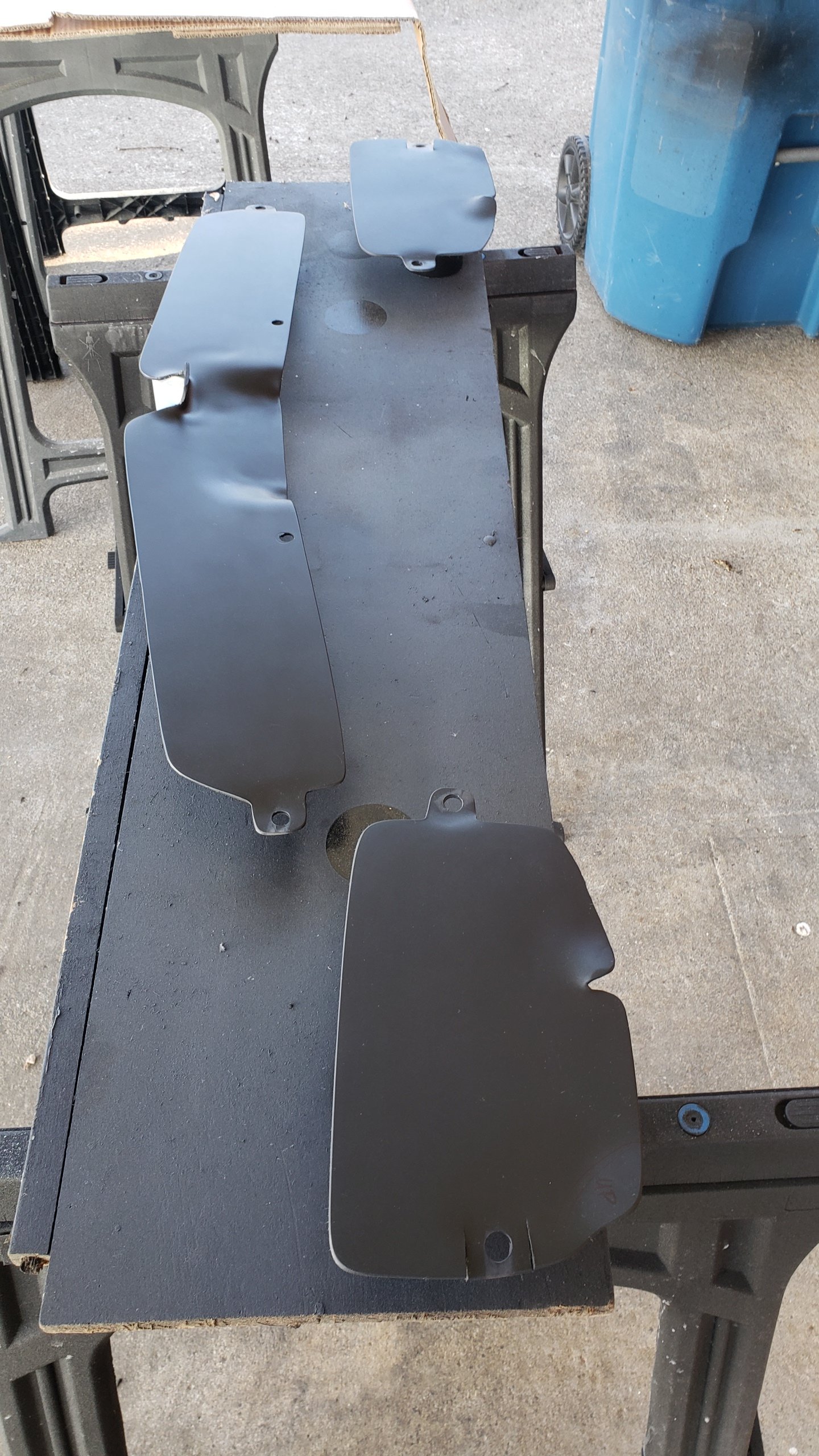

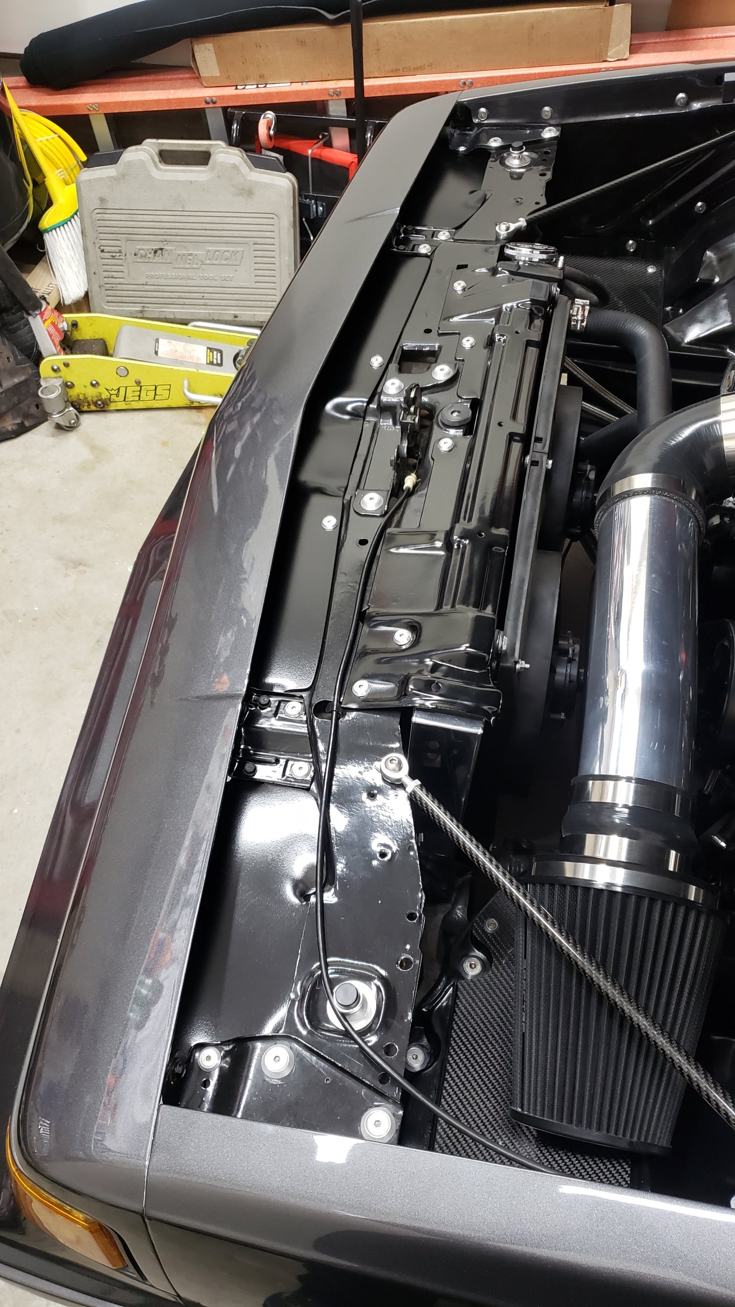

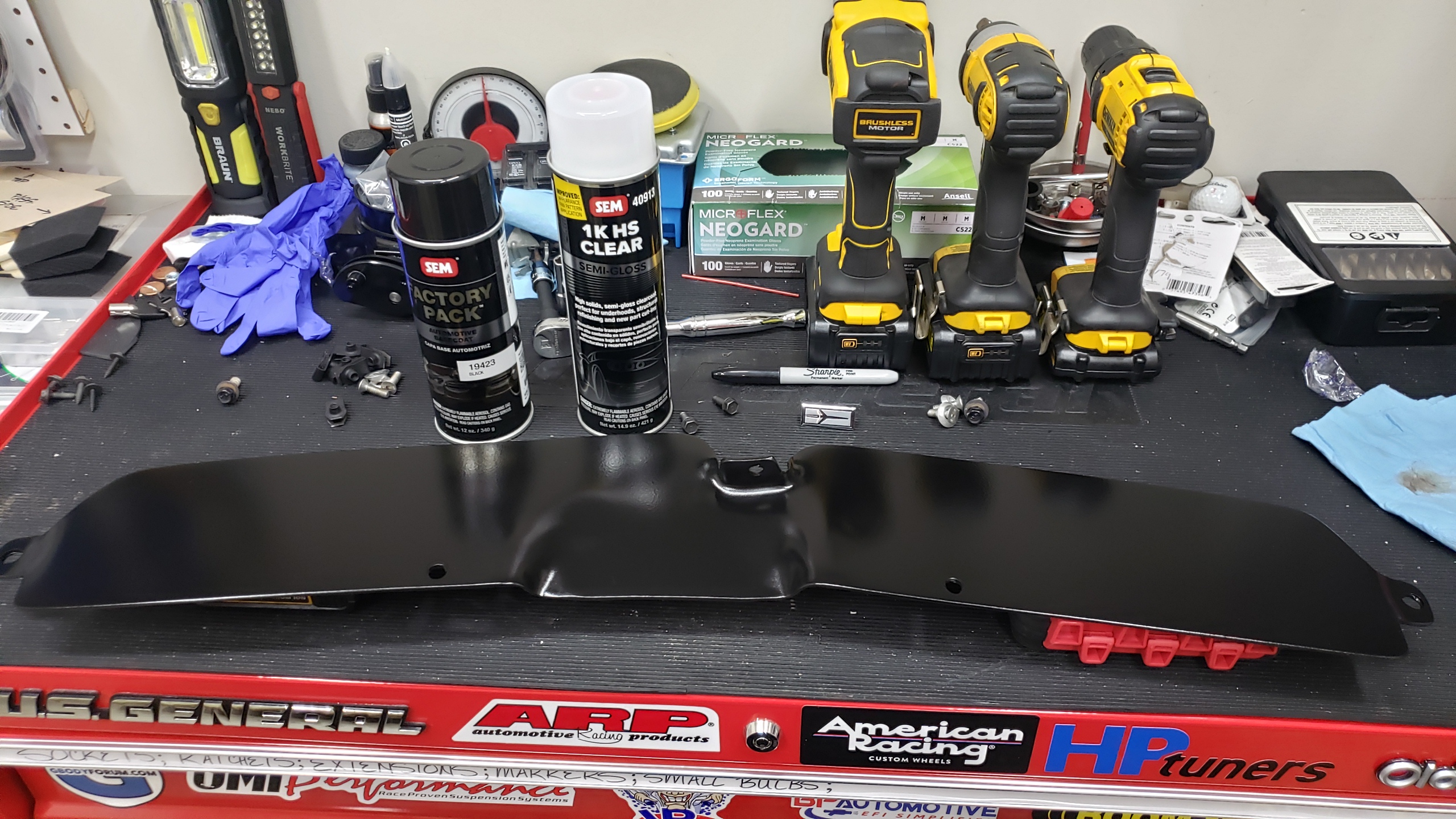

Temporarily installed the bumper and grille just to make it look like a car again. While I work on other things.
This isn't the grille I plan on using. And I couldn't get a can of black epoxy primer for the bumper. But it looks better back together again.
Not gonna miss the chrome. Lol
