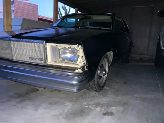

GOT THE DRIVER HEADLIGHT TRIM AND MARKER LIGHT IN
AND A FRESH SET OF FREE TIRES FROM WORK .. FRONTS WERE DOT 3616's

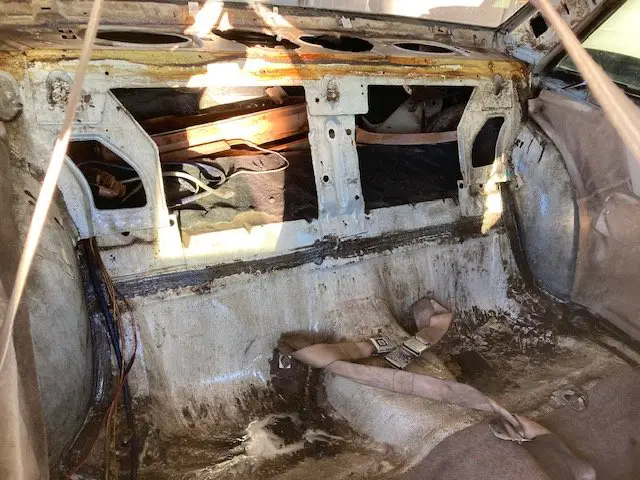

STARTED PULLING THE INTERIOR SO I CAN SCRUB AND CLEAN. GOT NEW CARPET ON THE WAY
GOT HEADLIGHTS HIGHS/LOWS , TAIL LIGHTS AND BRAKE LIGHTS WORKING
GOTTA FIGURE OUT CLUSTER LIGHTING AND TURN SIGNALS NEXT
ILL PULL THE DASH FOR STRIPPING OF FABRIC FIX CRACKS AND EITHER RE- FABRIC OR FIBERGLASS SKIM IDK YET
Wish my interior looked that good when I pulled it apart. I might not have thrown the entire thing in the dumpster.
