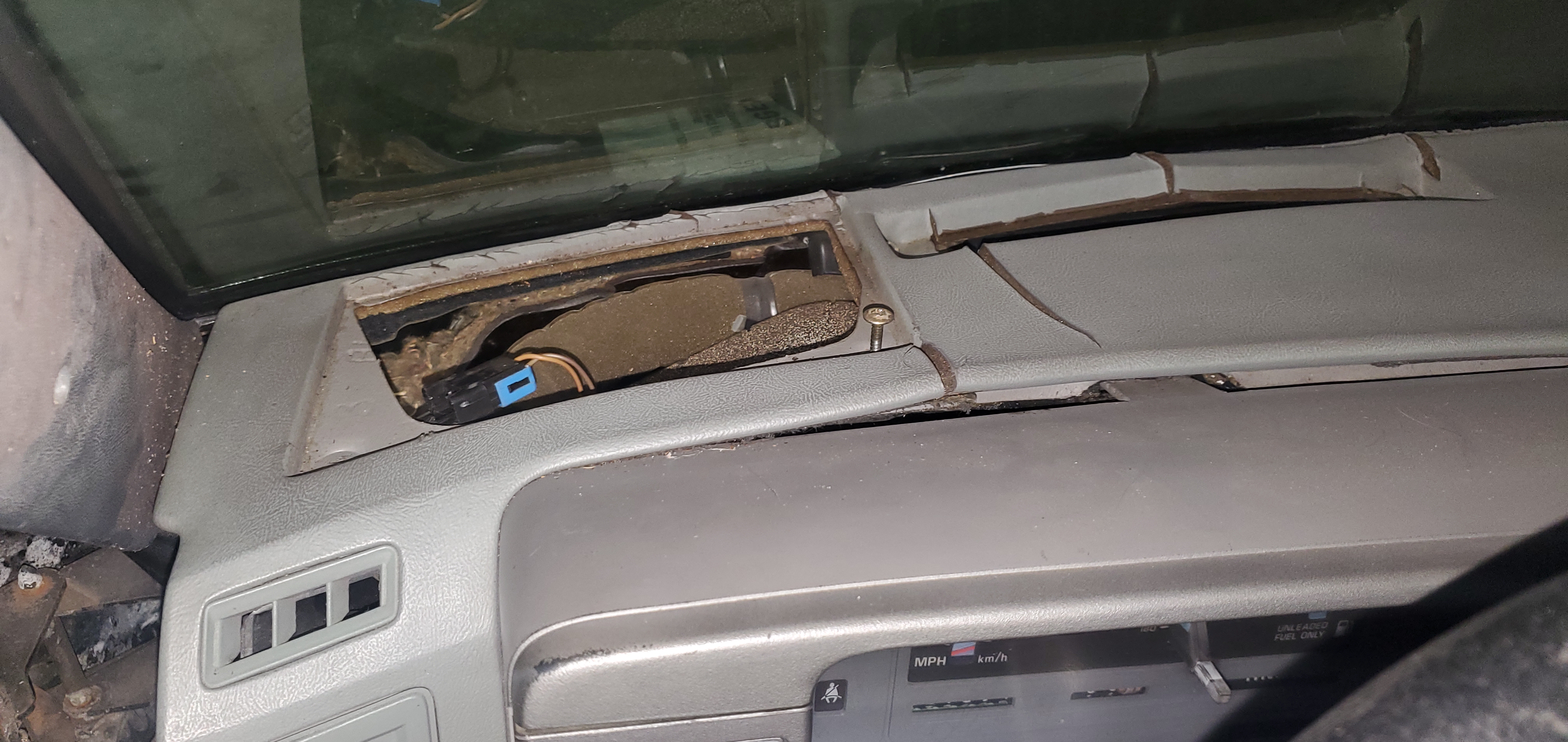

Man that looks really well done, I am thinking of just going the super glue/ baking soda trick since I will be wrapping it anyways. Just want it to lay evenly, you can see they are really bad to start
Looking at that, knowing my knowledge and skills with this stuff and that's a several hour job, and that's if it's out of the car, probably a full day if left in car.
It's doable though.
Just remember, when we strengthen one area, another area will become the next week spot.
It's doable though.
Yeah that is what I am afraid of, had thought about buying a cap to try and keep it all down but then I don't think I would wrap it. Still going back and forth
Reactions: MalibuDavyou5
Can you get another dash?
The cracks bother me none, but the area where it is lifting, some places excessively will be a big problem to repair. If I were you I would hunt up a different dash, repair it while out of the car, then swap them out when ready. Thats my plan for most of my interior is refinish my spare interior and then swap it in when I get to the point of gutting my current interior.
