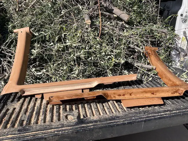

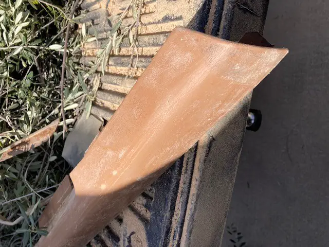

I took off my interior pieces that were starting to have sun rot. I sanded them with fine fine grit sandpaper, then I’m spraying them with Can bed liner then I’m going paint them with camel paint to match.
I JUST DID THE SAME THING THEY WERE VERY BAD ASWELL I STARTED SANDING THEM ASWELL BUT FOUND OUT SCRAPING THEM LIKE A CARROT WITH A FLAR RAZOR CUT THREW IT WAY FASTER!!
AND NOW I HAVE SOMETHING TO PAINT ON OR GLUE FABRIC TO
Here is the pieces sanded down with really really fine grit. Then sprayed with one coat of bed liner. Tomorrow I’m going to maybe add another coat then primer them grey. Then spray them to match interior color so it’s not a black undercoat.
Finished a couple of panels. Before, during, primer and painted.

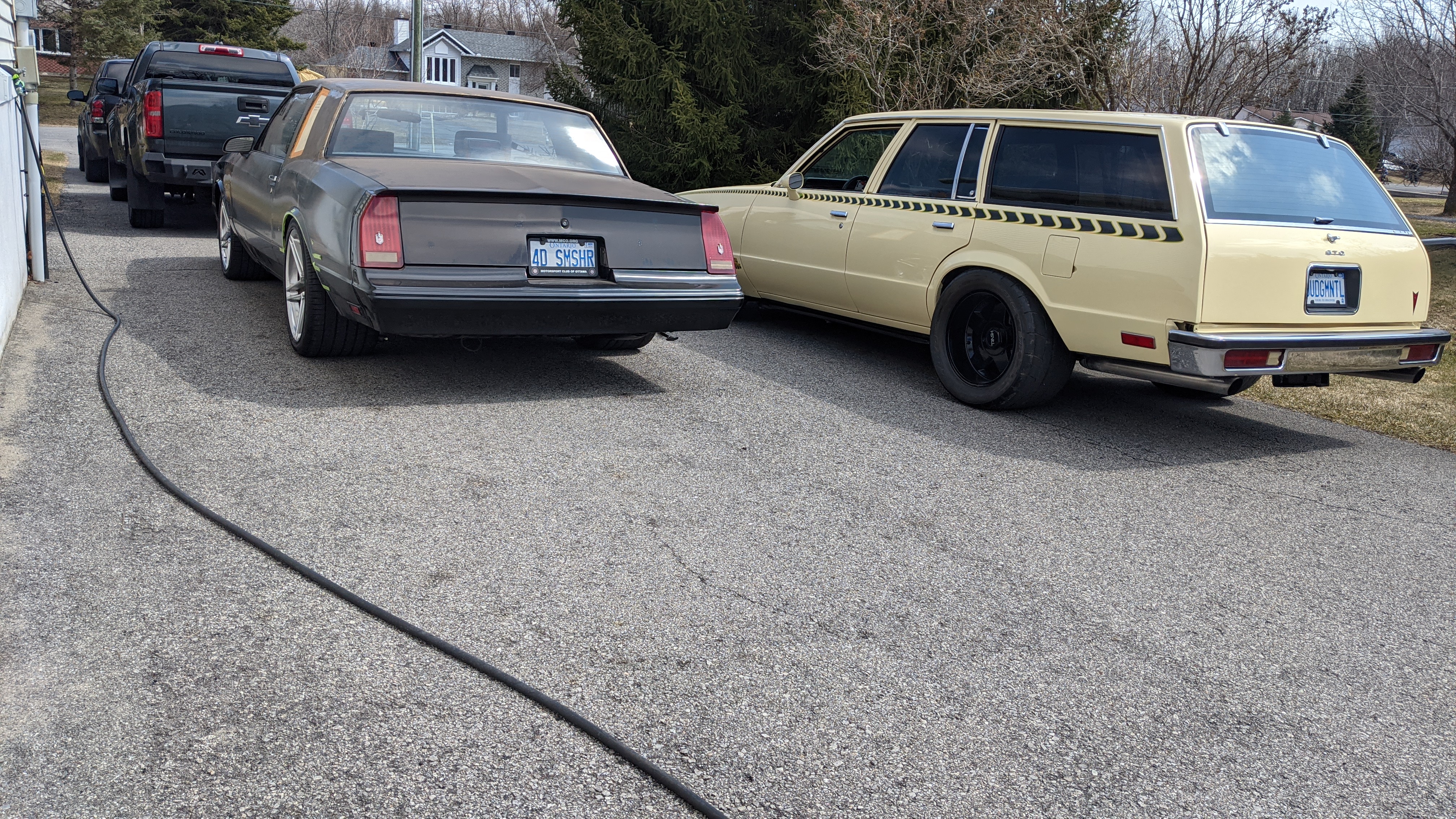

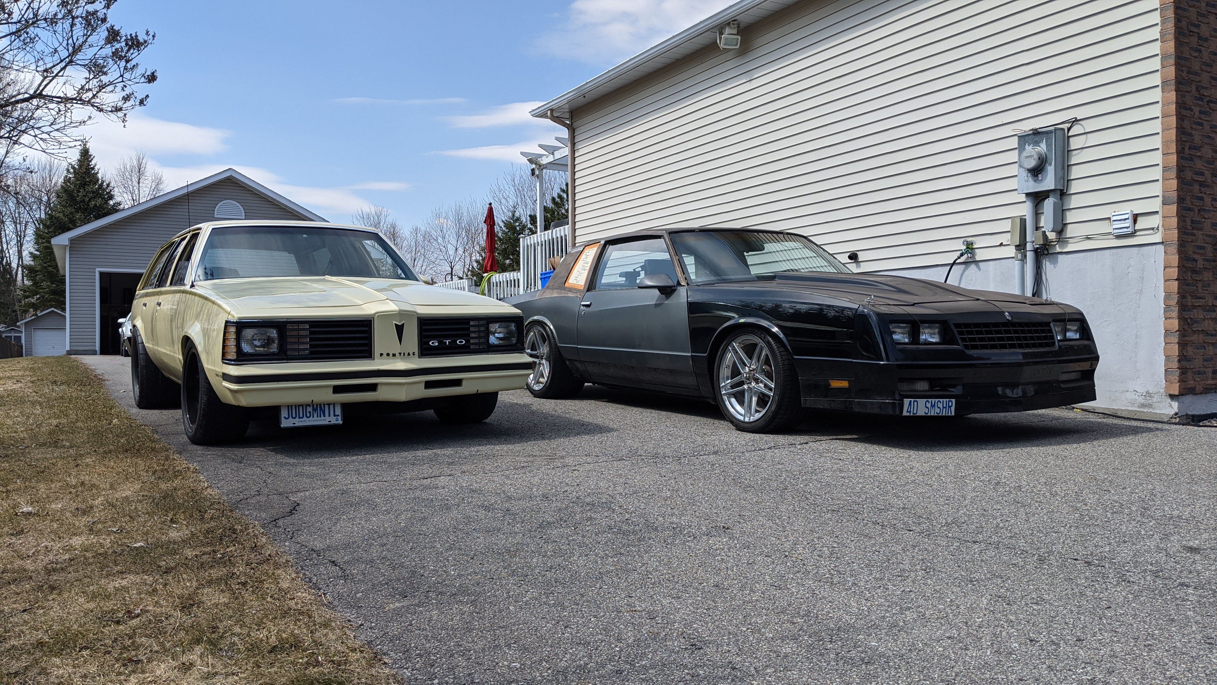

Finished changing the oil, installed the rear sway bar, and inflated all the tires up to 35 psi and took her for a ride , so much better and with the shorter 225/70 /14s I can really feel this 3.42 gear now and Im kinda glad I didnt go 3.73. Speedo is a lot closer now, its now only 3 mph fast , vs 20 .lol had my trans pressure gauge hooked up and I'm getting a max reading of about 270 at WOT and 125 at idle and soon as you crack the throttle, she jumps up . then I drove it to the house to scrub the blue off the letters.
Started a sibling rivalry.
Who's lower? Who's got more tire? More power?
