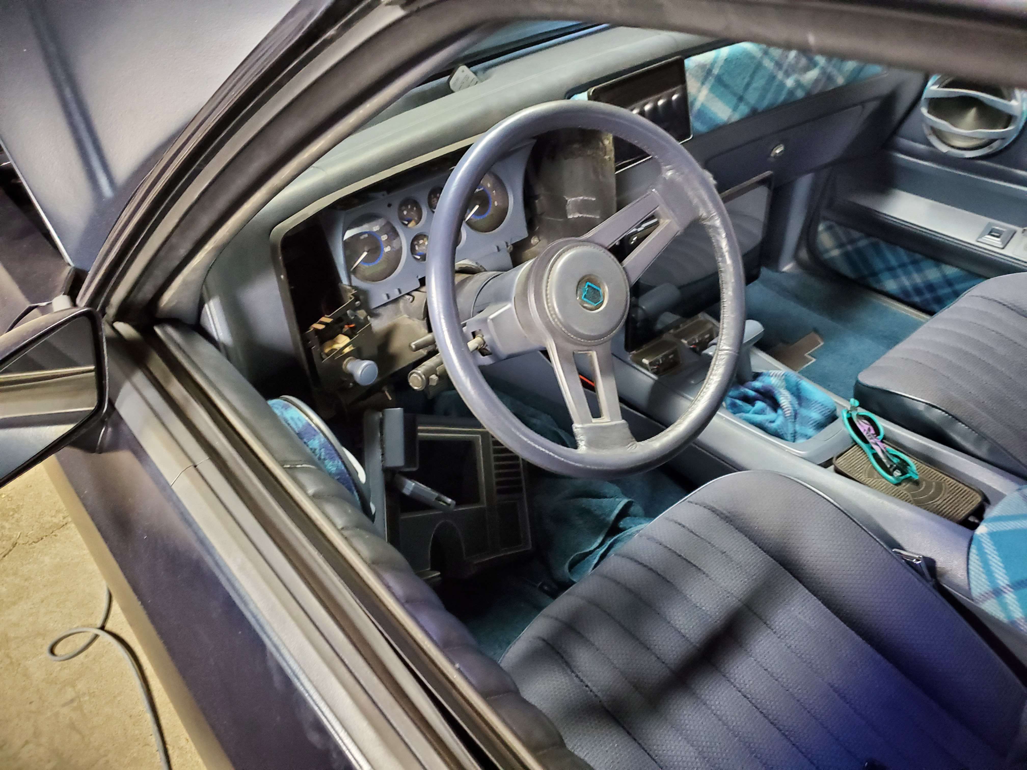

Got back to doing something if it wasn't that much. Ran the new temp gauge wire in the dash harness. Now it'll be dark green/black stripe as the OE warning light wire section was moved into the dash cluster plug slot for the Check Engine light that will now be the temp light. I'll just need to run the new engine harness wire so it'll be the right lenth to get to the gauge sender in the intake. The head port will be for the warning light switch.

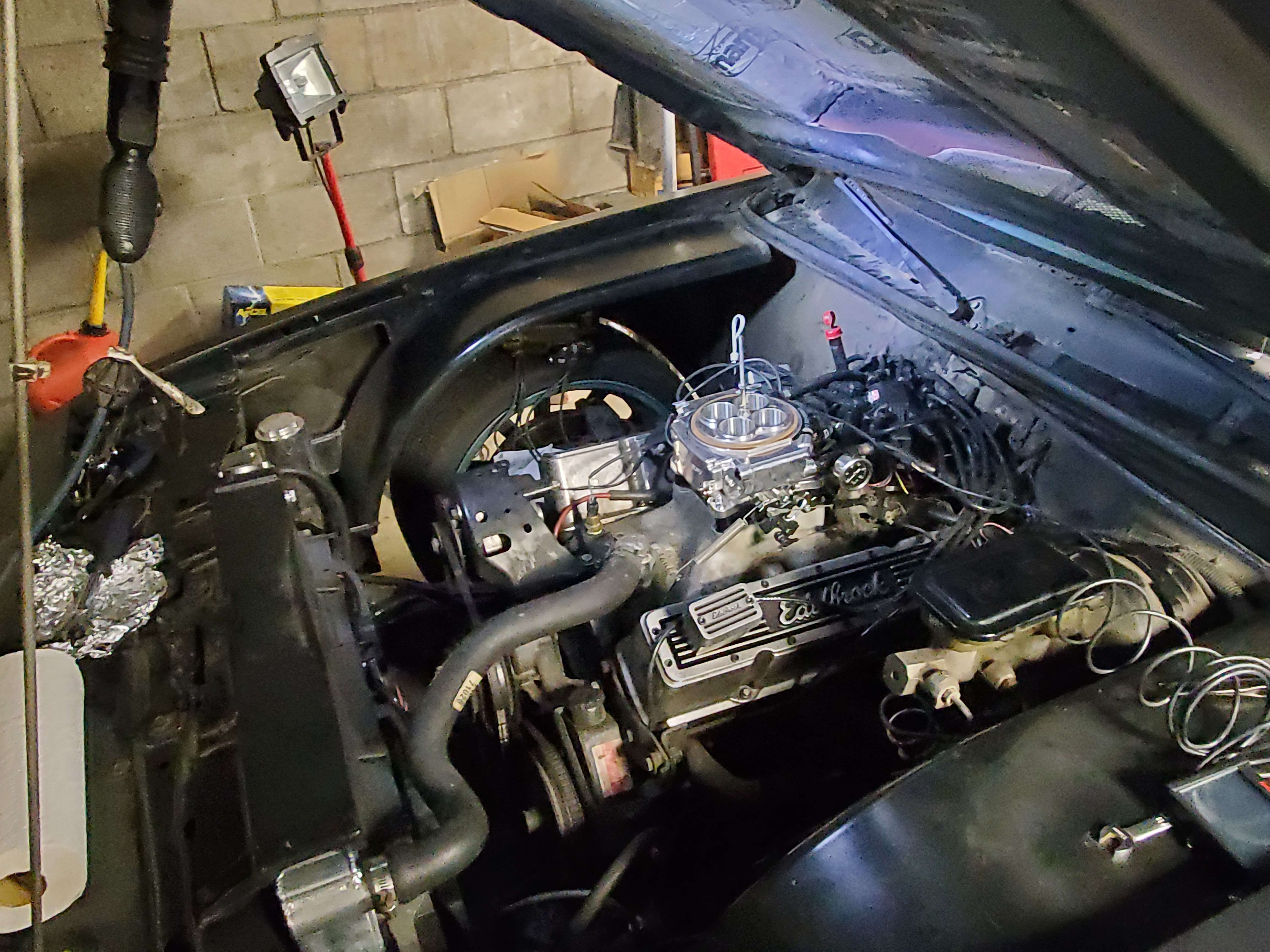

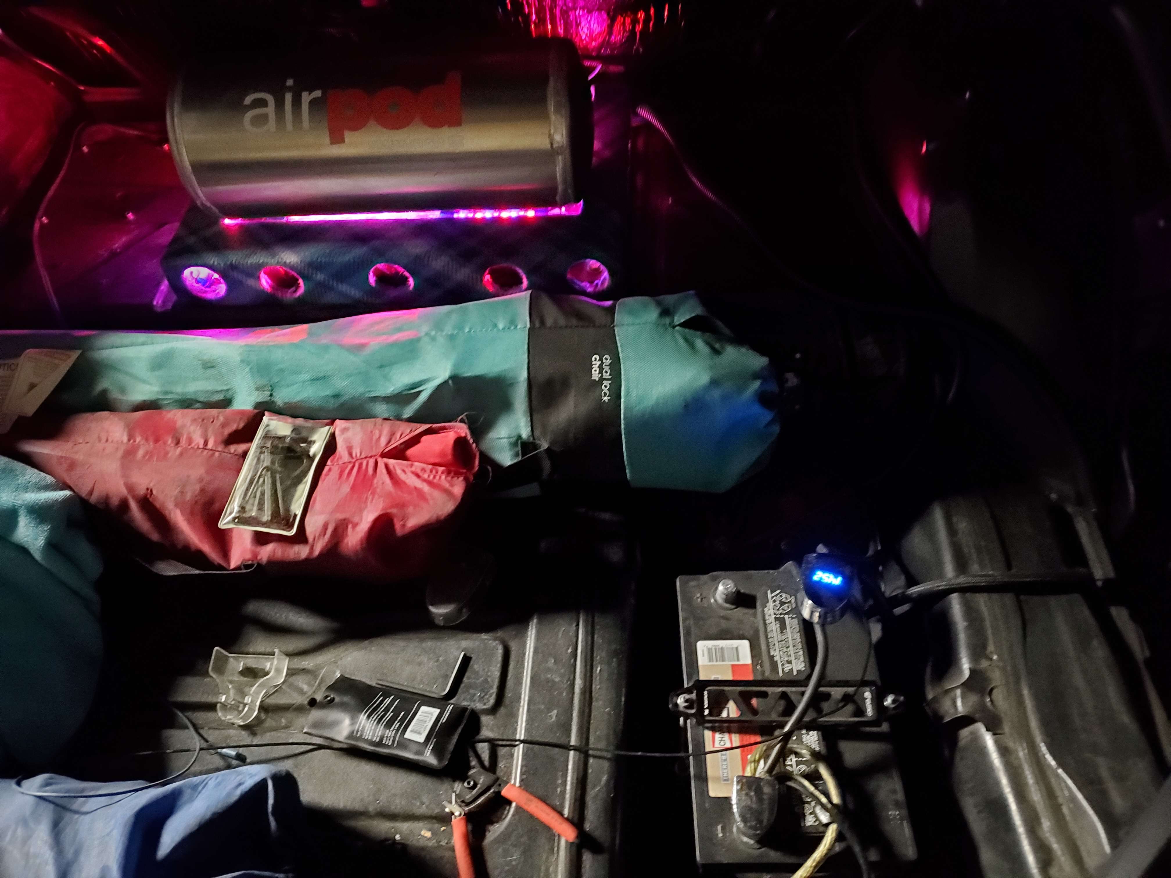

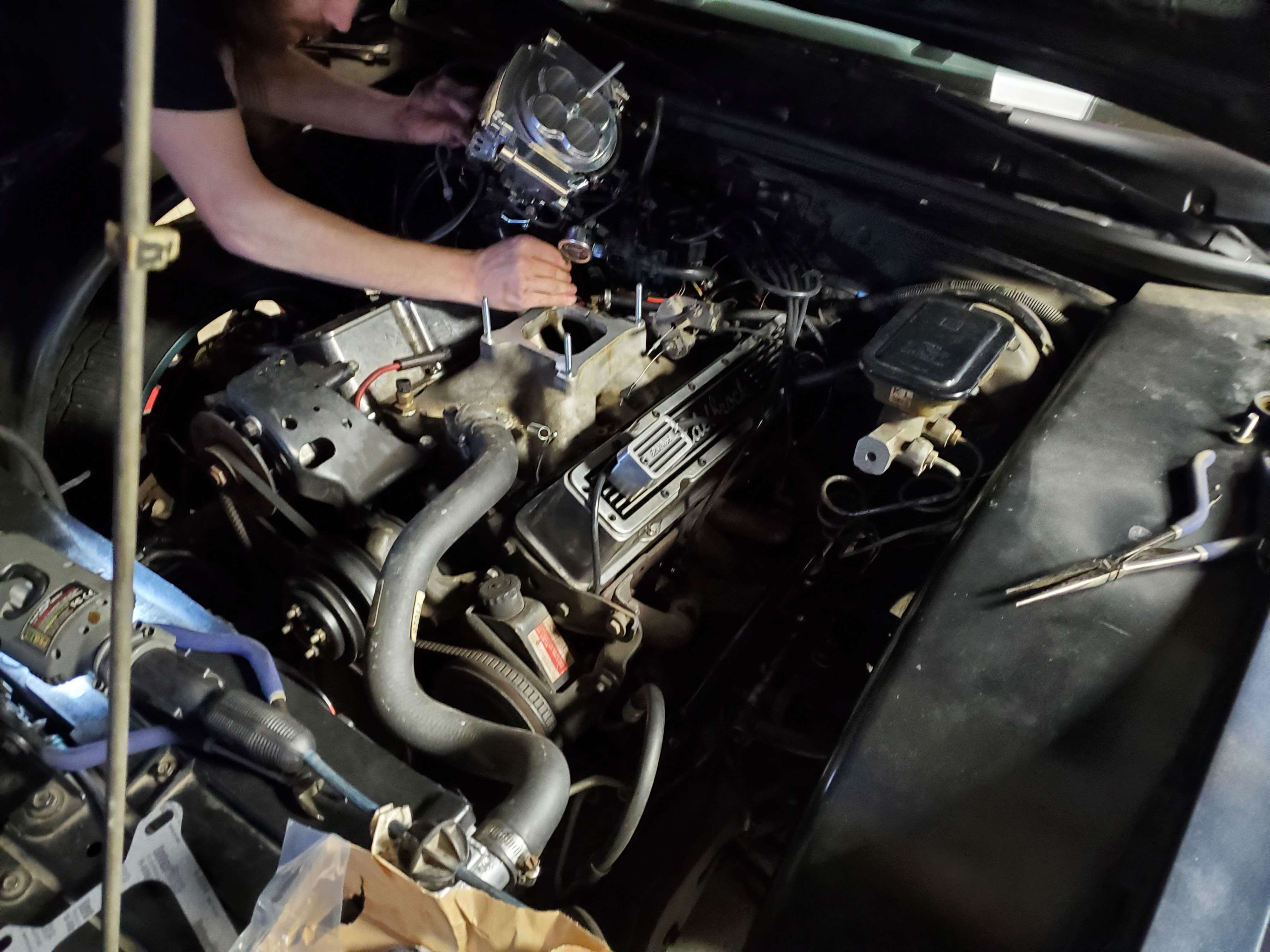

Buddy came over last night and helped me get it all wired up, we ran out of time since he had to go get his gf. Got it all together for test purposes but the fuel pump wasn't priming and working, so need to figure out what is going on there...... Went to disconnect everything and it freaked me out that even with the battery disconnected it still had power, was worried that Christine had shown up. Went up front and disconnected everything from the sniper but apparently since the trickle charger was still connected it was back feeding still allowing some power in

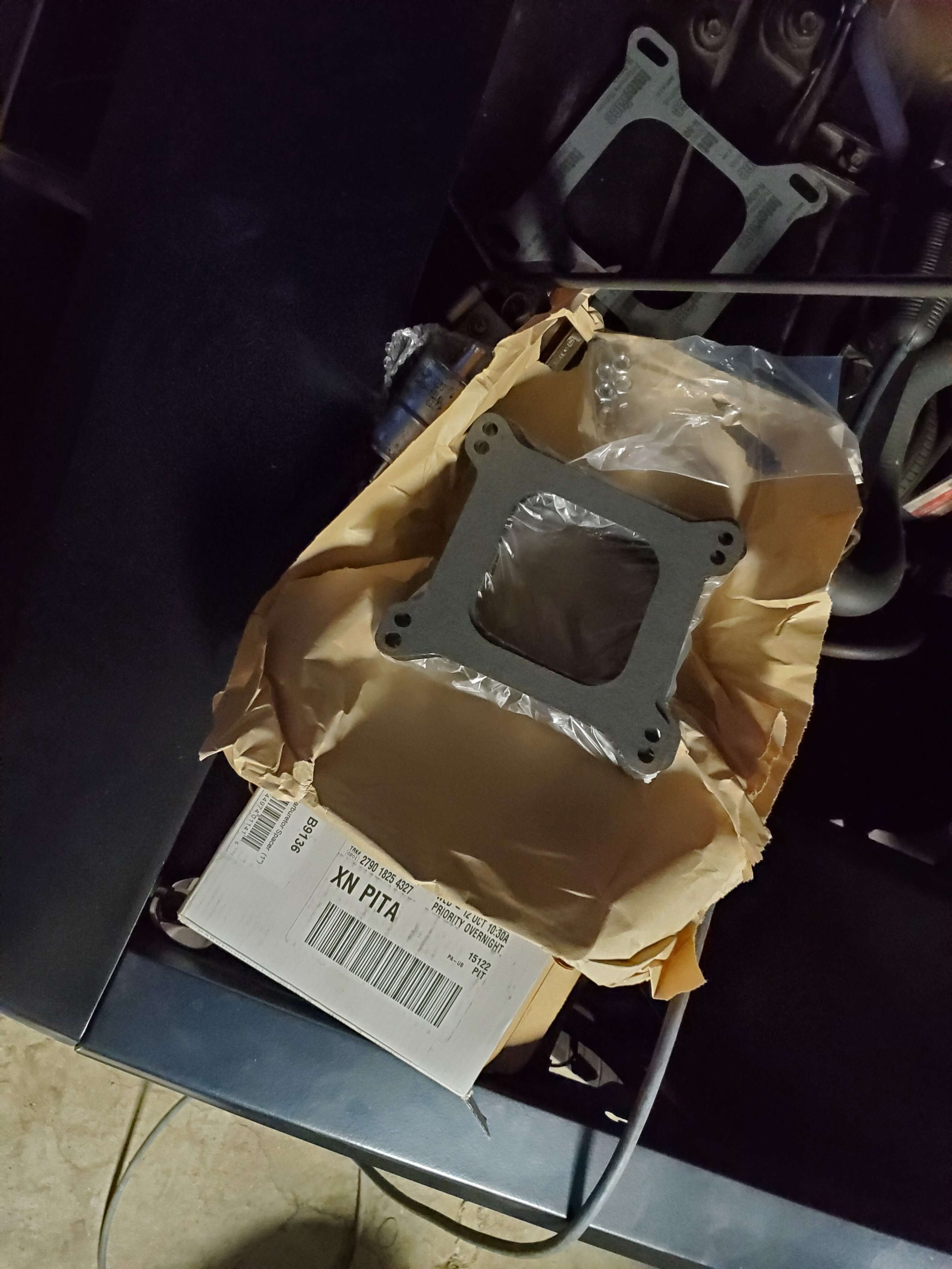

Truth in advertising there....
XN pain in the a**. They put it right on the pkg number. Non ccc Rochester with matching hei and send it! 😆
