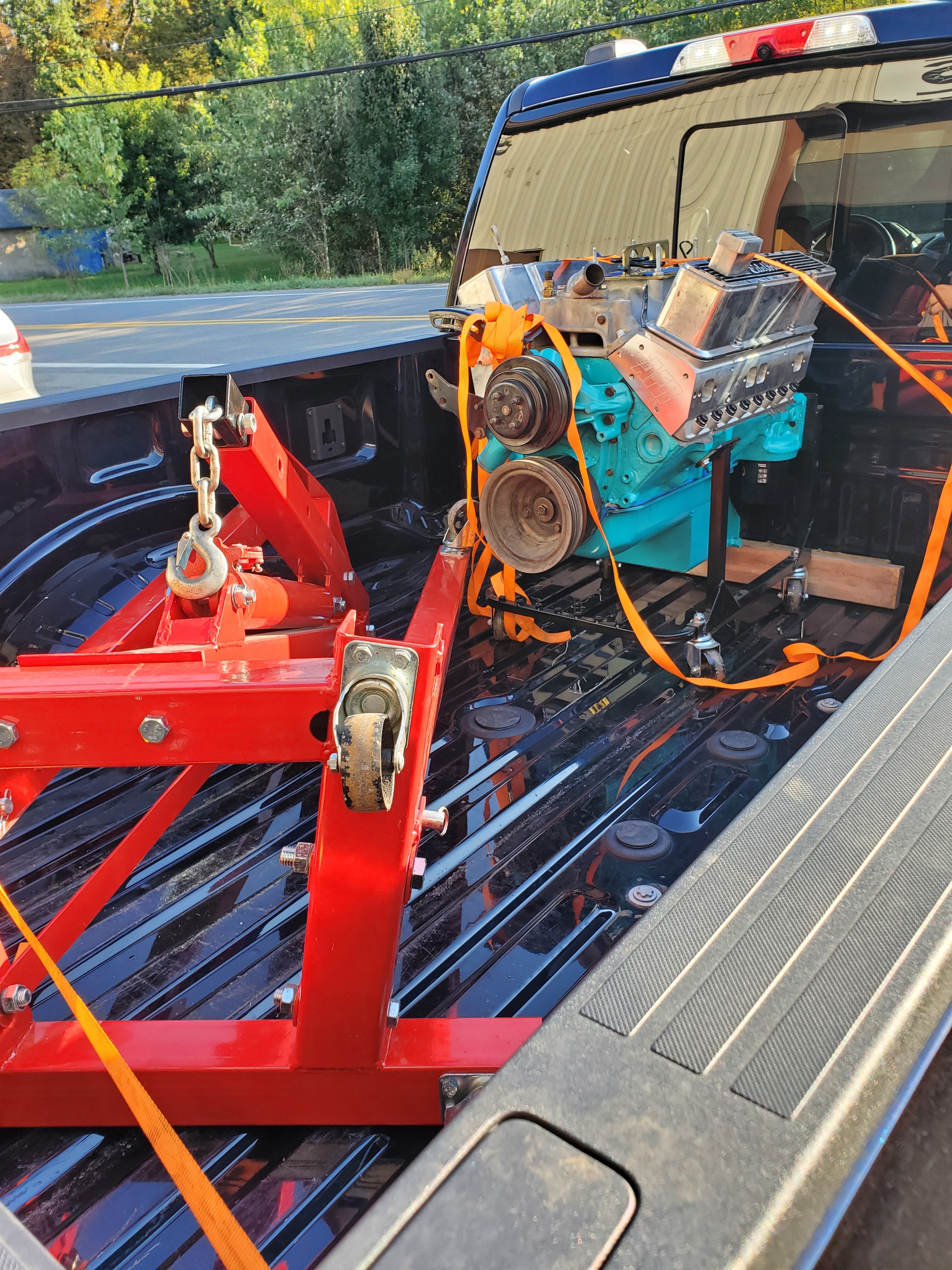

I echo again.... All that paint and didn't clean up the pulleysLoaded up the motor to be ready for Saturday mornings adventure, and since the carb spacer wasn't solid I have to buy another to mount the pcv View attachment 229188
