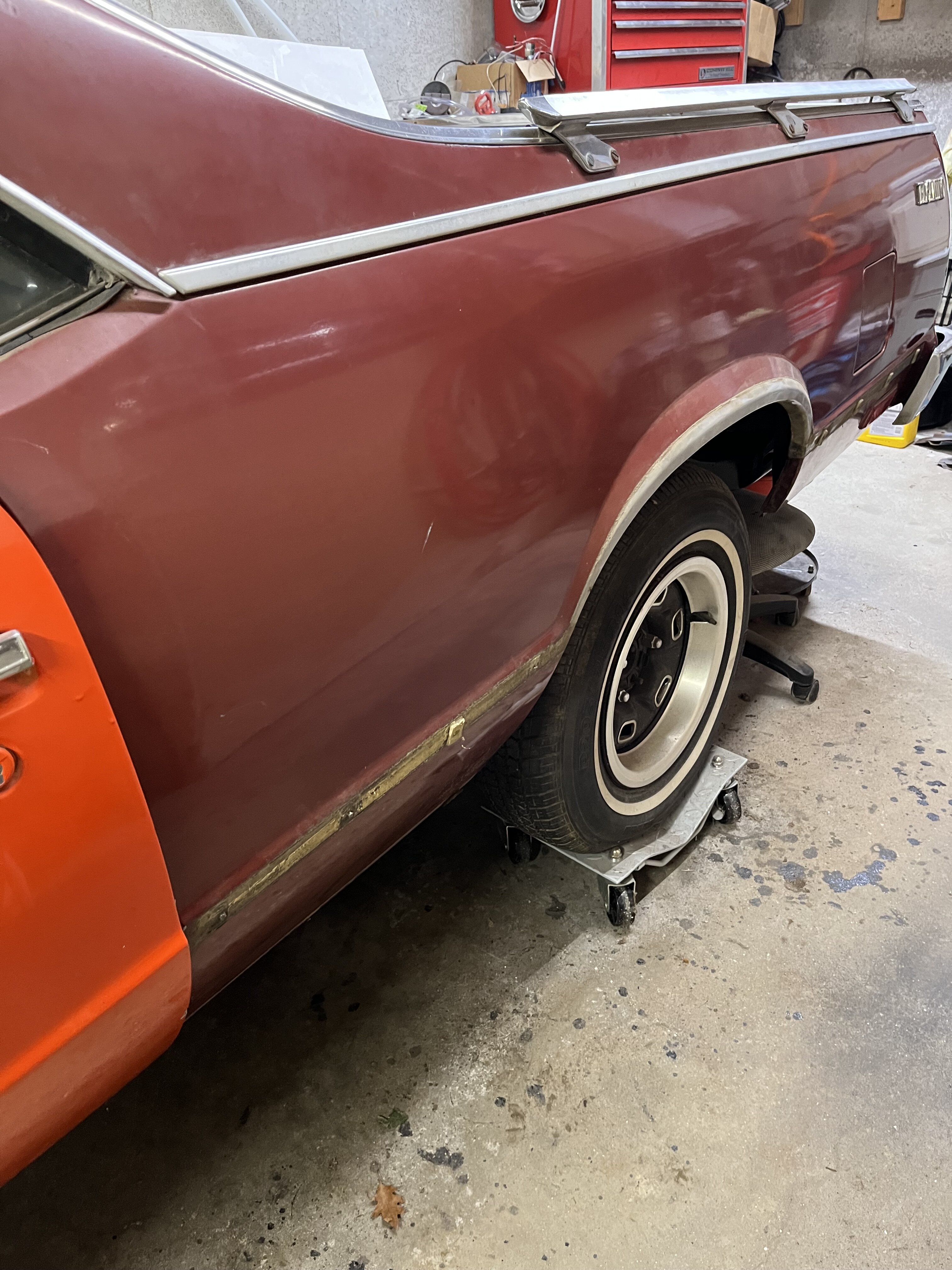

Been trying to get backup lights wired in from the transmission as well as adding the choke and tach wires to go into through the firewall. Finally played with the lower chrome in the rear. And got that off, I’m deleting it so it’ll be up for sale soon as I find out what it’s worth. Was never off the car though it’s multiple paint jobs.

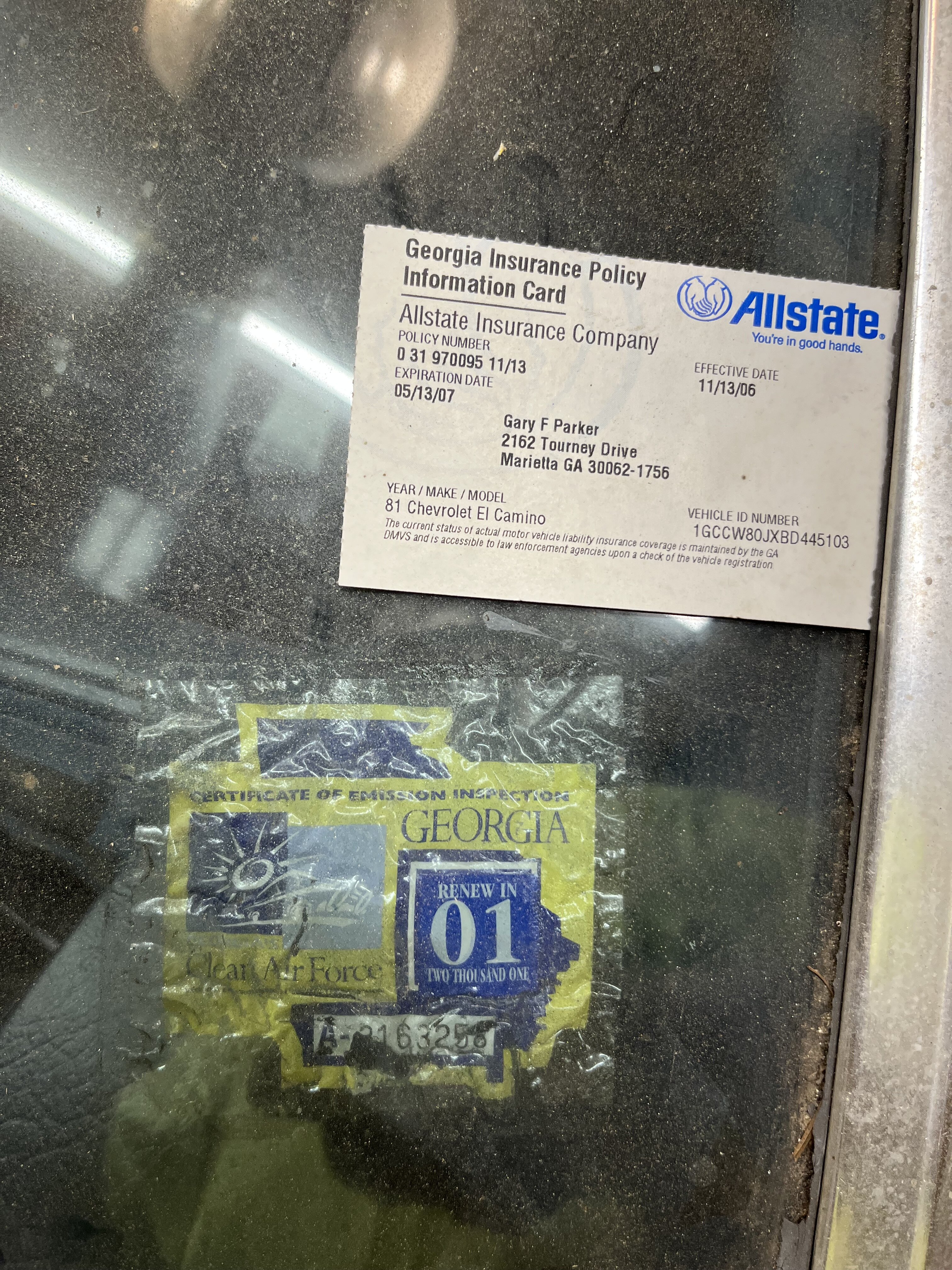

Car hasn’t seen the road since 2001 out of Georgia. Don’t know if anyone knows this guy. He was the last owner that drove it I think. View attachment 229003View attachment 229004View attachment 229005View attachment 229006
well, the insurance card says 2006-2007

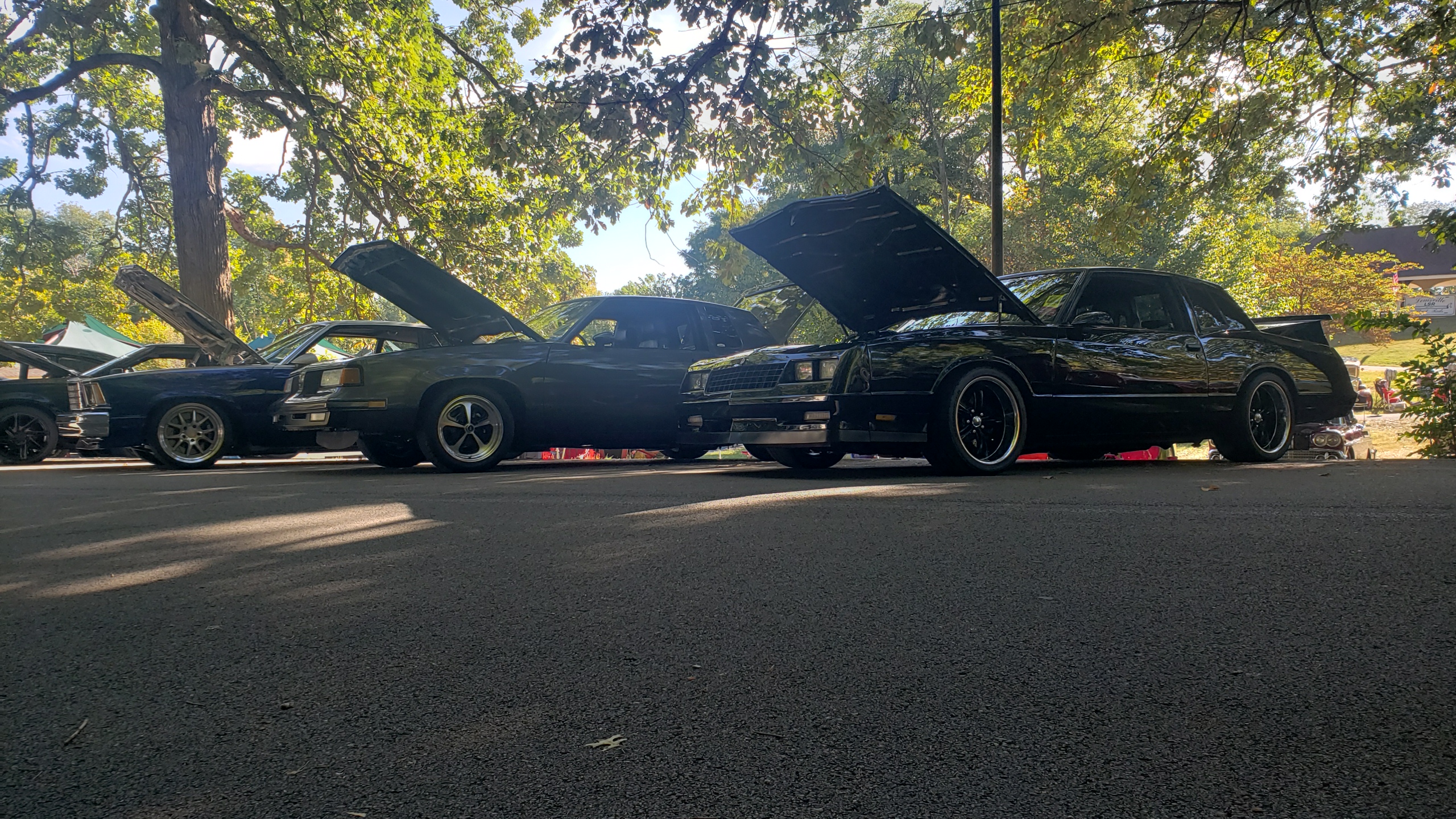

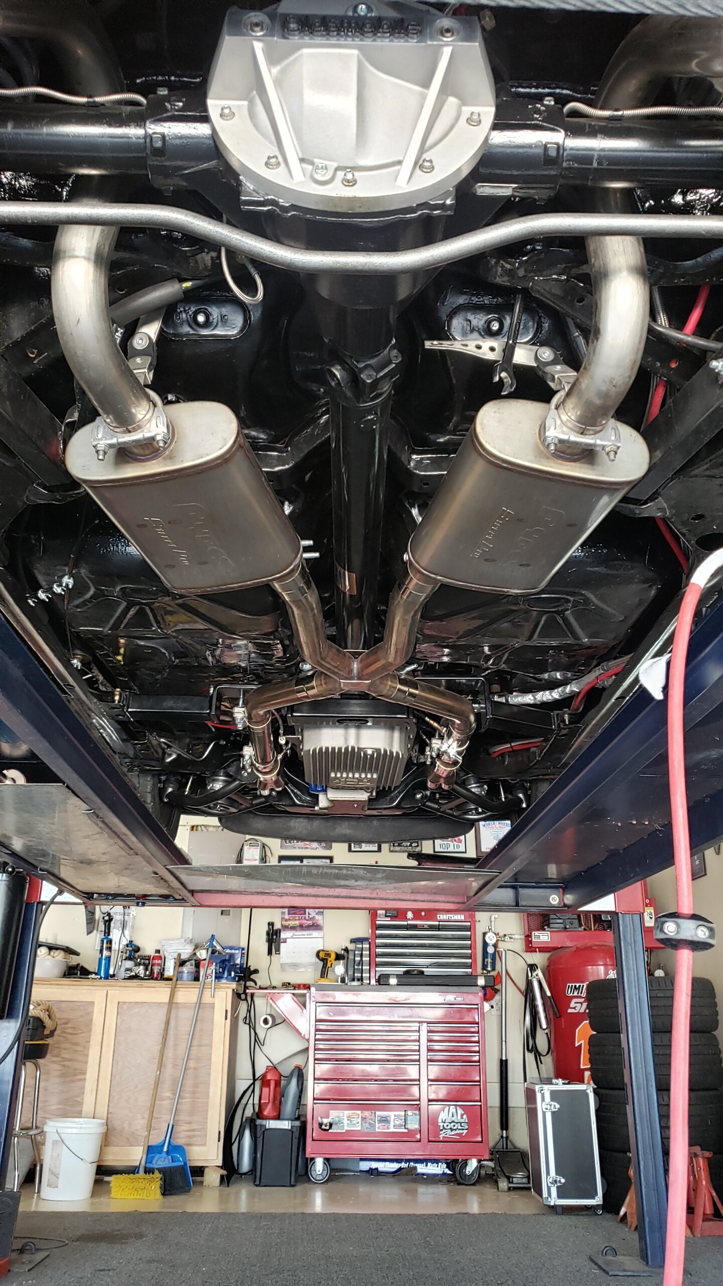

Went to a friend's house who has a beautiful 79 Bu. He has a lift and offered to swap out my upper arms to adjustable ones to correct the pinion angle. It helped some, but still have a vibration to chase down. Pic of our cars at a big show over the weekend, and an underside glamor shot showing I did a full resto, not just a topside....View attachment 228800View attachment 228801
Hi, what headers and crossmember do you have there? And did the headers fit without lifting engine
Speed Engineering 1-3/4" stainless full tubes. They did require some massaging in a couple spots with heat and the round side of a ball pein. Crossmember is a G Force. Those headers slide in with engine bolted in place.

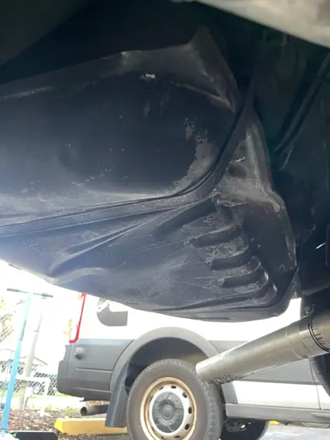

I… uhhhh…
So the jack slipped a little and now I need a new tank…
Hopefully the sender isn’t hurt. If it is I guess I’ll be spending spending that 4l80 money somewhere else.
Up side, time for a fuel injection tank and pump?
Unfortunately it was a baffled tank with a previous gen racetronix sending unit hopefully I can salvage the sending unit

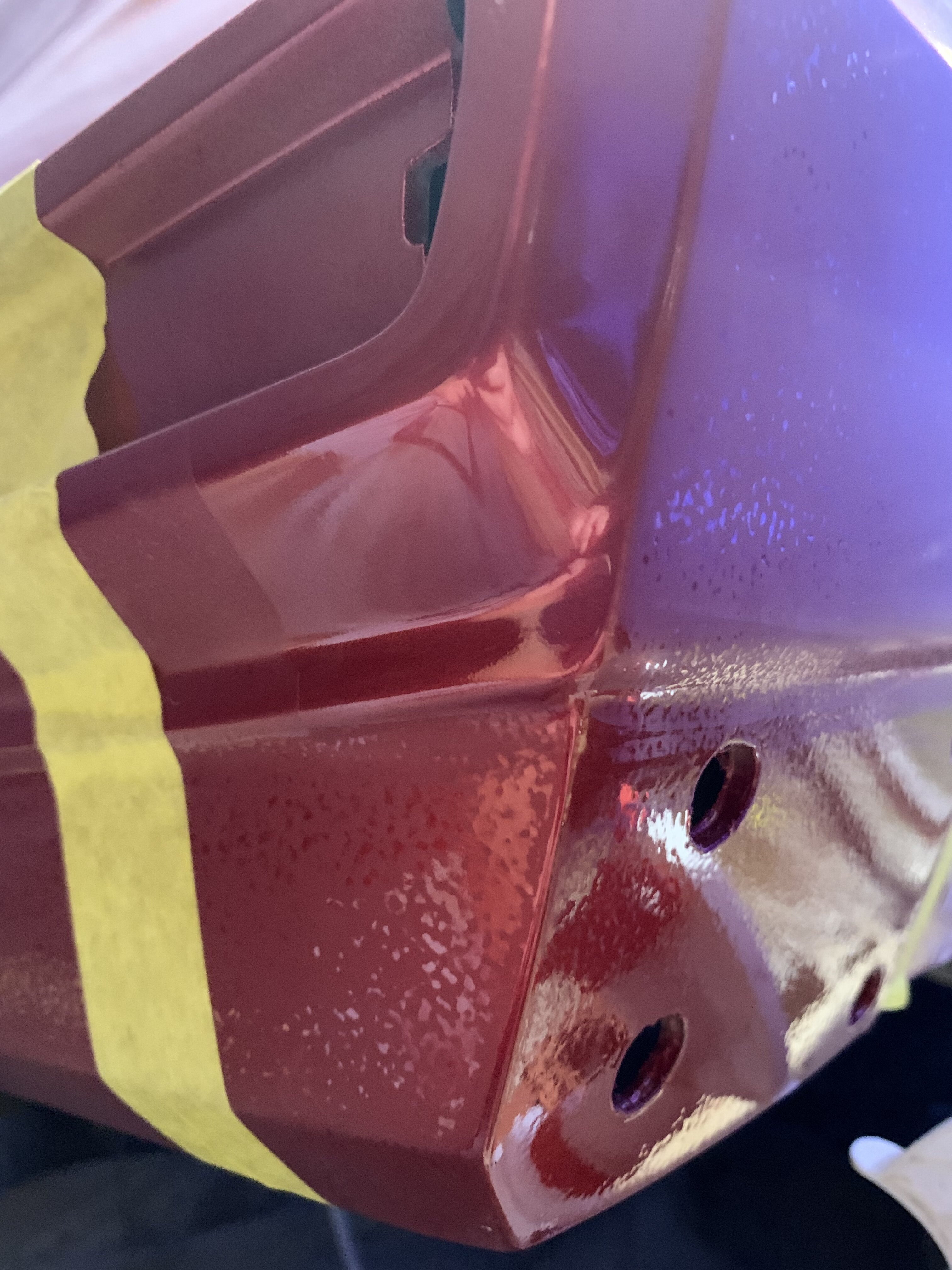

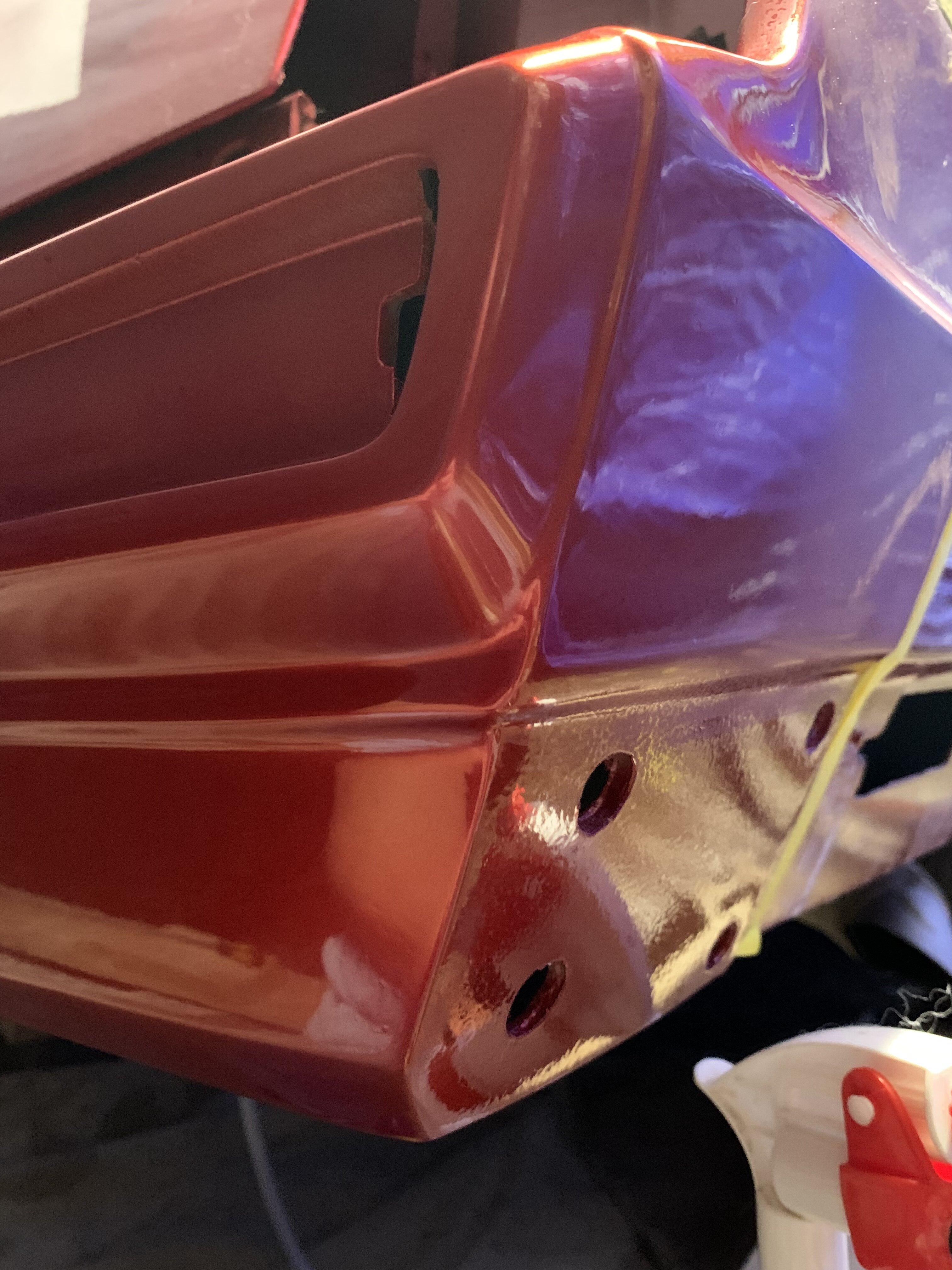

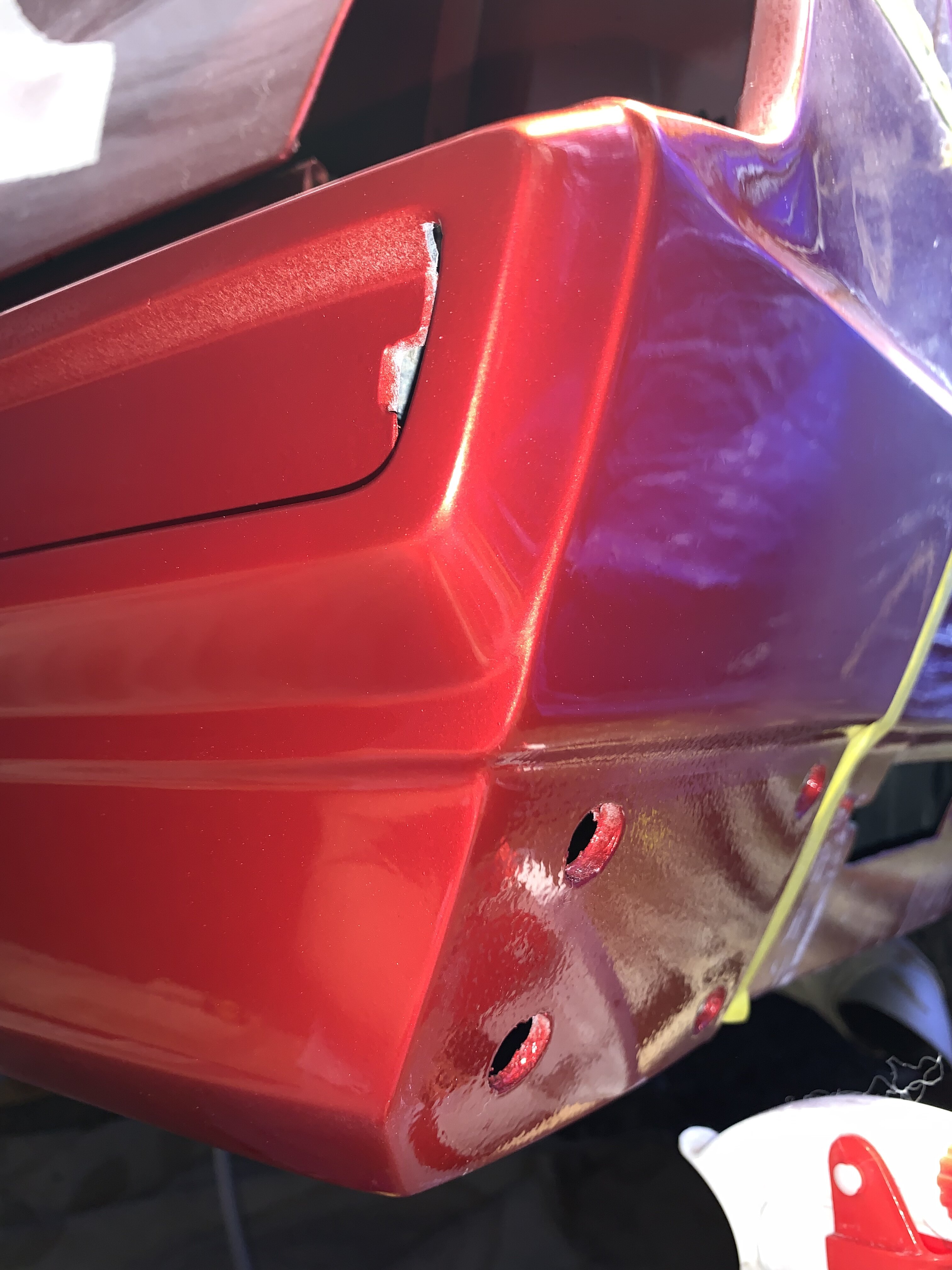

Polished the section of the rear bumper I tried to blend a couple weeks back- got a confidence boost from this one.
Might experiment next spring with just clearing over some sections with a slow reducer. Over-reduced this batch of clear to 15% (UreChem recommends a limit of 10%) with a medium grade reducer at the lower end of its temp range, didn’t peel off when I buffed it, so it adheres to 800 grit scratches nicely. And with a minimal blend edge at that.

Glad to see it worked out for you! Hopefully my advice was at least somewhat helpful. It looks great.
