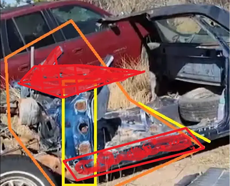

I'd recommend you cut 3 pieces off what's left:
1: a 5 or 6" tall strip starting just below the brake booster hole and up to where the cowl tag attaches, all the way to the left and right where you cut the pillars;
2&3: between outer rocker and into the downwards drop in the floorpan on each side.
Why? Repop floorpans don't go all the way to the rockers, and, some cars rot just above the brake booster or just above the climate box.
Those patches take up almost no room in a garage, but save a lot of fabrication time if you or someone else needs them. Nobody is making them to my knowledge right now.
if I'm understanding you correctly, basically cut off everything above the brake booster hole/cowl tag, and above where the top door hinge mounts, because we don't need it? (like I colored in red)
and then cut off the rockers on both sides, just below the lower door hinge mount, down to the floor pan, because those are needed and not re-pop'd? (like the ones I circled/painted in red)
that will leave me just the two cutoff rockers, and then the essential part of the firewall, which makes a total of 3 pieces. is this correct?
When I look at my car on the floor pan where it’s rusted and more so the rail going all the way front to back seat area that the floor pan gets attached to inside of the rocker. I would say take all that as a piece because that’s what’s needed that they don’t make yet. The a pillar attaches to the top of the hinge pillar above the top hinge and at the bottom where it curves into the rocker they do make that corner also.
Half right. The rocker areas yes. The cowl, opposite.
That strip circled in cyan can be two patches, left and right side. Just above the brake booster where the firewall slopes upwards is a rot location. Likewise, where the climate box attaches to the firewall.
I've had a number of cars I ended up parting out with holes just 2 or 3 inches above where the master cylinder passes through the firewall. They were all northern cars, and, every one had sat for at least 2-3 years of time, but, they were also all only about 12-15 years old at the time.
