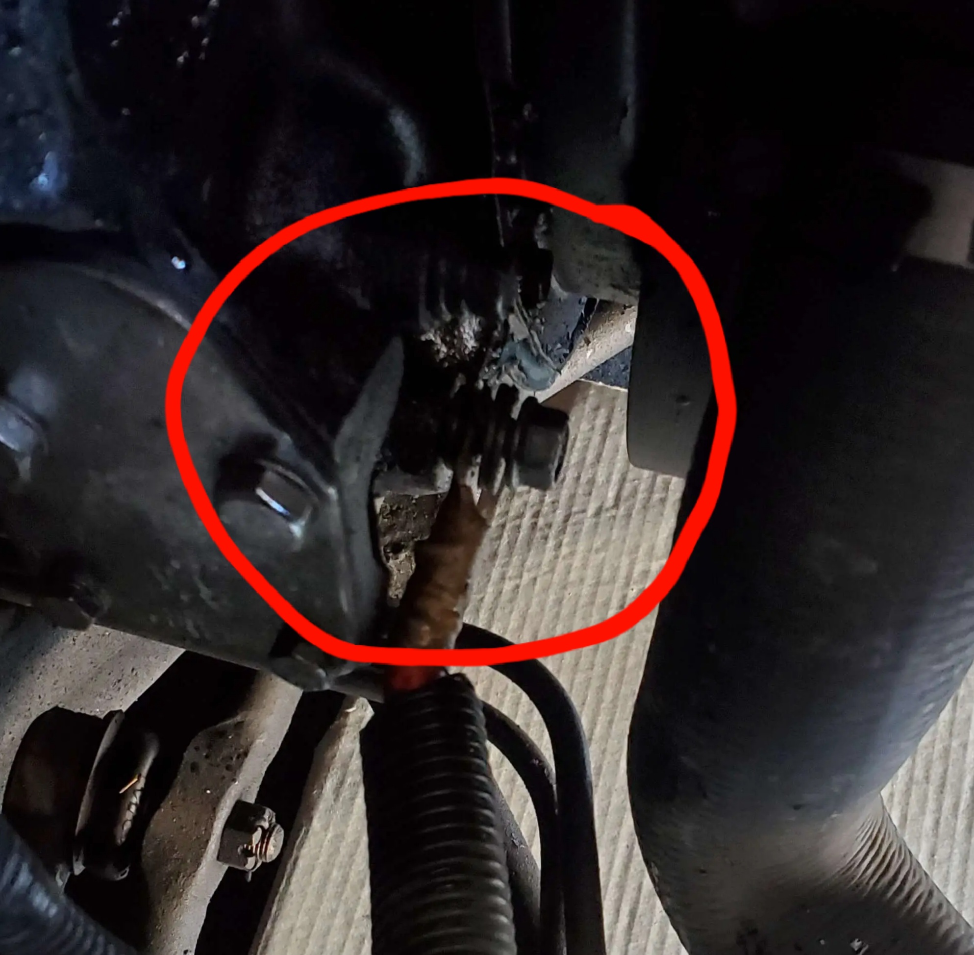

Umm, have you taken a good hard look at the pic of the block ground?
mclellan83 how much does that jiggle when you grab that..
That was taken as I was loosening it to test for continuity
At that point it was jiggling quite a bit because it was almost off to test
