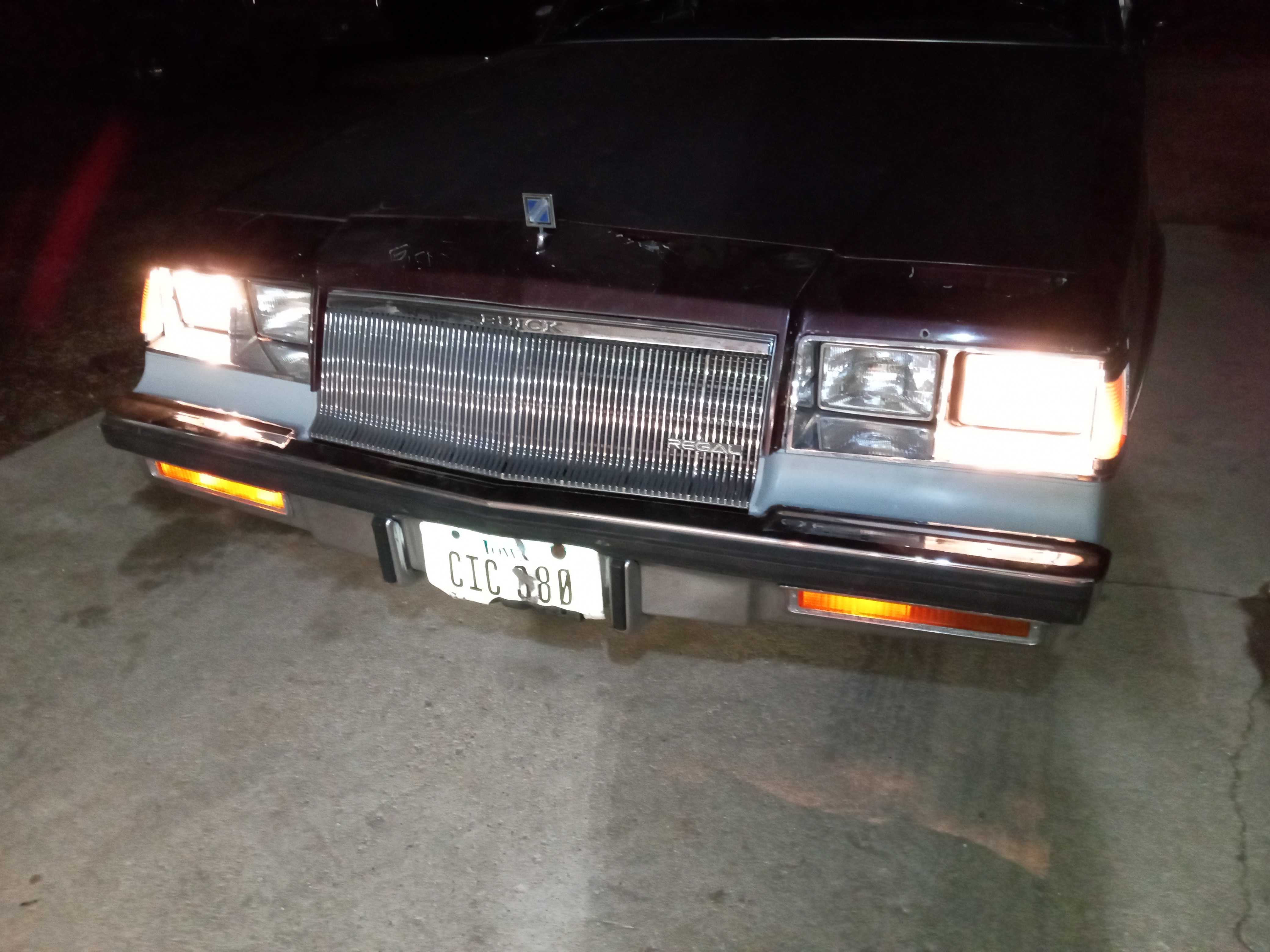

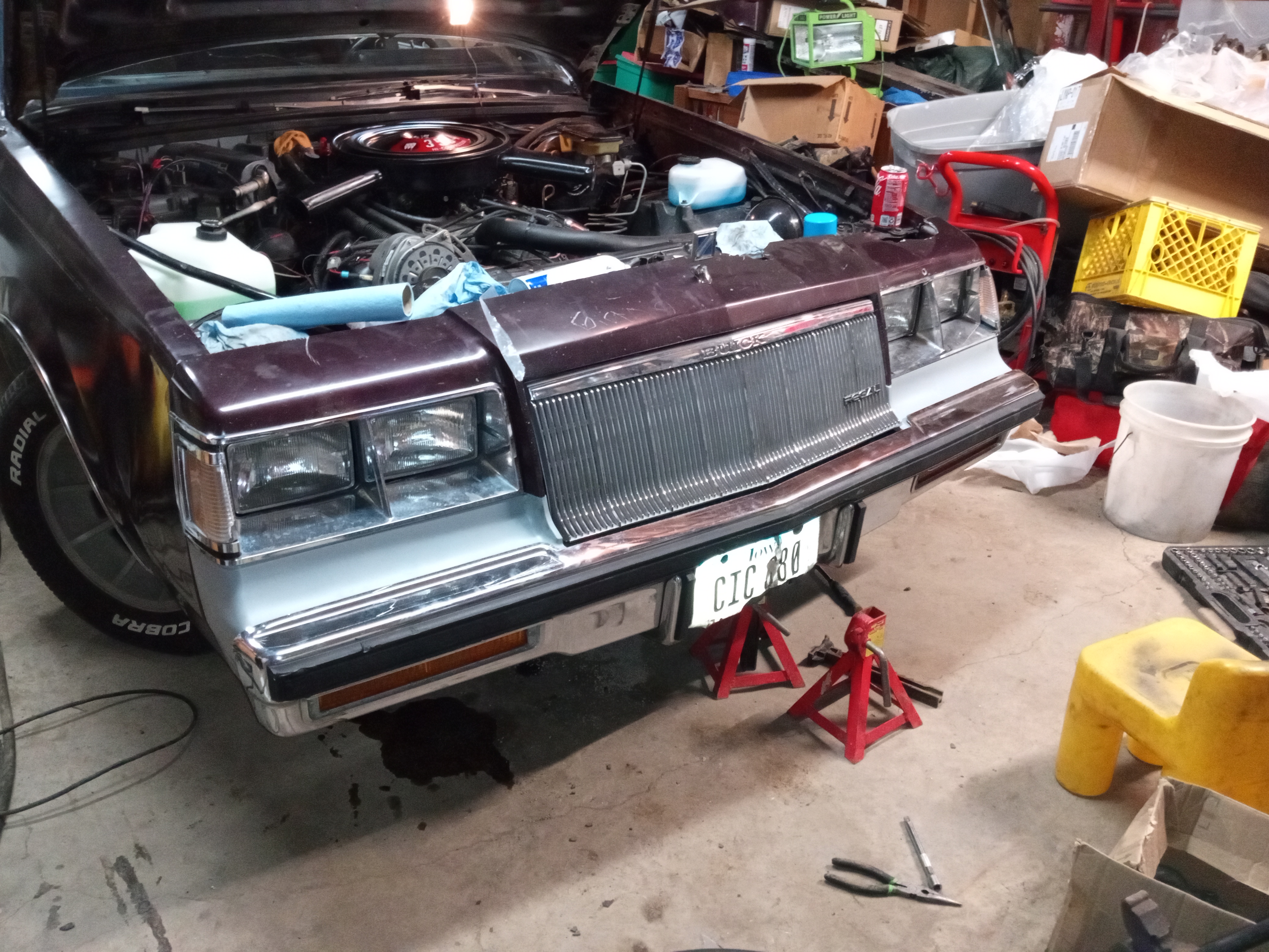

Installed the new front fillers. Doesn't help fenders are bent (previous owner said it was hit by a plow on the DS front), and from me jumping it and daily driving it aggressively for 10 years.
Fit is as expected, meh. Better than holes.
