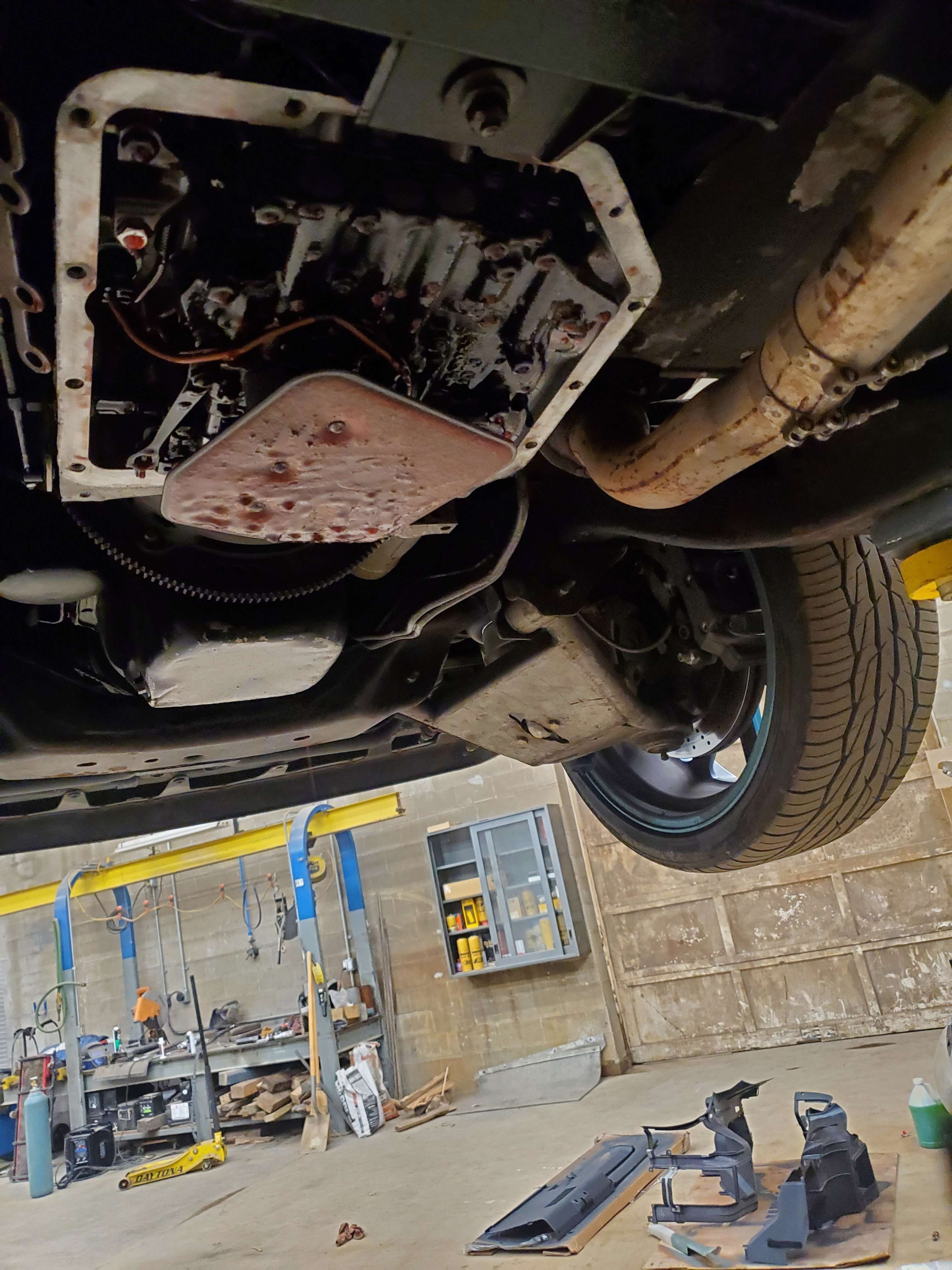

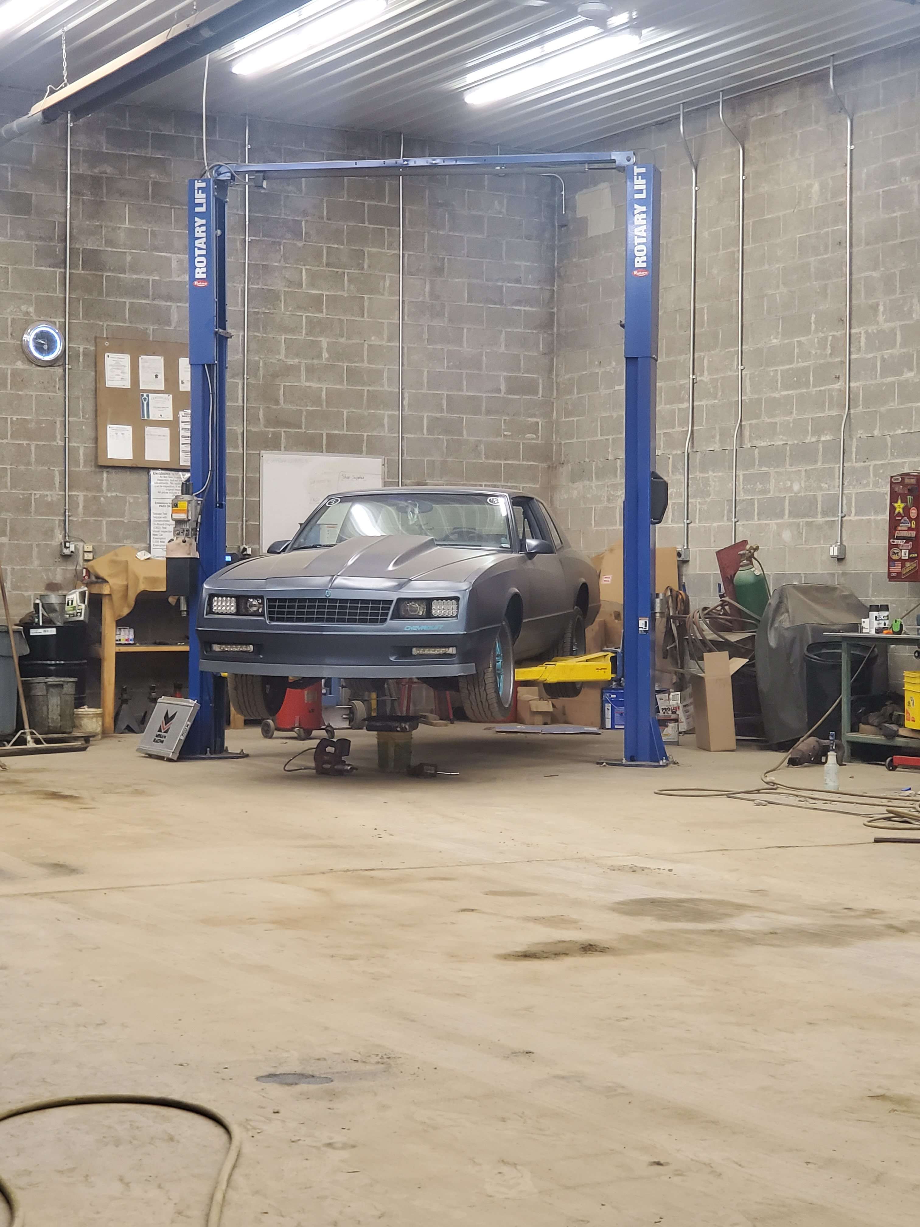

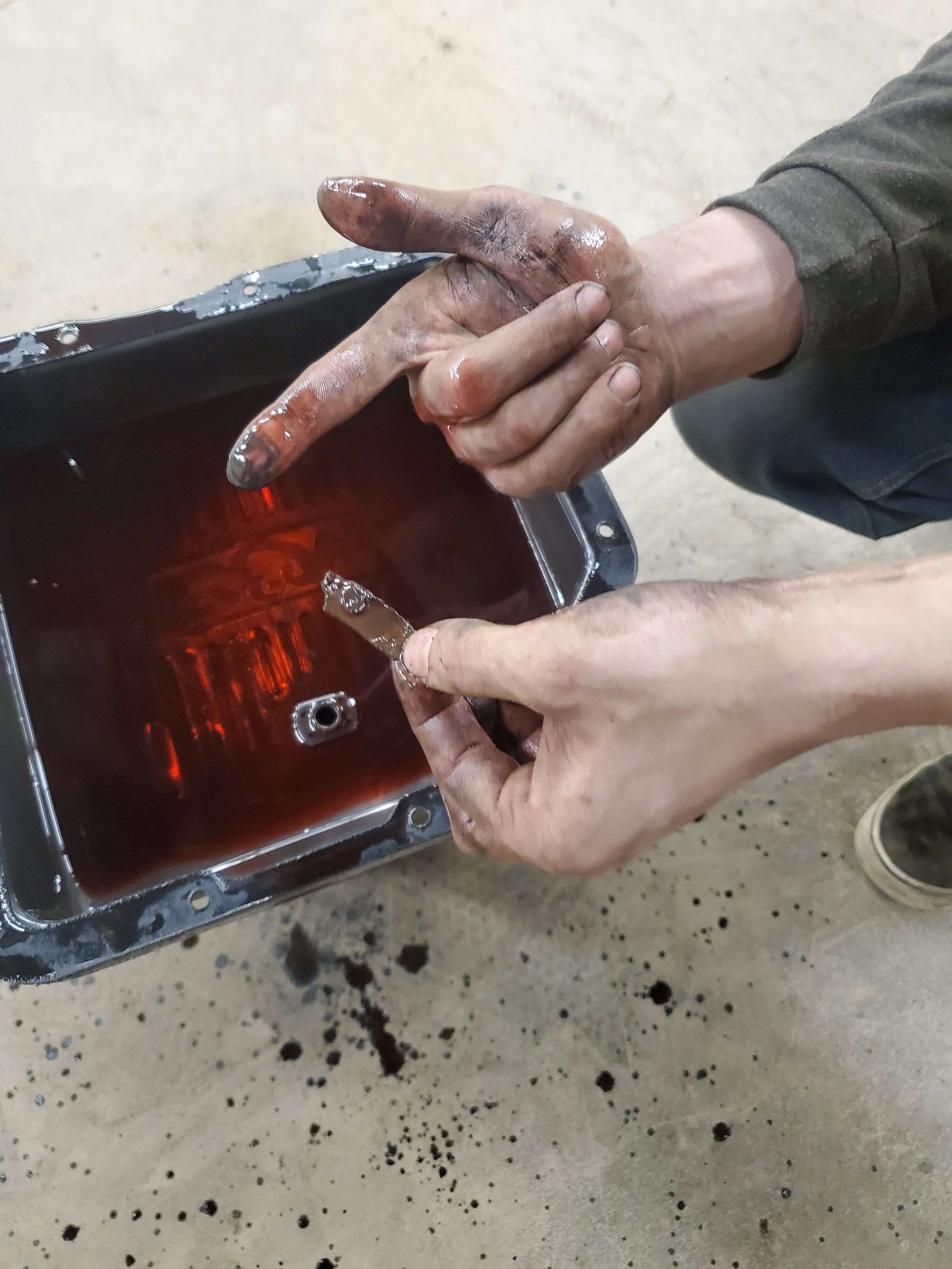

Welp got the ol girl up on the lift to pull the pan and it was worst case..... time for a rebuild right before the season starts. Was really hoping that wouldn't be the case especially with the GTO also needing transmission work. The last place we used that we didn't love cause we ended up having to send the whole car down there for them to get the transmission right said 800/900 if we pull the transmission and 1100 or so if they have to and around 2 weeks. Gonna call around a couple other places to see where they are at on price and time, I guess gonna make the most of it and it replace the rear main seal and get a new oil pan since they both had some leaking

The grey "silt" on the pan bottom is sediment that to me indicates the friction discs may have just about reached the end of their working lives. Had a 350 TH like that; 1st was okay, 2nd was marginal, and 3rd was fine. You pull away, be in first, hit second, for about 10 seconds at the most, then be in third almost immediately. Had a good T-box waiting for a drop and I waited too long. Kept the box and threw the hulk away. My old 78 M/Carlo.
Would it be simpler to just get a reman or maybe something from the aftermarket or is this a case of wanting to keep that case 'cause it is original to the ride?

Thats where I had kept going back and forth, part of it is that if I change up I would rather go manual in it. But have many other things setup around the way it is, I don't know much about whats in the engine so the converter is a question to me as well. Figured when I send it to get rebuilt they can know more about the converter and what to use. Not to mention its almost half the price and able to get it in almost the same time from the guy that seems to be the best rated around

Got it pulled after work last night, dropped it off this morning. Somehow 3 work days turns into Monday with you know you are in the business with parts supply, which is very possible but also very much used to push dates when you don't want to get it done ASAP. So we will see I am gonna call and follow up on either tomorrow or the day after to see. Gonna order a new oil pan and gasket by days end so I can hopefully have that also ready to go so maybe she won't leak anymore
