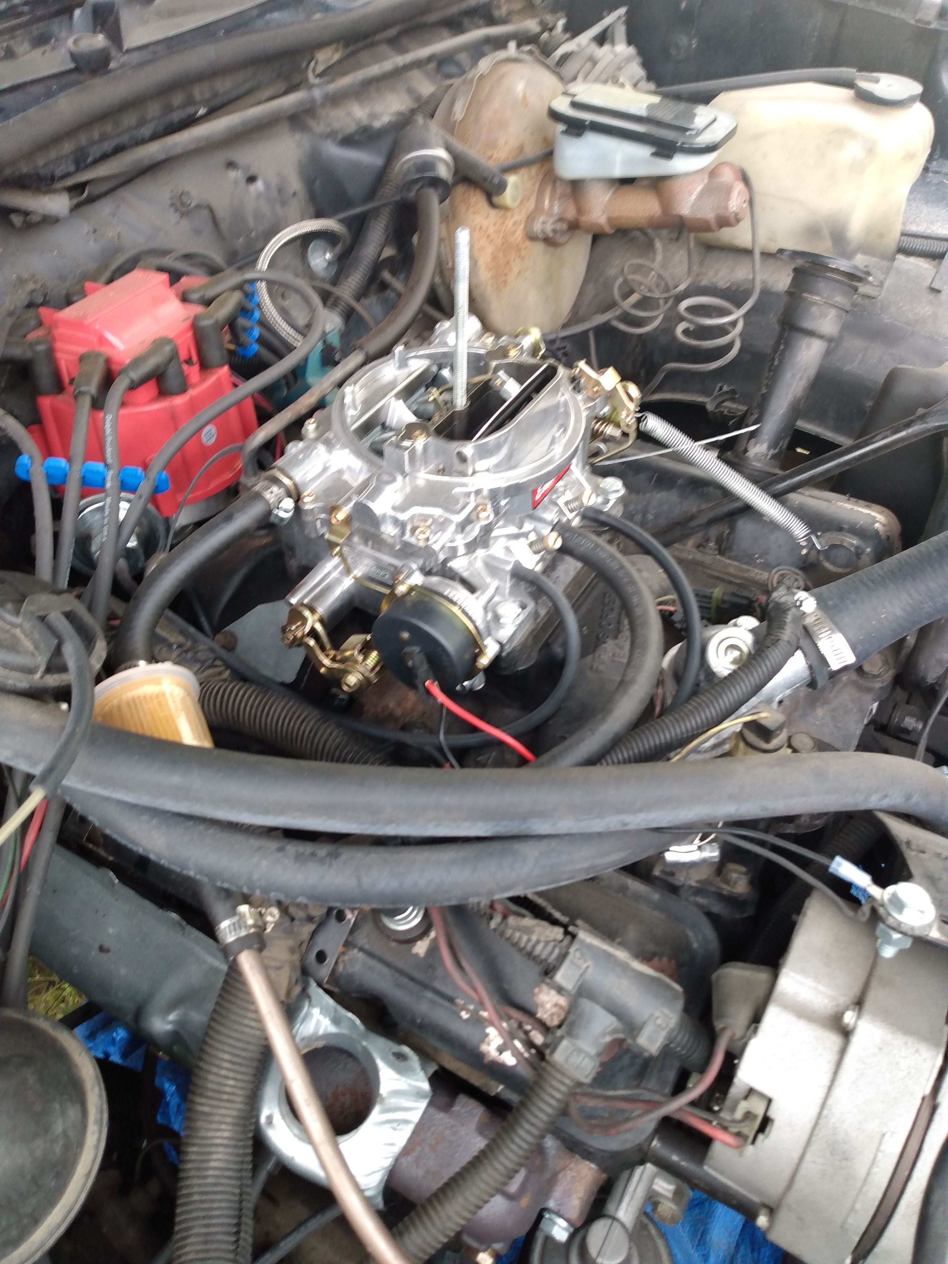

There was a lot of gasoline in the oil (Pictured), finally got around to changing the oil I also added Engine restore to that oil as well. Choke was stuck wide open while I fixed that problem awhile ago. Another springs up, I don't have Acceleration or Throttle response on the pedal, I've been fiddling with Choke Adjustment and Air/ Fuel mixture screws, I don't suspect other causes. View attachment 224244
Been fiddling around with the Choke Adjustment. I got some pedal response back but not much.
You can literally see the Gas coming out of the oil Pan.
do you know the reason for the gas in your oil?
Your engine is a 350, right?
If that’s a 1406, it needs tuned. My old Edelbrock ran pig rich all the time. Or you’ve got a leak, mine would drain the bowls overnight.
No it's a 305. I grabbed the cheapest Carb I could find from JEGS it's a Edelbrock 600CFM Carburetor with Electric Choke
. Carb Leak?. . . I'll look into it.
That shouldn’t be too much carb, it’s a bit large for a 305, sure, but I don’t see how that couldn’t be remedied with an Edelbrock tuning kit like this one:
Before all that though, go through the basics.
Check timing and make sure your fuel pressure isn’t above 5 psi on it. Install a regulator if need be.
Easy way to find a leak is to take the carb off and put it on a stand or bench vise, put a couple ounces of fuel in it and let it sit.
Now I’ll caution you, my carb was likely screwed up, as no carburetor should drain fuel out overnight with no airflow through it. So while I suspect it, it’s an unlikely culprit.
Go the tuning route first.
Cool! Thanks. I got the link save back for when I can afford to get it. Research leads me to Needle and Seat not closing the way it should, or Float levels are off. Either way I am not experience enough in Carburetors but I know someone who is, I'm going to give them a phone ring ASAP.
