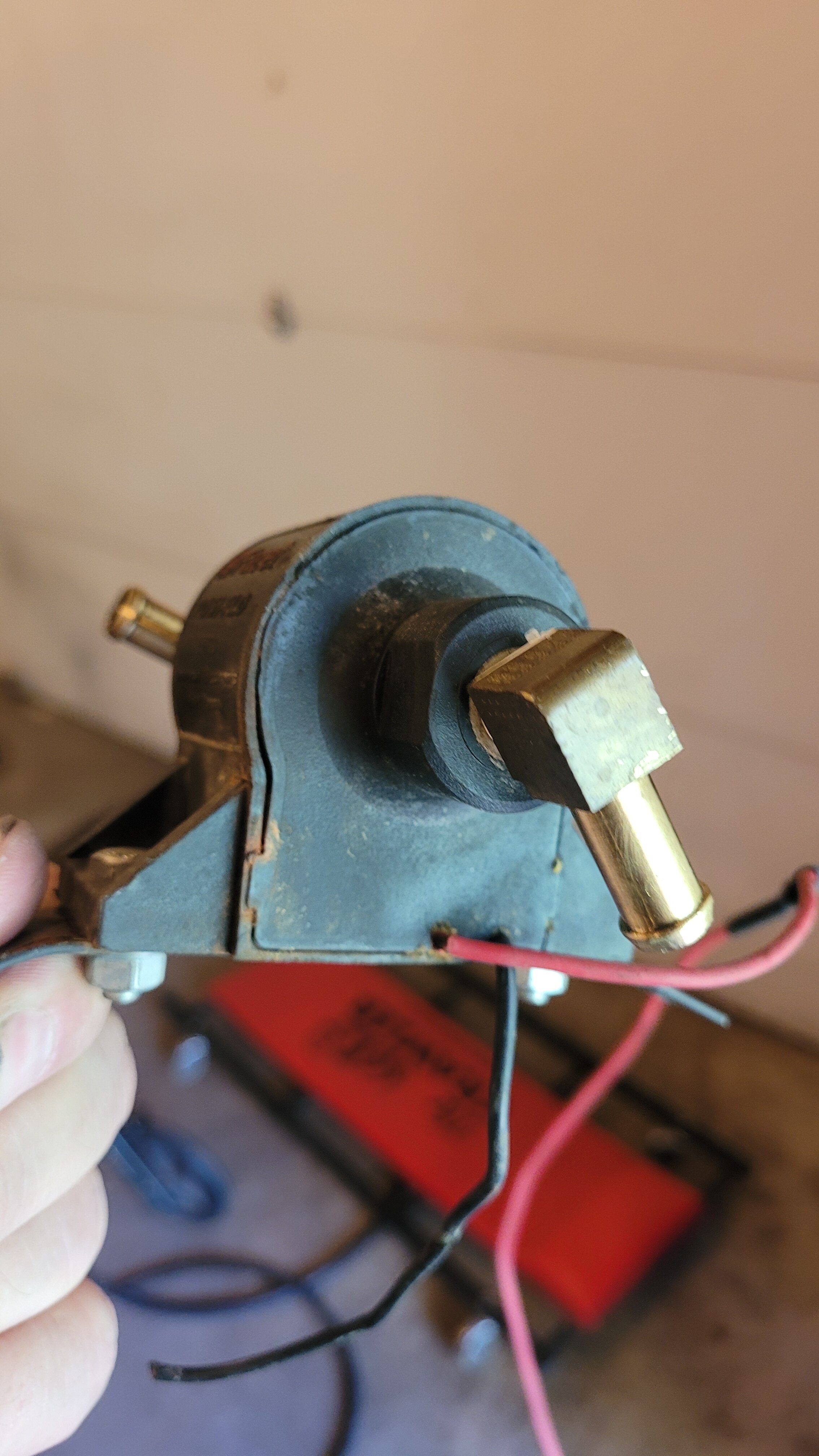

While checking around under the hood, I found a fuel line leaking at the carburetor inlet. Turns out that the line split down the length, and even cutting back about 8 inches wouldn't get me to good hose.
This line is only about 9 months old, and supposedly rated for ethanol. Seeing this, I went ahead and checked over all the fuel line in the system and found another bonus. The electric fuel pump was apparently weeping out of the side of the case as well.
I'm guessing from the rust that it may have been weeping for a while. I guess it will be parked until I get a new pump in the mail.
I just wish I could find a reliable source of actually good fuel line.

While checking around under the hood, I found a fuel line leaking at the carburetor inlet. Turns out that the line split down the length, and even cutting back about 8 inches wouldn't get me to good hose.View attachment 224562

That I can totally believe. The line that was on there came from AutoZone, but it did have the correct labeling for Gasoline. This current length of hose came from NAPA, but it didn't have any writing on it at all and I don't feel that great about it long term.
I may have to pony up and order some line rated for methanol since I am super not into dying in a fire because of a cheap hose.
That's assuming you need 3/8". Gates barricade hose. Rated for gasoline for carb engines (50 psi rating), 100% methanol (not for methanol blends, though) and all ethanol blends.
That could be on the shopping list, as unfortunately the plot thickens in my fuel system. I have been having to run a second fuel pump in the engine bay as I have been having problems getting enough fuel flow to keep the bowls filled during spirited driving. I figured that with a new fuel pump, I could delete the secondary pump and be fine. That turned out to not be the case, so I highly suspect my feed line on top of the fuel tank has started to rot out and let air in ahead of the pump. The thought of dropping that tank in the middle of swamp-*ss summer does not excite me.
