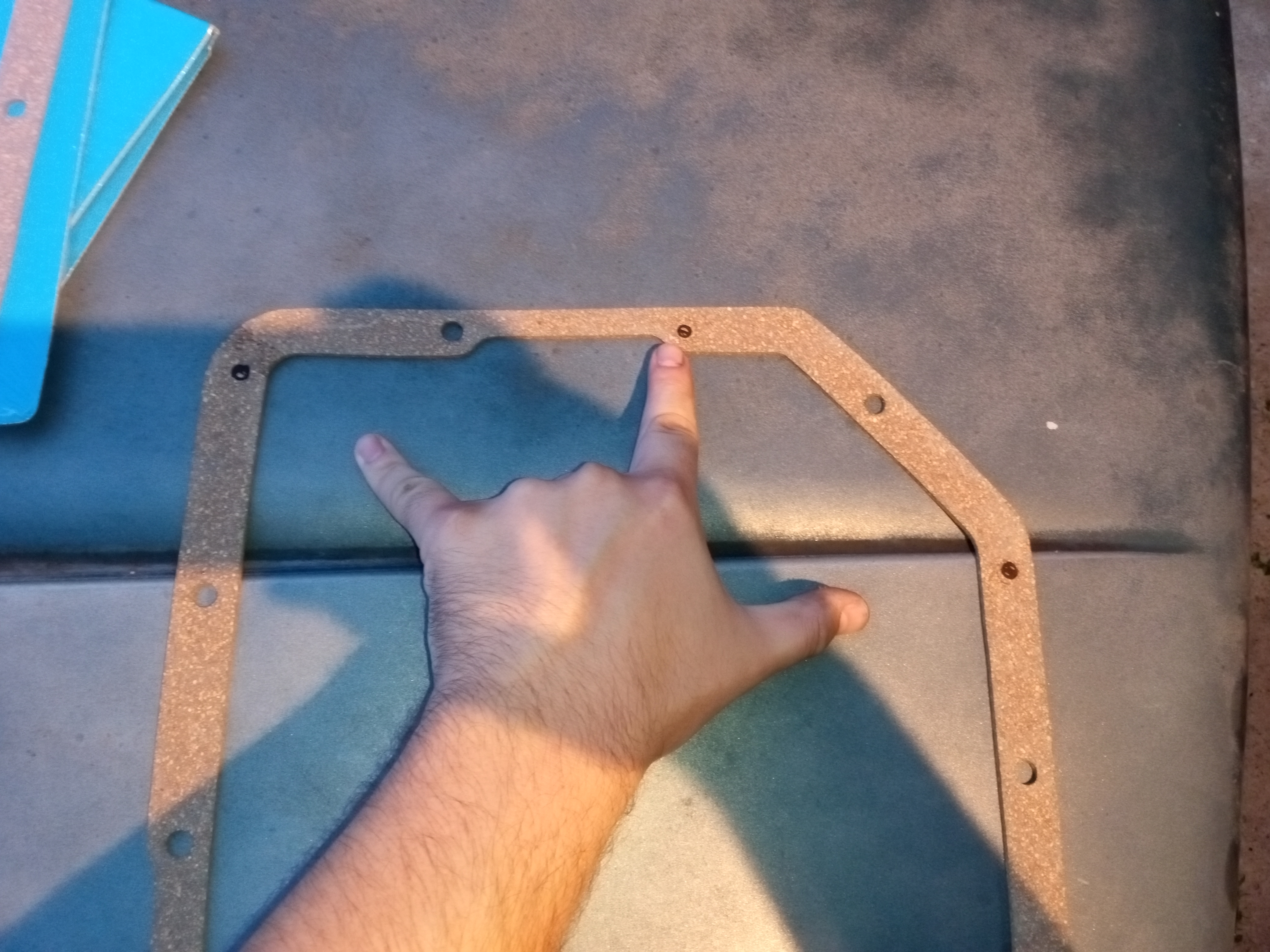

Went to change my th350 pan gasket for the 5th time, still probably going to seep through the gasket like it always does, but the ****ing gaskets I got from rock auto (victor reinz) didn't have all the hole cut out. Wtf? I've never ever had that happen before. All 3 I got have unpunched holes in different spots.
Can't get nothing that works anymore.
The ones I'm pointing to I sharpied for punching.
HUH. If'n y'all don't mind me asking, what are you using for gasket adhesive or sealer? For myself, if the gasket is cork, my long time favorite go to has been Permatex Spray a Gasket. Comes in a small spray bomb, shoots sticky/gooey and dries tacky. I have been able to remove gaskets shot with the stuff intact, resprayed them, and re-used them, although my preference is for new whenever possible. Used the Permatex on the pan gasket on my 700R4 and it is still dry. You can see the red of the spray along the edge of the gasket where it peeks out from under the pan rail.
The other thing to look for is the holes in the pan themselves. Being sheet metal they can dimple or deform into a concave shape if the bolts were ever over tightened in a past life. They can be dollied back flat to the pan using the flat face of a ball pein hammer or s small length of rod stock and the same hammer. Having them flat lets the ribs on the pan rail make contact with the gasket first and put on squeeze on it.
One possible option would be a gasket that comes with the holes fitted with sleeves, like the ones available for engine oil pans. The sleeves limit the amount of crush or compression that can be applied to the gasket material and help prevent blowout.
Stop messing around cork gasket and buy one of these https://www.amazon.com/dp/B003YLIGI0/?tag=gbody-20
