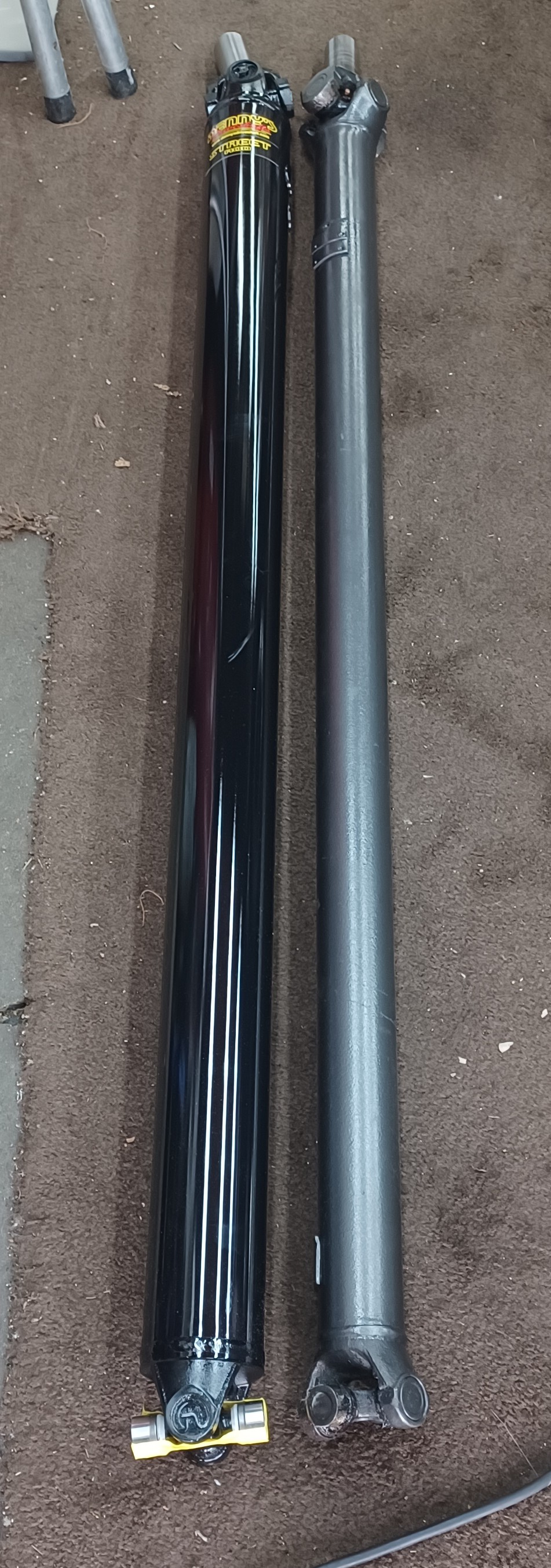

Well my Denny's driveshaft finally came for my Regal so I got that installed Today and the fit was perfect and very nice quality.
Side by side with my stock one. I actually needed one about an inch longer to work with the QP 9".
They do great work. They built us driveshafts for my brother's Camaro, Dad's Galaxie and my GP.
