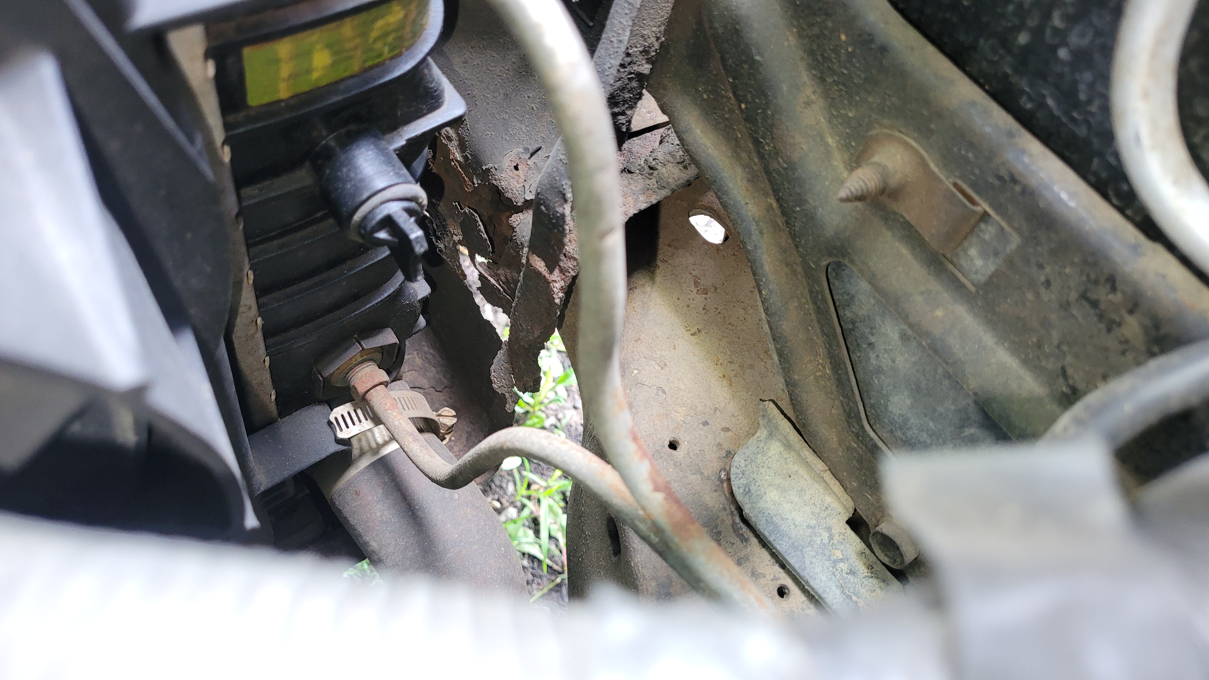

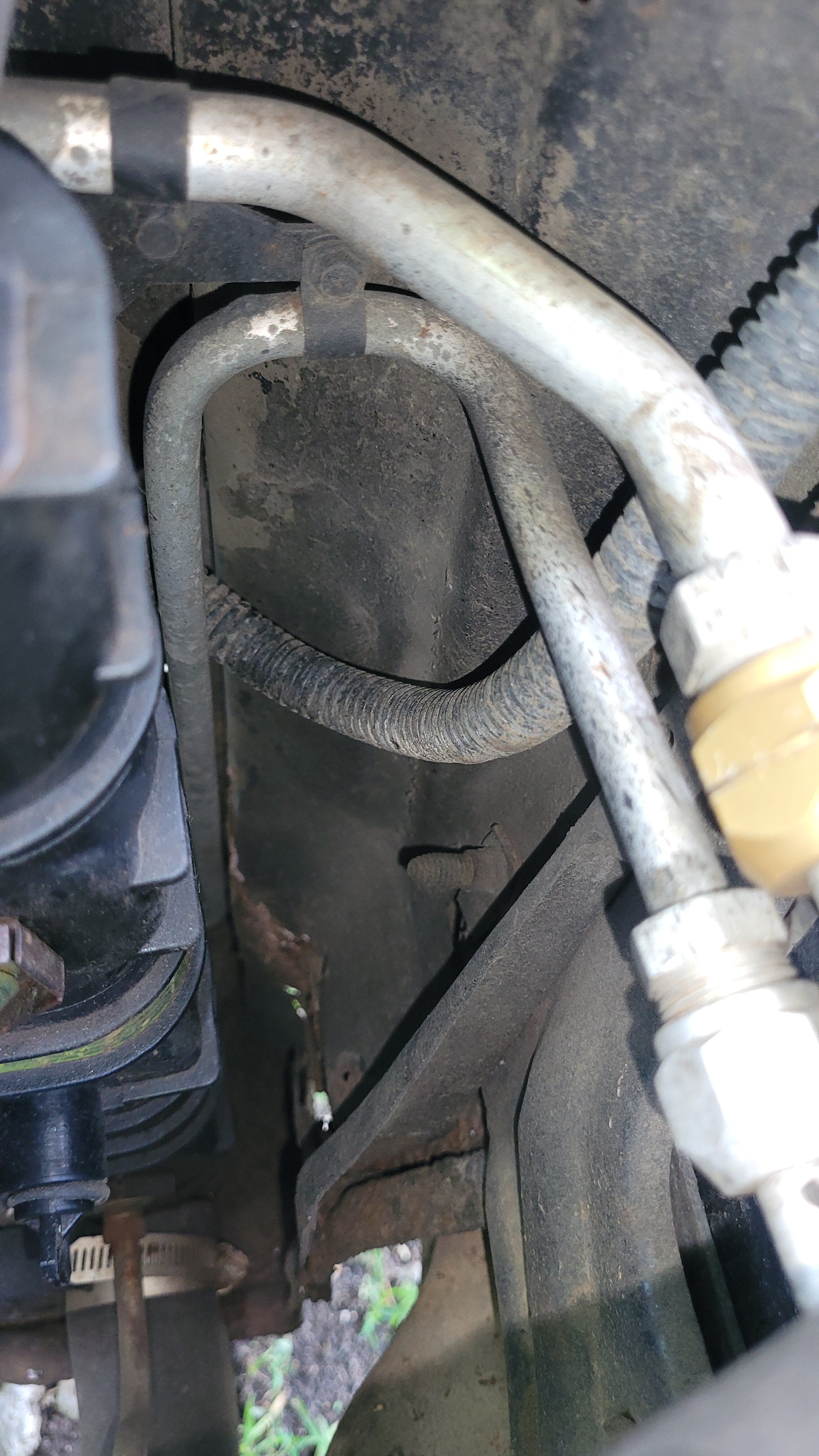

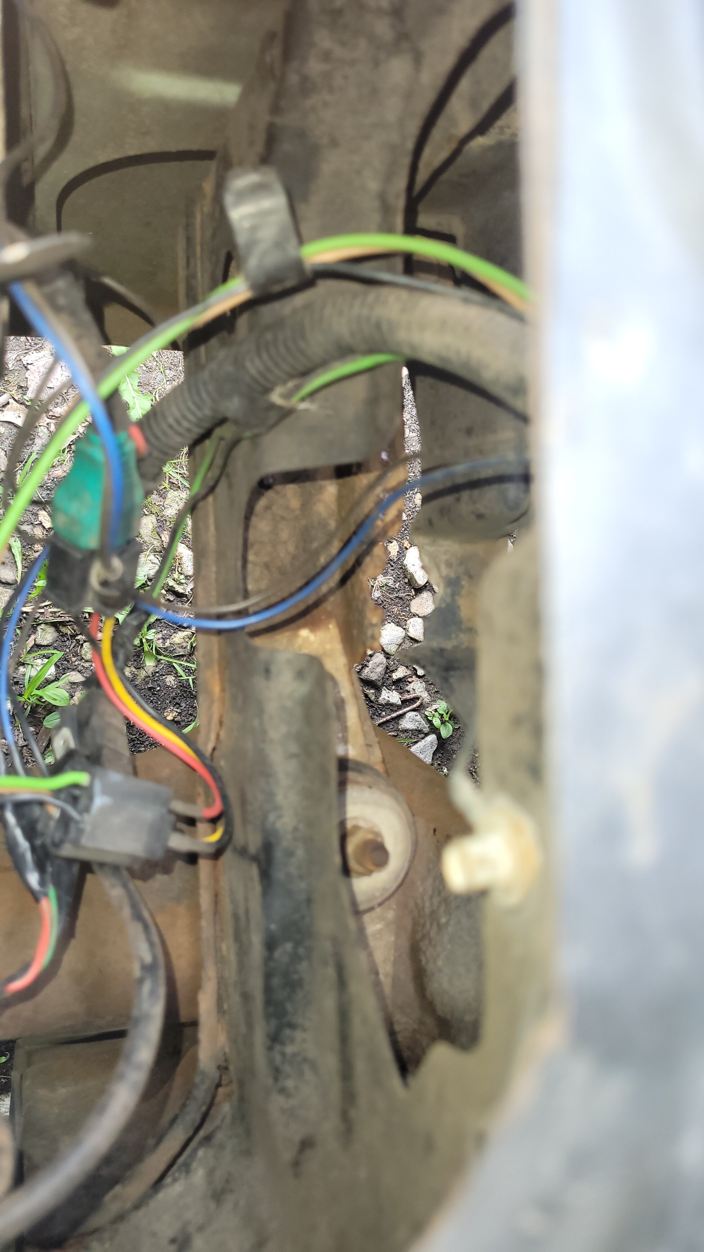

Looks like my whole passenger corner of my core support has broken away from the the rest of itself.
Guess I need to start hunting for a new one.
Yup. The passenger side of the cradle is where the neck for the rad is also located and spillover and general moisture and crud can easily combine to create tinworm-itis. Lost the original cradle out of my 85 that same way. The one in it now is from my 78 Monte and was a plug in that I scored from a 78 Cutlass cause the 78 Monte had suffered the same destruction.
