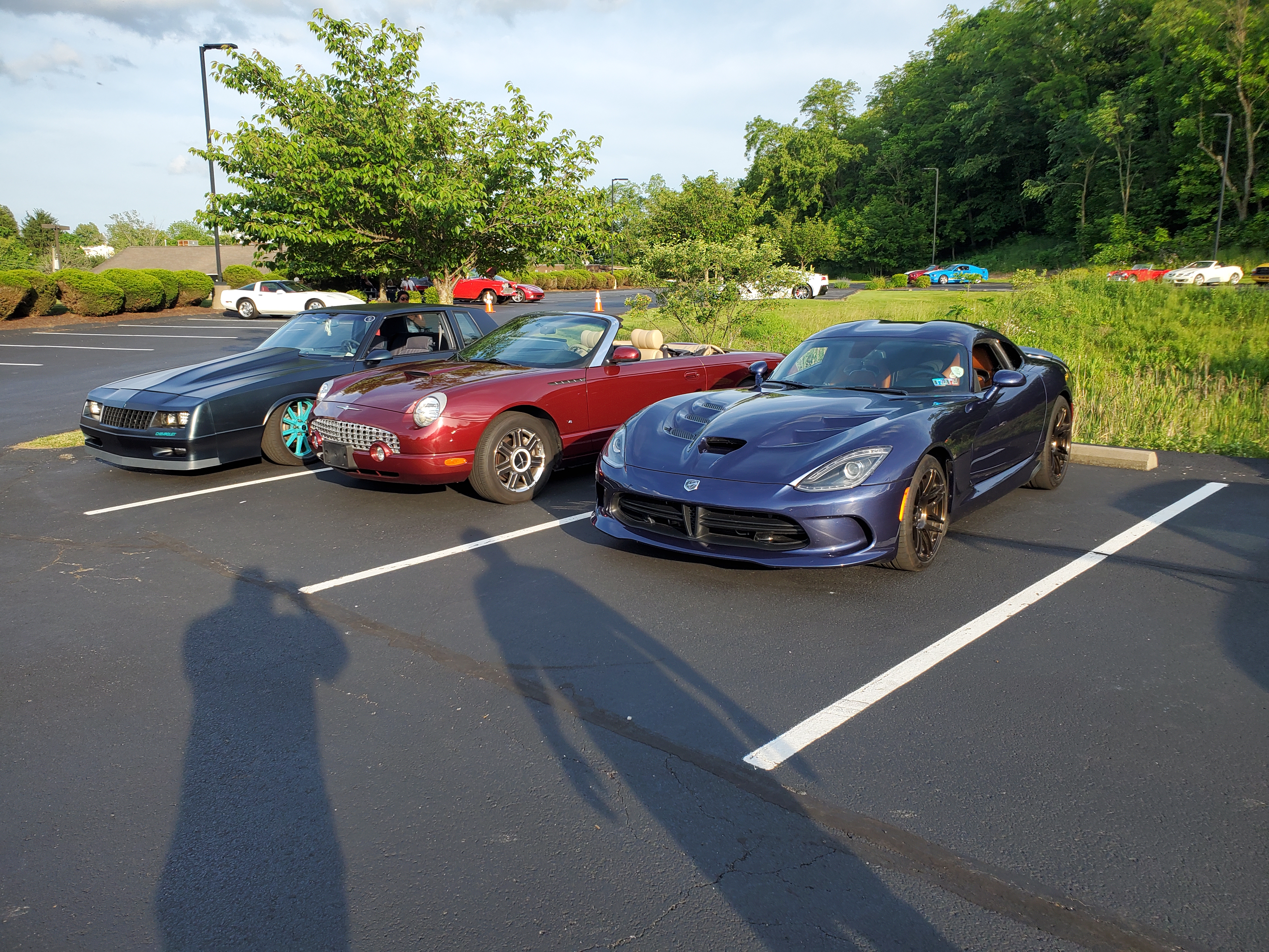

Went out and met a buddy and his wife at a showing, ended up being very productive. Took him for a ride to hear what I still think is a small exhaust leak and it falling on its face in the mid range. He did some research and figured out that it is actually the coil failing, before that research we discussed changing out the plugs due to possibly being fouled. This would answer a lot of the weird stuff I was having, when I pulled the wire off the coil last night oil came spraying out so had Atech warranty it out this morning and got another brand so I can put it in the car tonight and take it out while having the other as a backup.

View attachment 239865View attachment 239866
Do I spy a light blue '71 Monte in front of your car across the parking lot in the first pic?
