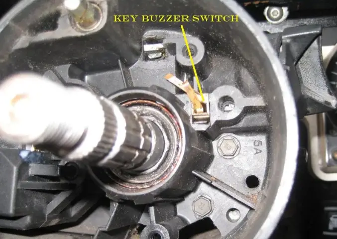

Ignition Key warning switch for the chime module when you leave key in the ignition and open the door.
GREEN wire comes from chime module, up into the steering column through the little key warning switch contacts (closed with key in) and the TAN wire goes to the driver door jamb switch that's closed when doors open.
I didn't think the KEY IN chime/buzzer was an optional feature but maybe it was depending on the years/model?
Maybe the DIRECTIONAL SWITCH in you steering column is not correct, or been replaced or someone pulled the wires?
Here's a pic what it looks like, the two little metal tangs contact the underside of the DIRECTIONAL SWITCH and into the wiring and connector you're referring to.

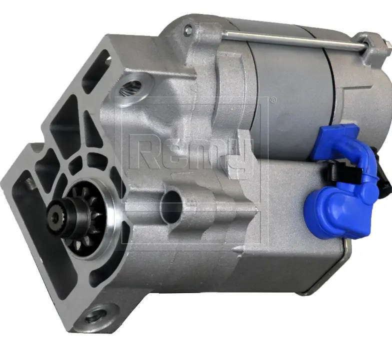

Busted my rear at work for the last 3 days for some OT, then moved on to fitting the Powermaster starter I bought back in the spring. Fits well, but it grinds when the engine first fires off. I know these gear reduction starters don’t rotate the small amount required to retract the bendix like a direct drive one, but this seems odd. May require an extra shim or two.
I hated the powermaster mini starters, never could get the shimming happy, either in/out to the ring gear or to the block. Did all the PM required checks for tooth clearance and it still made weird noises that always sounded terrible.
If this is a SBC with 153 tooth flywheel you may want to think about using a 90's style OEM LT1 starter instead. Buick Roadmaster, Camaros/Firebirds, Impalas, etc..It's a factory mini starter that fits with most headers and retains the nose cone to support the shaft and gear drive. I've had one in my 10.5:1 compression 383 for 8+ yrs with no issues.
There is also a Corvette LT1/LT4 mini gear driven starter from the 90's era that's even better (see below) but I couldn't get it to fit with my ARH headers, and it's not clock-able.
Just something to think about if you ever decide to get rid of the PM starter...figured I'd share my experience.
Don't forget about the special bolts. You need part # 14037733 and the long one is 12338064.
Ah yes, great point!! When I bought mine, they actually included the bolts with the starter, that's great info!!
Thanks!
For as long as I can remember there was no key buzzer, even before swapping in an aftermarket steering column. Does have courtesy lights that haven't worked in years. FWIW it's a '79 Malibu wagon model.
I've been running Jegs Hitachi-Style Mini Starter 555-10011 for close 20 years on various SBC/BBC setups with both flexplate and flywheel 153 and 168 tooth variations
Never had to shim any of them.
Also drive gear is/should be beveled to help engaging without grinding.
Or I miss understood and the starter is staying engaged after started for a little bit?
Unfortunately I’m running a 168 tooth flexplate, so I can’t use the LT1 starters. There is the 96-2000 Vortec truck starters though, which I’ll pick up a spare if I can’t get this 9012 Powermaster to work properly.
No shims had it sounding rough, like it was forcing itself to turn. A 1/32 shim freed it up substantially, although I haven’t checked the backlash on it.
It does sound like it’s staying engaged but it’s only once the engine initially fires, it’s not like it’s continuing to run on.
