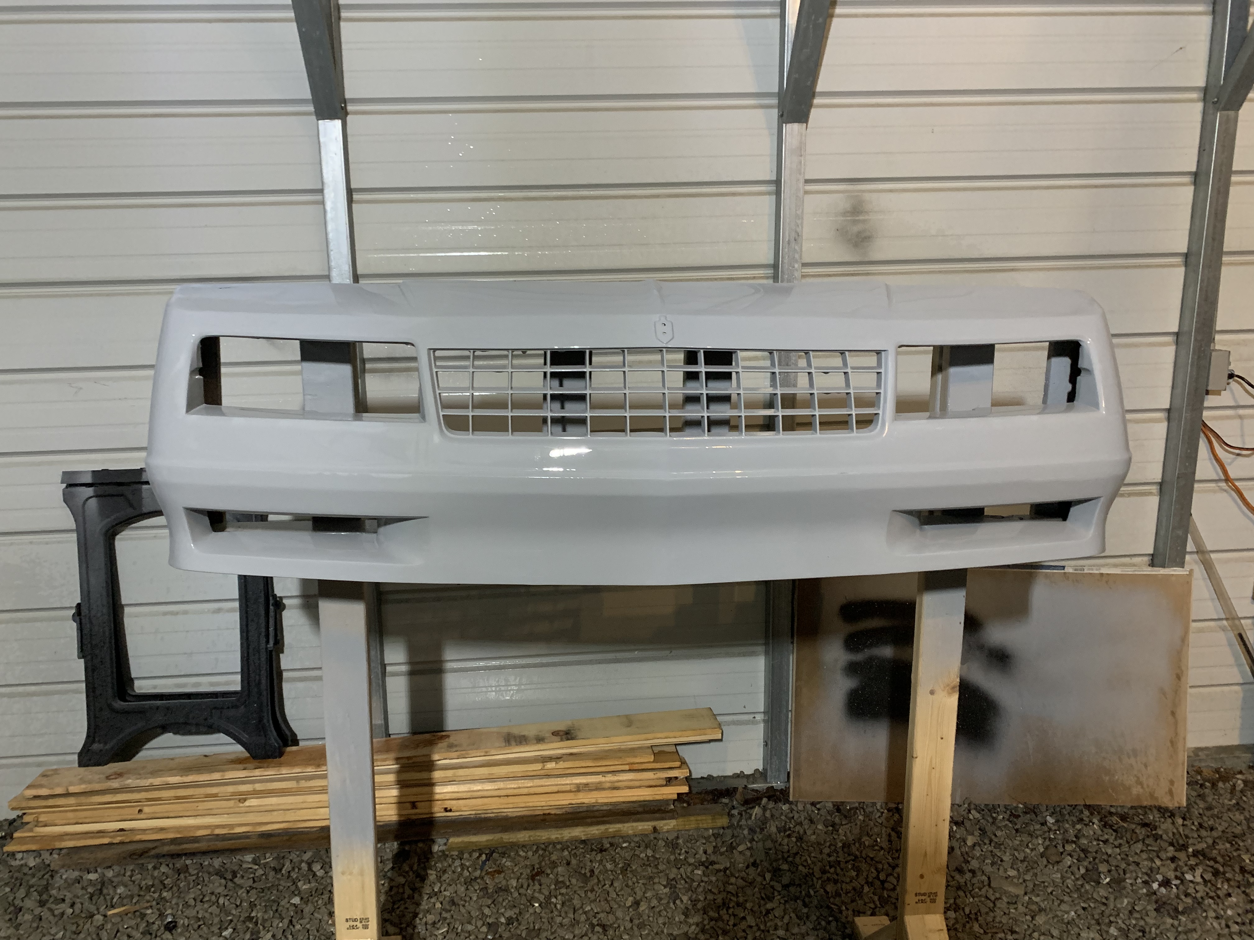

Busted my rear at work for the last 3 days for some OT, then moved on to fitting the Powermaster starter I bought back in the spring. Fits well, but it grinds when the engine first fires off. I know these gear reduction starters don’t rotate the small amount required to retract the bendix like a direct drive one, but this seems odd. May require an extra shim or two.
With that tackled, I moved back to wet sanding the nose at 10pm:
It didn’t come out half bad, but in the process of sanding the orange peel out, I burned through on the main body line right beneath the lower right of the grill to the rough base that was on these noses to begin with. Couldn’t sand it flat, so I sprayed a small patch, but put a sag in the epoxy since the humidity skyrocketed in the afternoon.

I think I’ll need a straight jacket to keep me from sanding body lines 🤣
In all seriousness, great tip. I’ll keep that in the back pocket for the other SS nose I’ve got. It needs some straightening out in the body line department, as it saw a repaint at one point with an apprentice going after it with a rabid DA sander….
