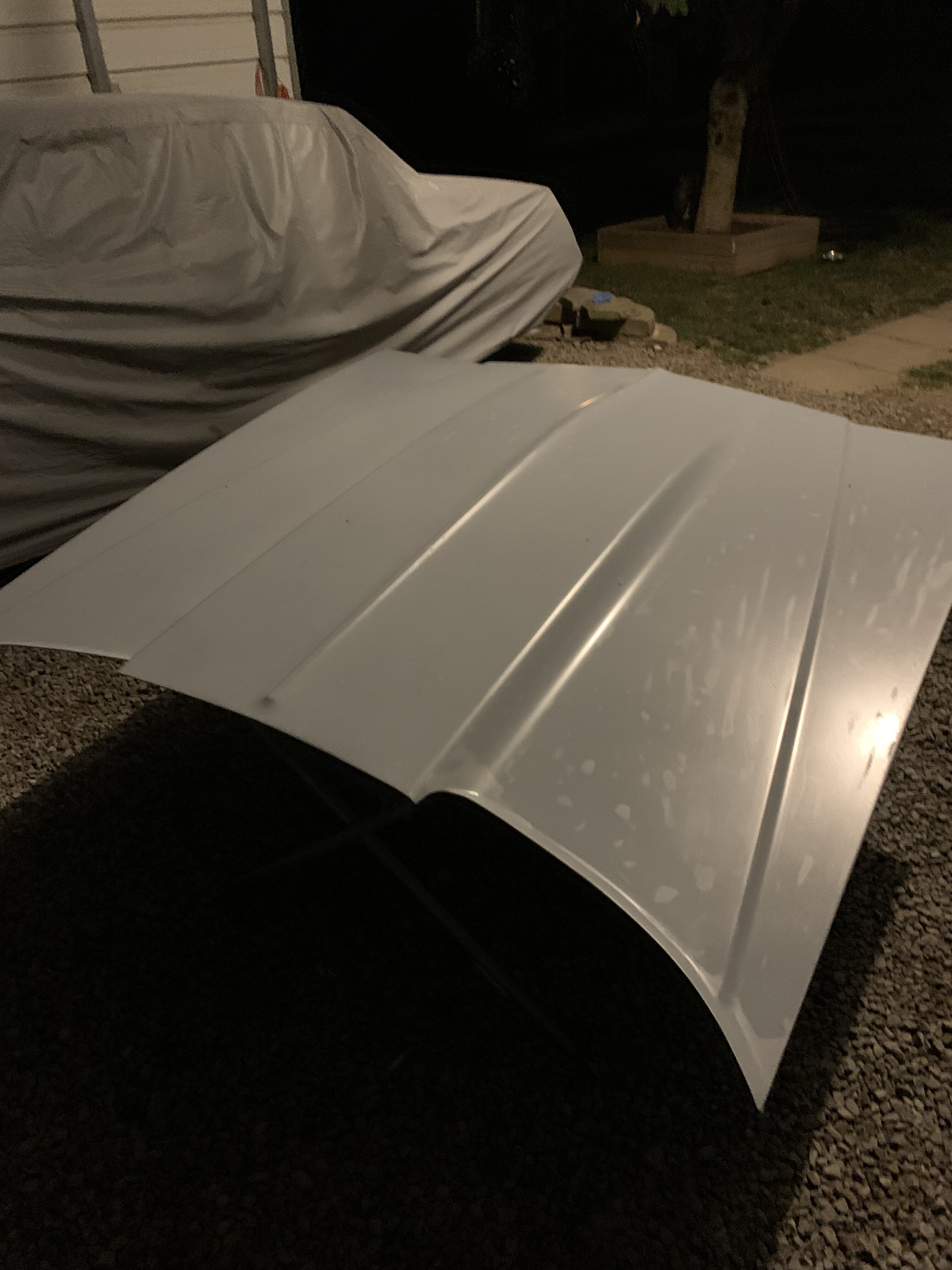

Learned the hard way to never paint over E-coat again.
Had just enough epoxy primer left to mix for one coat. Anywhere there was black E-coat left on, rust was starting to poke through.
Stripped down to bare metal and primed in 3 hours. I’ve officially had enough for one weekend.
that's a tough one,you did the rite thing though.i've seen that myself and justifying stripping it off to managment was even worse.they would ask "can we return it for another one"..(they're so far removed from it all..)there's a bit of marketing to be had with ecoat,i remember way back seeing the uber cheap aftermarket parts with claims on the packaging "900 hours of salt spray tested"..
