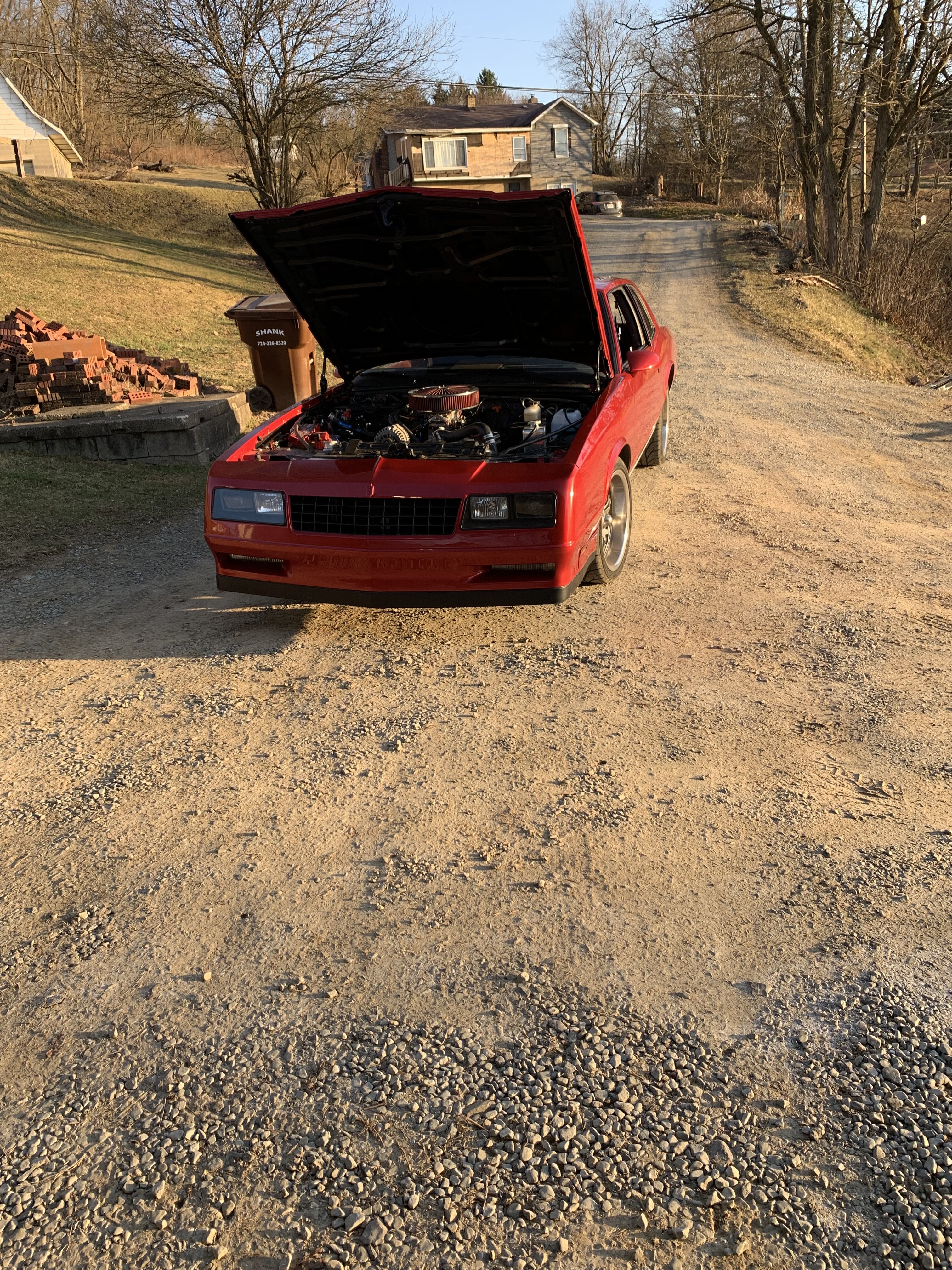

Supposed to be really nice tomorrow, so I figured I’d drive it once or twice before I ripped it apart again. Made some changes to the carb over the winter that fixed a stumble at low speeds, but can’t check how rich or lean it is at cruise since the wideband sensor croaked.

The car ran fantastic! In the morning at least. Ended up needing to stop a few places after work, and en route to the second stop, the car just died. Wouldn’t restart, starter was obviously getting hot from the headers. Thought it was the fuel pump but I found it to still be running while I was stuck in the turning lane next to the shop, so I gave it a pump or 2 and managed to get it to start and stay running long enough to pull it into the parking lot to cool off thanks to a good samaritan stopping traffic for me.

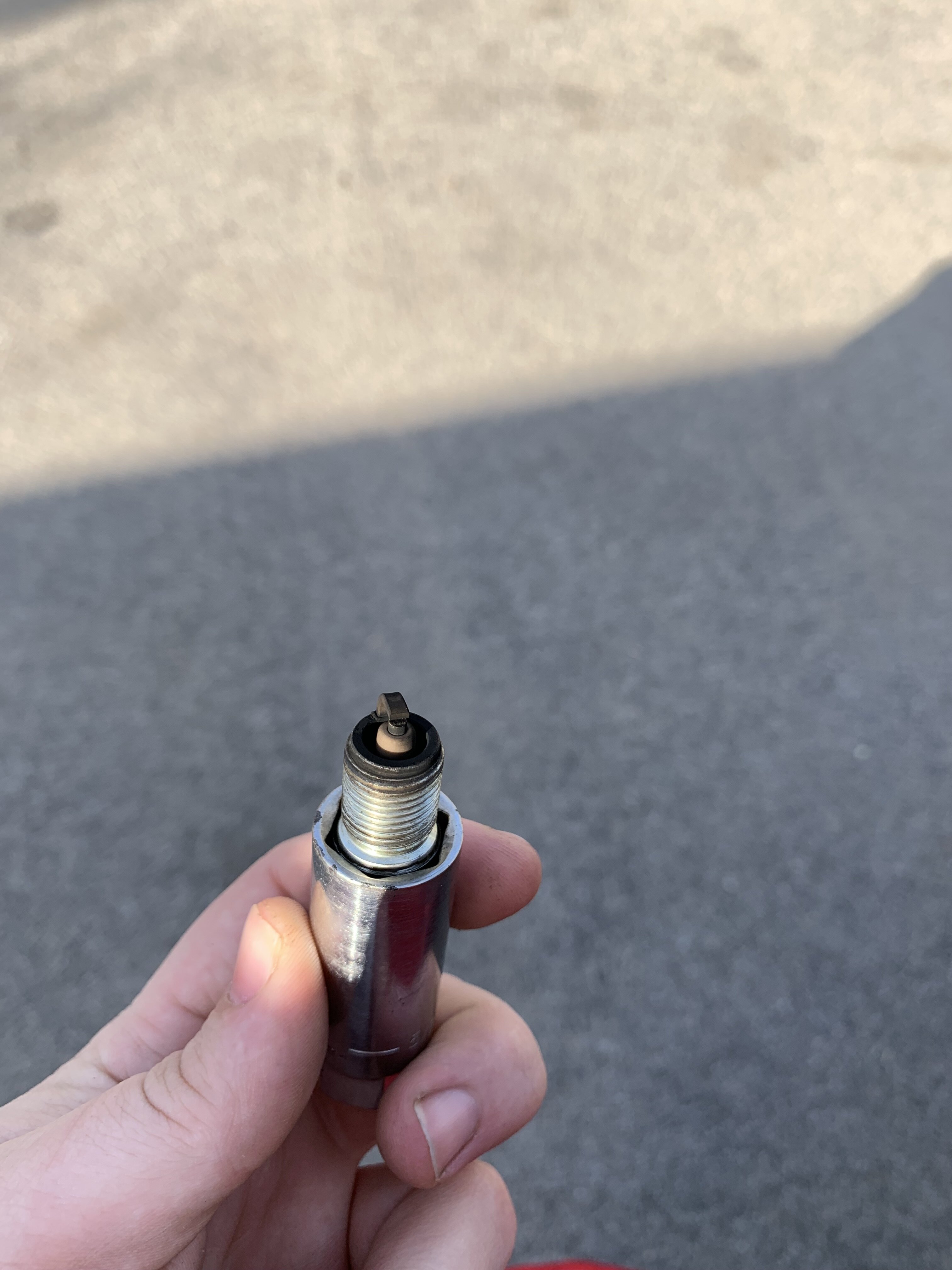

Pulled #1 plug after the headers cooled off enough to mildly scald and it didn’t look too bad to my untrained eyes:
Still changed all 8 out with a slightly hotter set, and the car started like nothing happened. Possibly a fuel boiling issue, I can tell it’s bogging at stop lights more than it usually does, dropping about a hundred extra RPM, so it might need scoch more on the idle screws.
