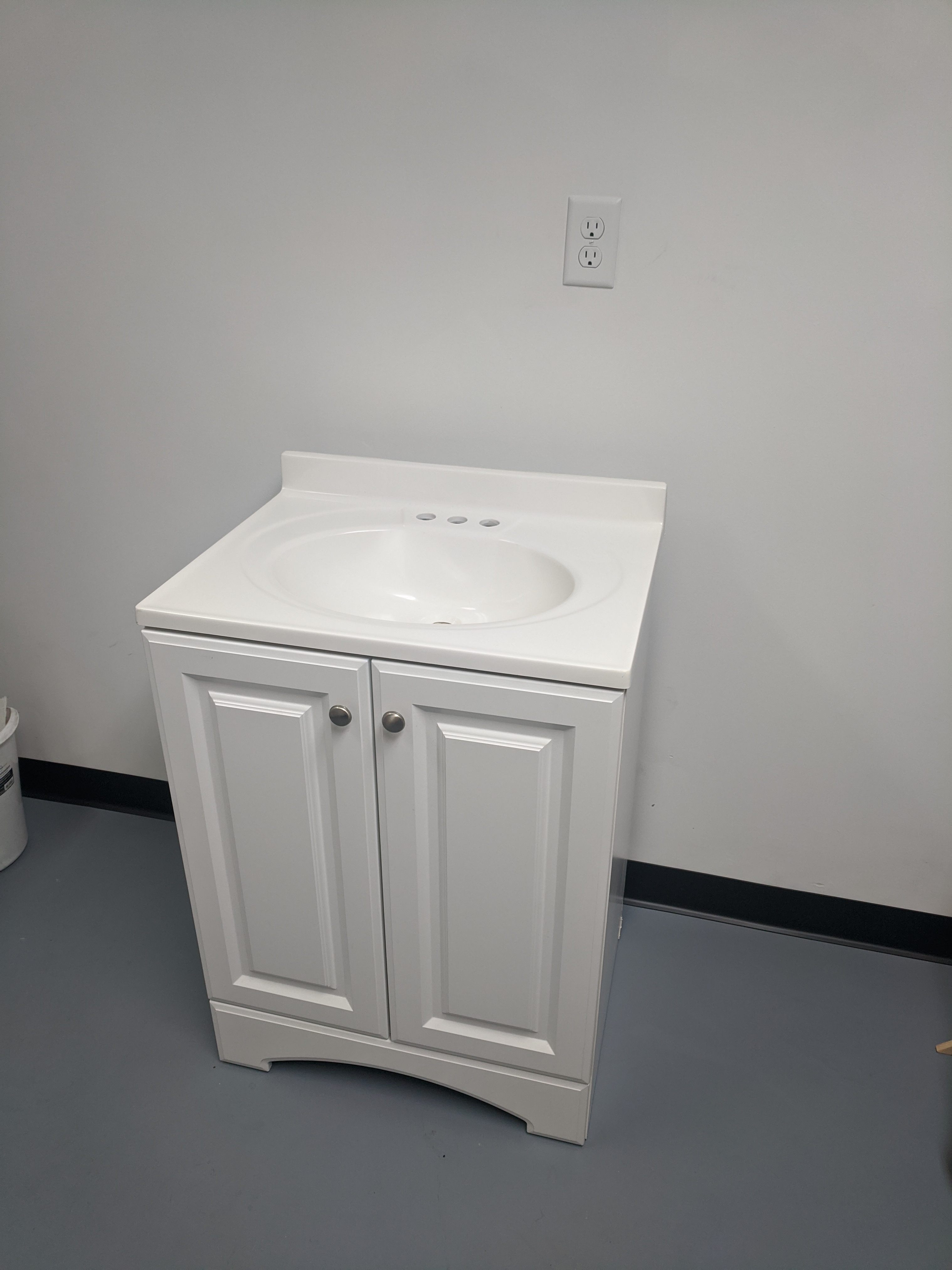

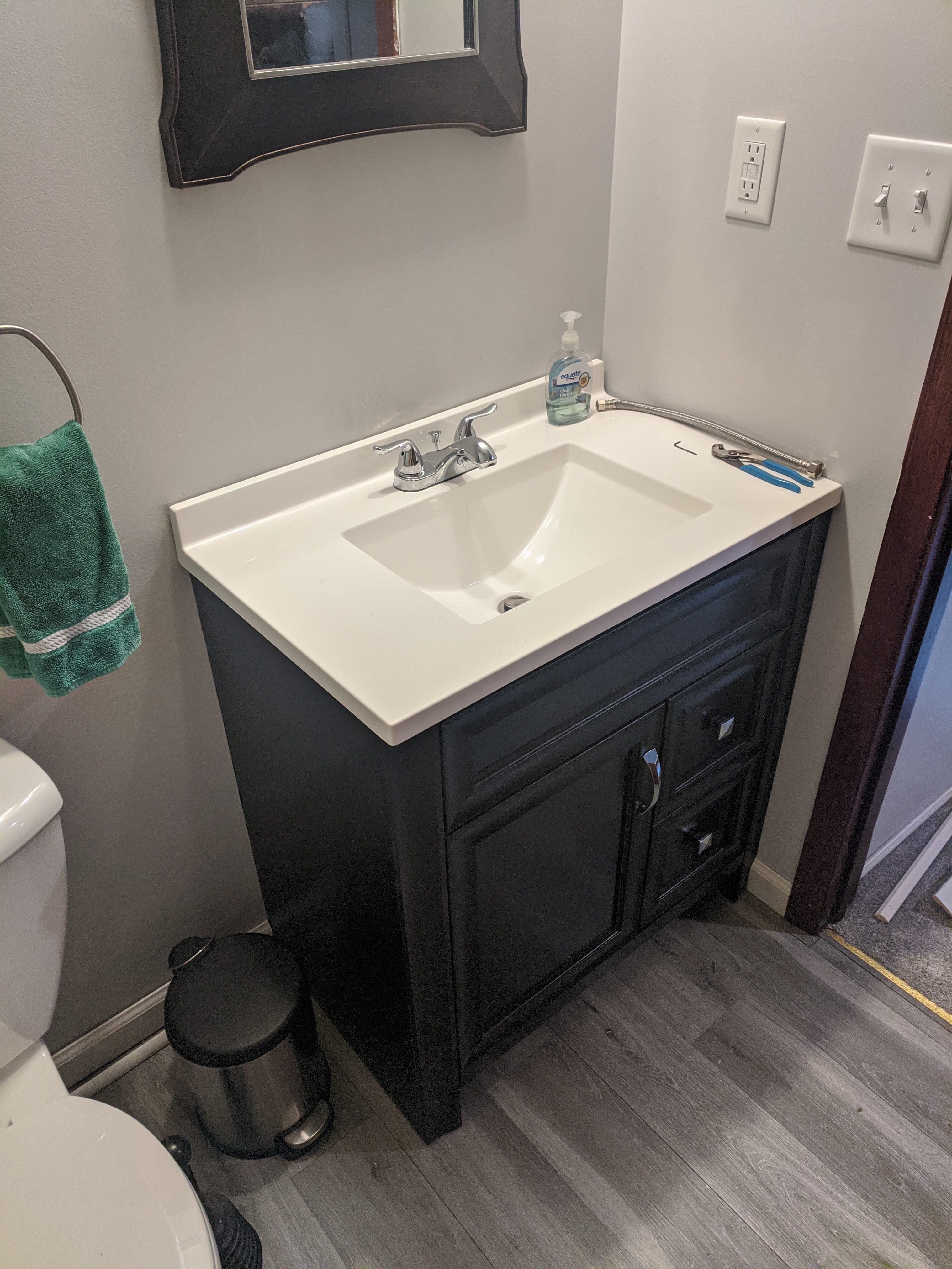

Previous owner of the house must have remodeled the basement bathroom pretty shortly before the sale. It did what they wanted, it looked good in the walk through but after a year living here there's been a lot of annoyances come up.
For whatever reason the vanity was 24" wide and had a 6" gap between the wall and the side. I'm assuming when they built the bathroom originally they used a 32" vanity and when they replaced it they bought the cheapest one and stuck the drain in the middle. There was a really dumb 6" wasted space, there was limited storage space and I have a deep down hatred for white cabinets.
Wife found a new never installed 32" vanity for $220 on FB. Looked like a $380ish unit from home depot. Got there turned out the guy must buy overstock returned or closeout stuff, offered $150, got it for $165.
Had to reroute the drain a bit but it's a good improvement. Also swapped the towel rack from the old one that looked like it came out if a bad 1980's attempt to clone something that came out of a hunting lodge.
Still need to swap the light fixture since that also looks like a bad 80's attempt at something that belongs in a hunting lodge but that's farther down the list.
Out with the old
And the new
Out with the oldView attachment 155405
And the new
