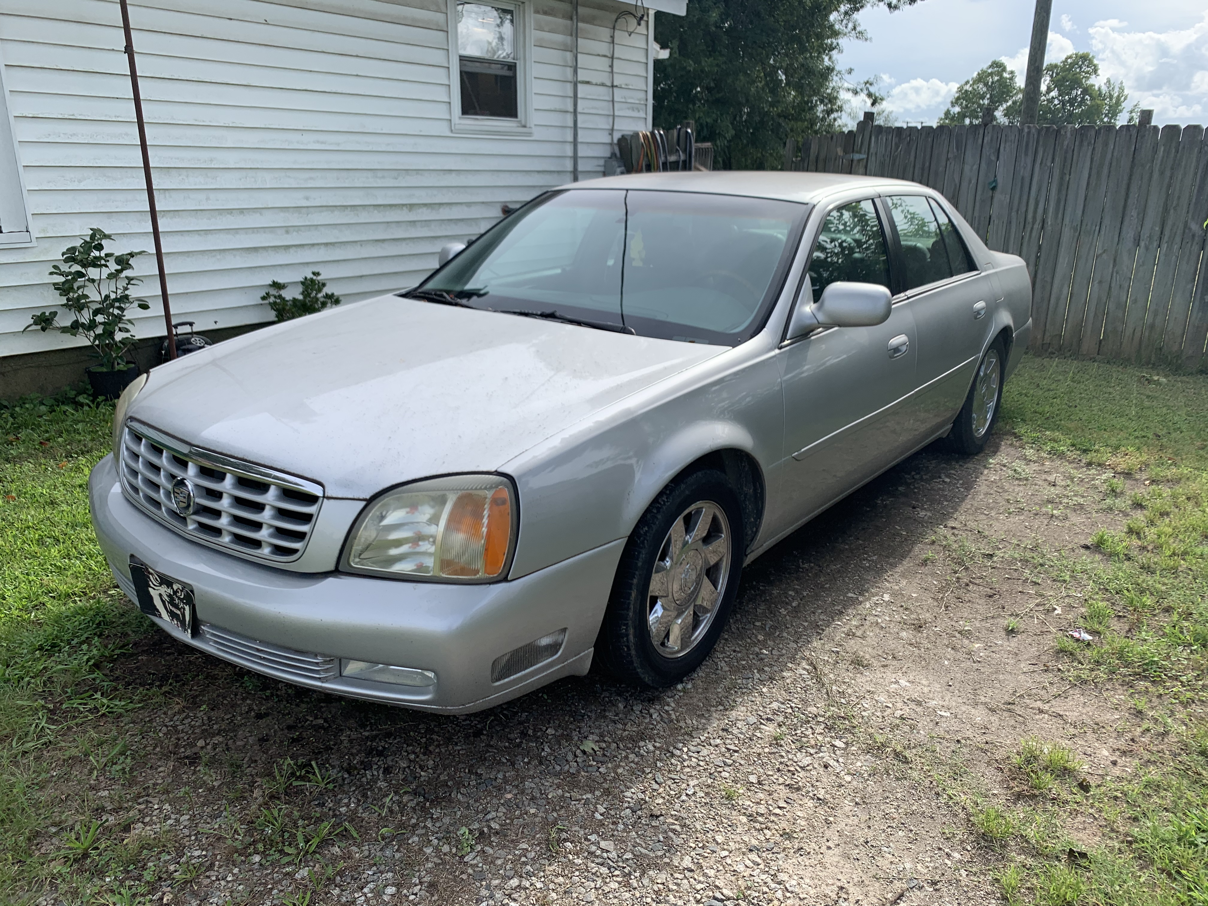

Since Ralph the truck died and departed, so I replaced the non-g project.
meet “Cinder block v 2.0” ( yes there’s a story behind that)
