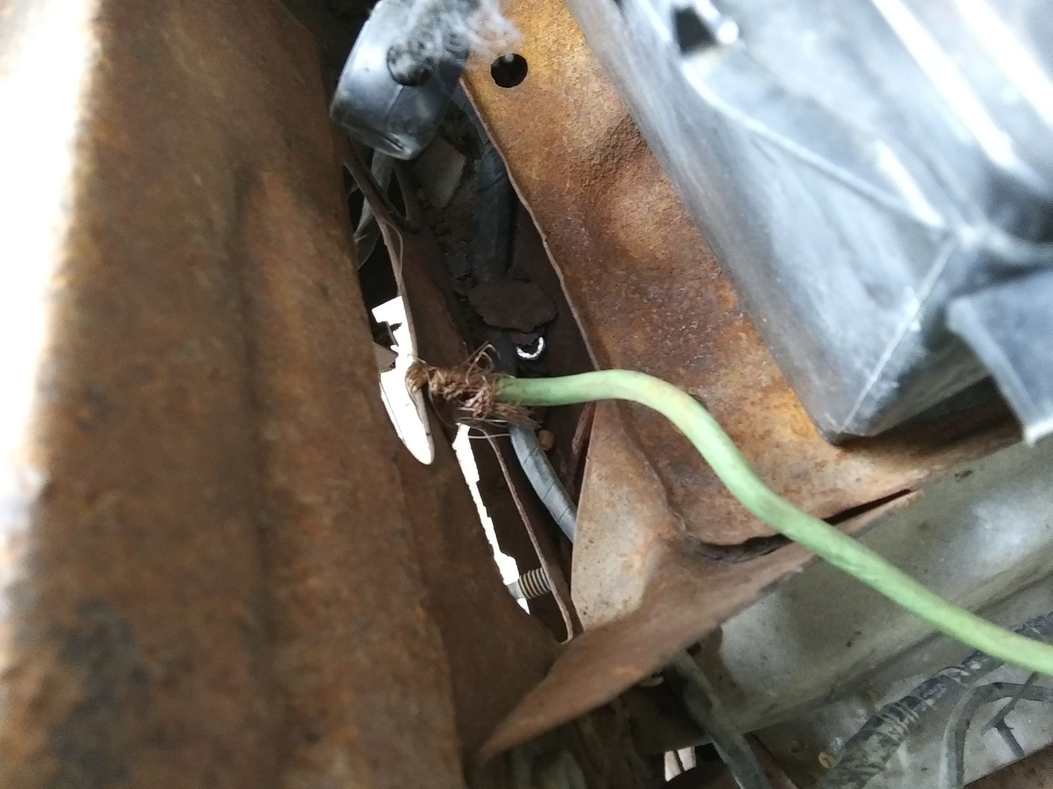

Untweakerfied the starting/charging wires. My favorite was the "ground" wrapped around the core support, runner up is the positive an inch from the horn. New battery, and new wires. No more dragging on startup, because ****in duh.

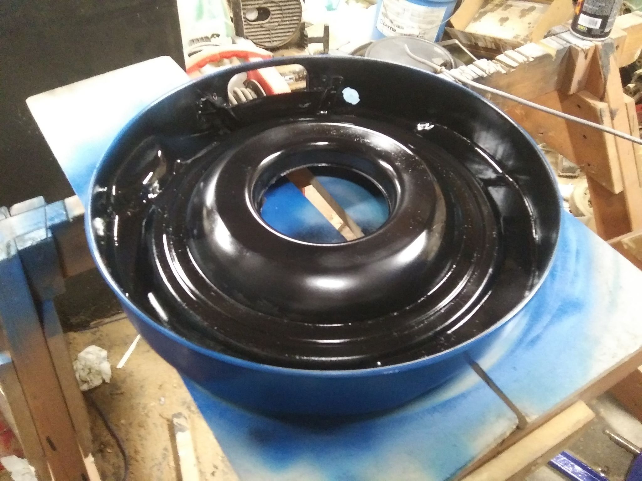

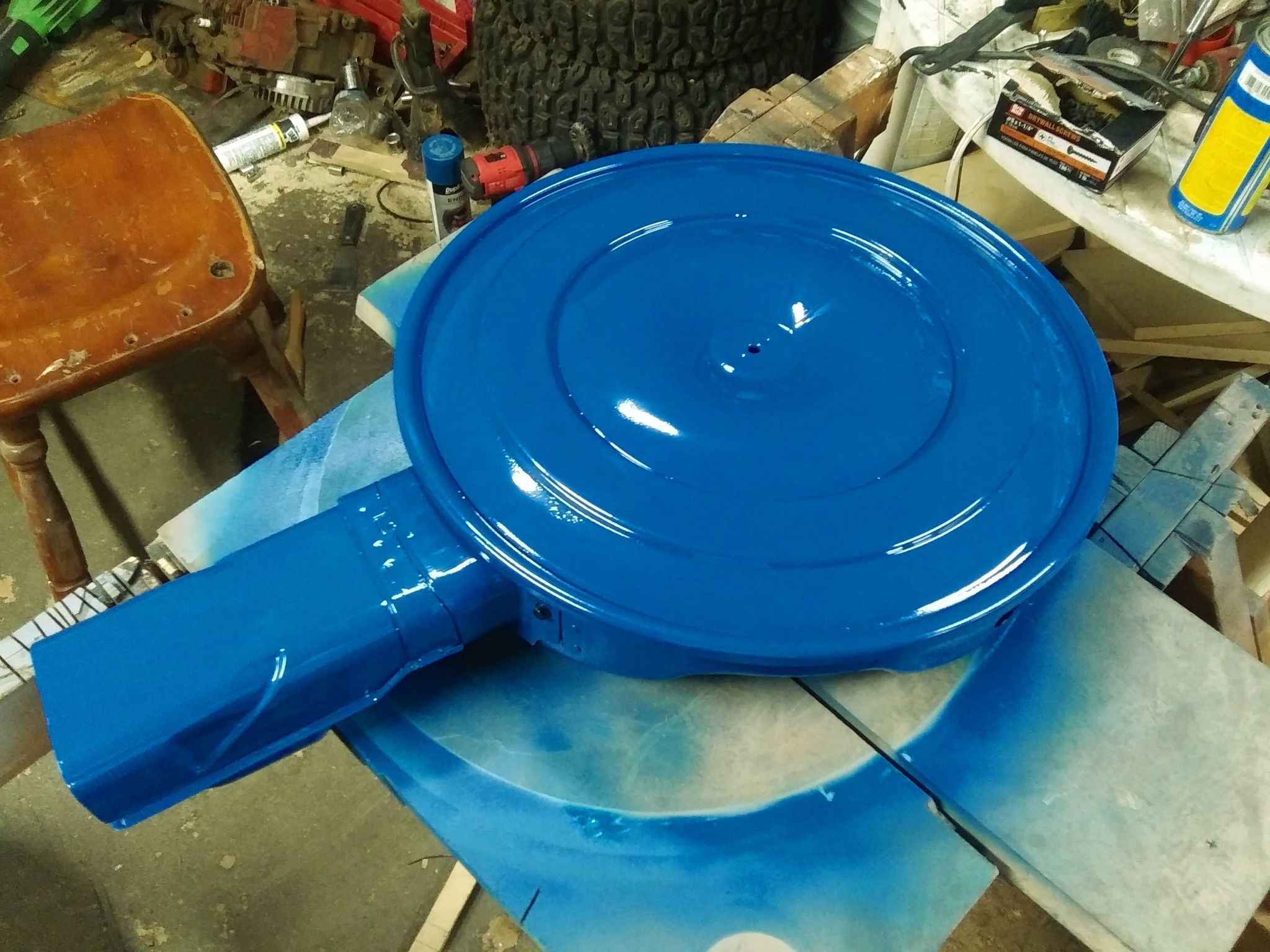

Replaced filthy air filter, STP #324A for those curious. Also repainted air cleaner housing. Not pretty, but better. Valve covers will get the same treatment.
Is that really where the factory ground cable connects?
Agree on question. You’re counting on connections through the brackets. Suggest bolting the system main ground to the block, and make sure there are good block-to-body grounds. What is the factory setup for a 307?
On the Galaxie, we have it bolted to the lower front corner of the passenger side of the block. I think the hole is 7/16 so I welded the heads of 7/16 and 3/8 bolts together to create a "stud" that the negative cable fastens to. Not sure if I have a picture.

Nice work.
