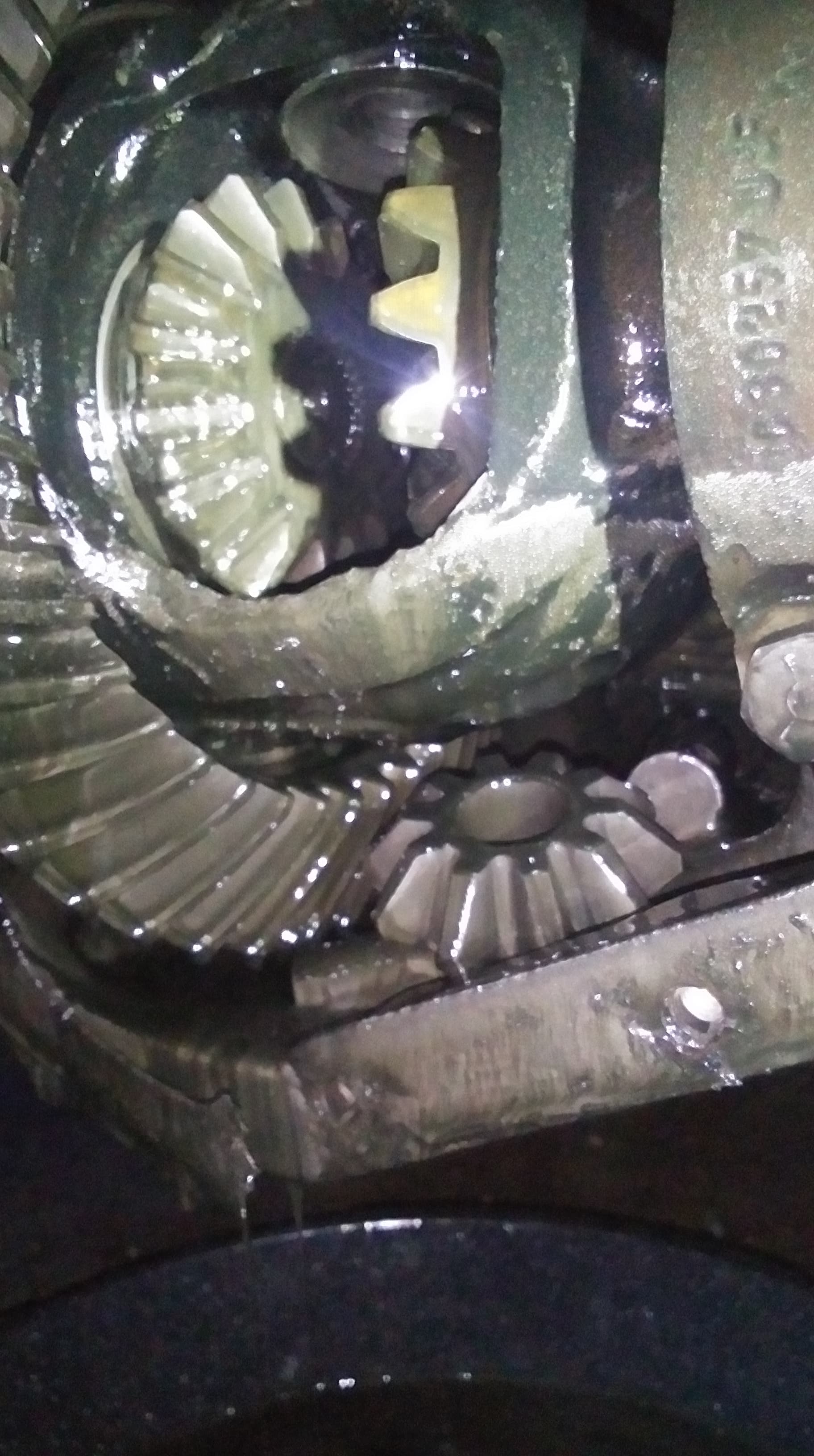

That's the plan once I get home at 6am. I bet it's spider gears. And yep, the dana 61 broke putting around town. Right infront of the Capitol.
cross pin broke in 3 pieces. cant find the 3rd. unless it has a smooth machined end and an end that looks like it was snapped off.
doesnt seem to be any damage to the ring or pinion or spider gears. sh*t i think a new cross pin thing and ****in send it
yep, send it!
Concur, I've done this to a diff that did damage the ring and pinion and I still sent it.
