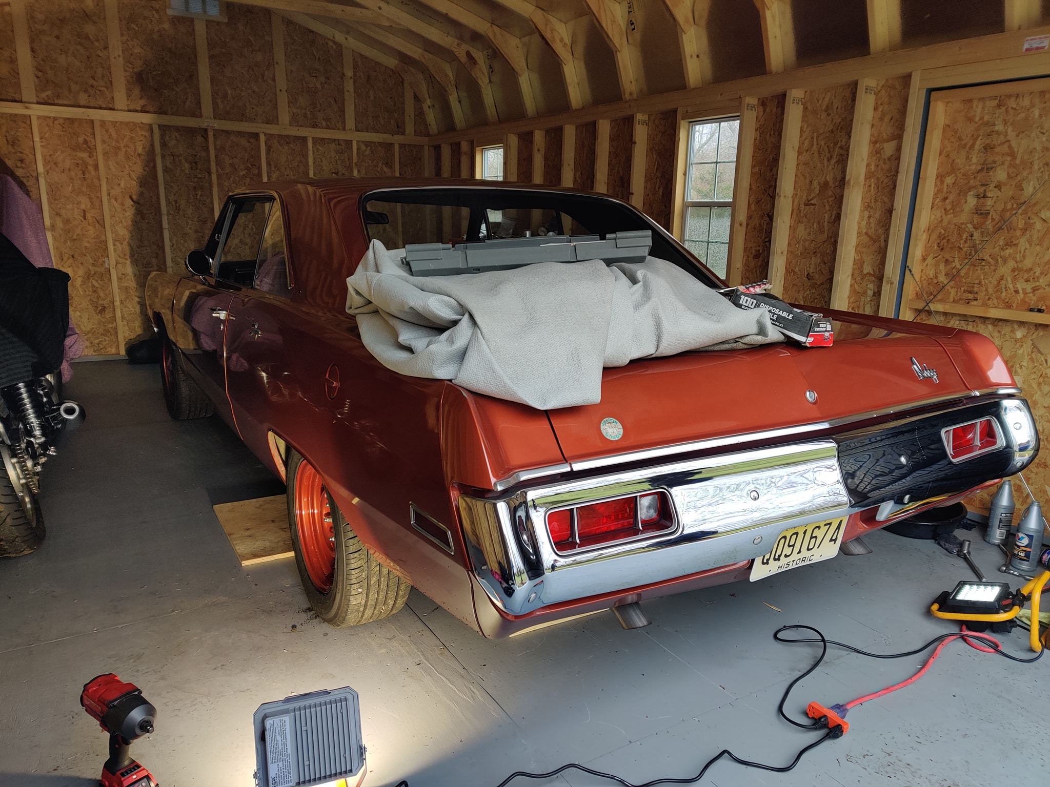

i swapped the open end 2.94 gears out for a 3.23 sure grip center section. also put new axles in. when i originally ordered the converter for the car it was built for a 3.23 gear that i knew was going to go in sooner or later. the axles i took out were mopar c-body axles cut down to a-body size by moser about 25 years ago. figured the rear was the only thing not gone through when i did the 360 a few years ago, so i may as well do it when i swap gears. have had all the parts laying around for about 2 years now. being that everything is closed and we really aren't supposed to be out and about with this virus blowing through the states it was a good time to do it..

back on all fours.. test ride whenever it stops raining..
still have to put the proper speedo gear in. test drive first though..
