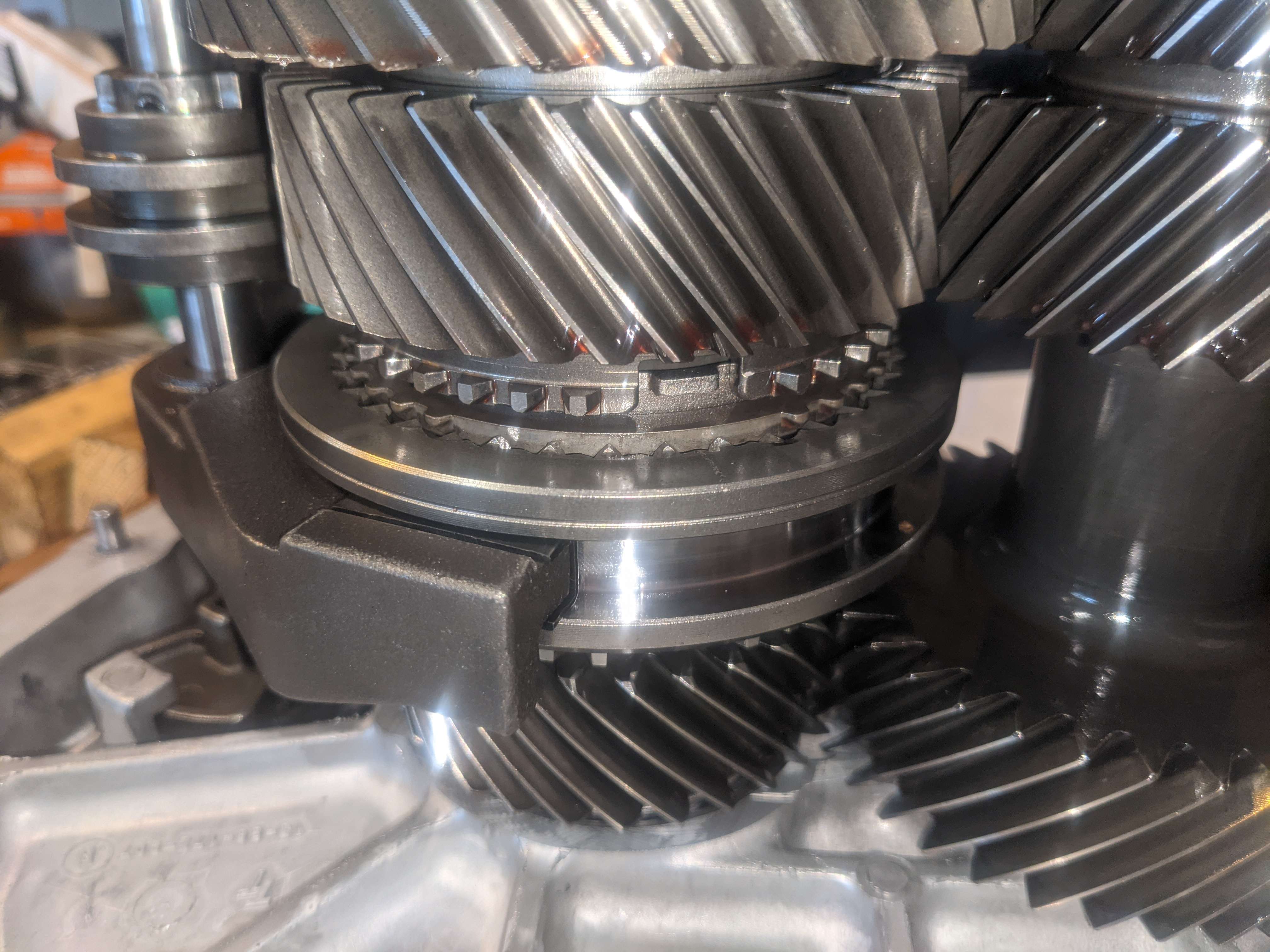

So my T56 parts order was supposed to show up last Friday. It did, minus a 2nd gear and billet 3-4 keys. Guess what goes on the mainshaft first? If you guessed 2nd gear, congrats. You won yourself a beer from your fridge. So Monday they check and proceed to overnight the parts. Got them yesterday, all is well. Forgot to put the syncro rings onto the mainshaft before pressing the small bearing onto the end, so get to take it all back apart again to do that as the 1-2 slider was too big to slide down the press. Today I set about popping in new seals and setting the bearing preload/endplay. Then I go for a real assembly and I begin to question where these raised teeth should be.
Am I lucky or good. They're centered in the void of blocker teeth. Crap, should they be there or with the rest of the teeth? Onto the Google machine I go, never found an answer, but then it hit me: dingus, the thing only goes together one way! So I'm neither lucky nor good. But in my searches I happened upon this article:

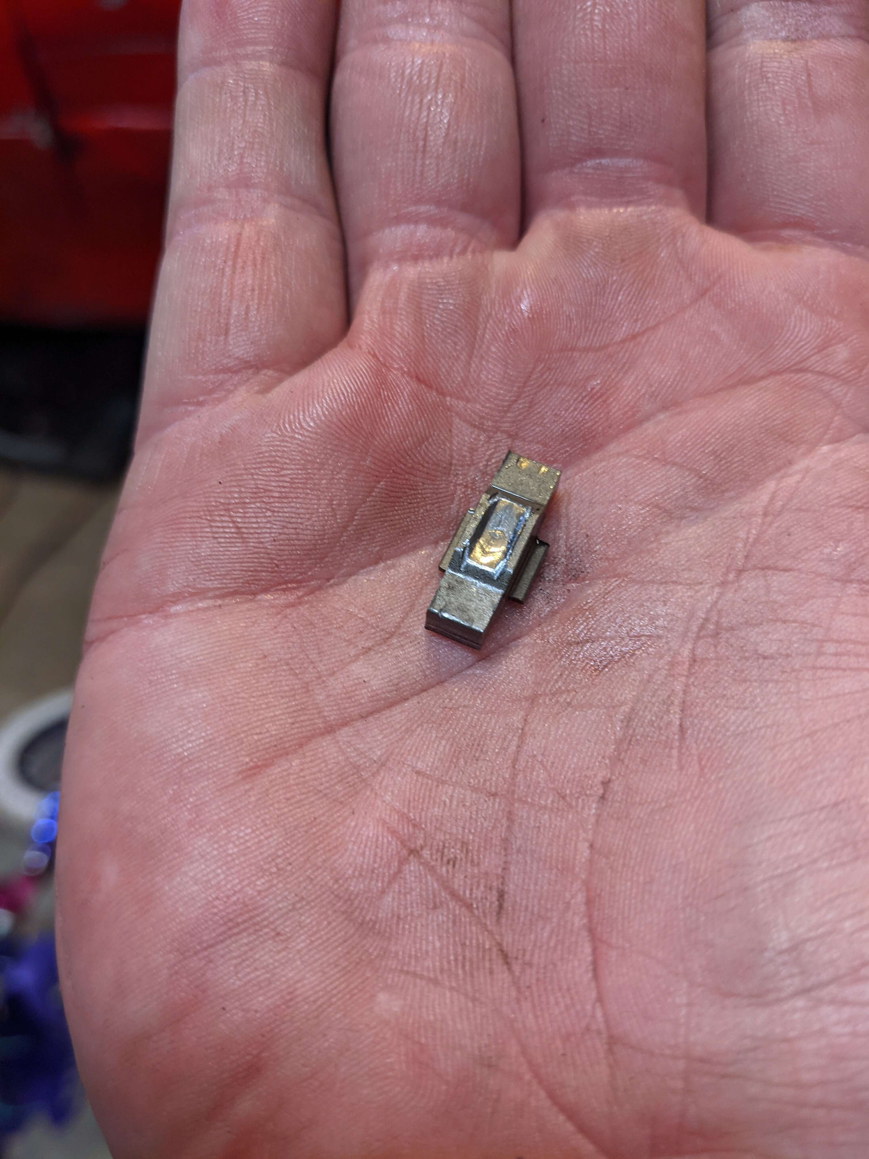

Drivers who rushed a shift or had a poor clutch release would frequently break the keys that were only stamped metal design. To cure this we began to use solid steel keys that were machined from billet alloy and were expensive. Now we found that while the keys were unbreakable, poor clutch release and bad habits would cause the synchronizer hub to crack at the key slot. Other companies began to market a solid key that was cheaper and made from powered-metal material. These powdered-metal products failed in a different way, where the ridge on top of the key to locate the neutral detent on the sliding sleeve would wear prematurely causing sloppy shifts.
Check out the "billet" keys I pulled from the Camaro over the winter.
This is the reason I put stock keys back in the Camaro. Of course because I beat it senseless every time I fire it up, I obliterated the stock keys in just 2 weekends. I figured the above mode of failure was more preferable, so fresh "billet" keys went back in. I figured that this must be the way it is. Until I found that article. Tomorrow I'll be calling Rockland, Tick, RPM, and anyone else worth a shjt to try and get a consensus on the billet key market because this Corvette box is a way bigger asspain to pull than the Camaro box, which is why I used it for practice in the first place. I don't want to be doing this again any time soon.
