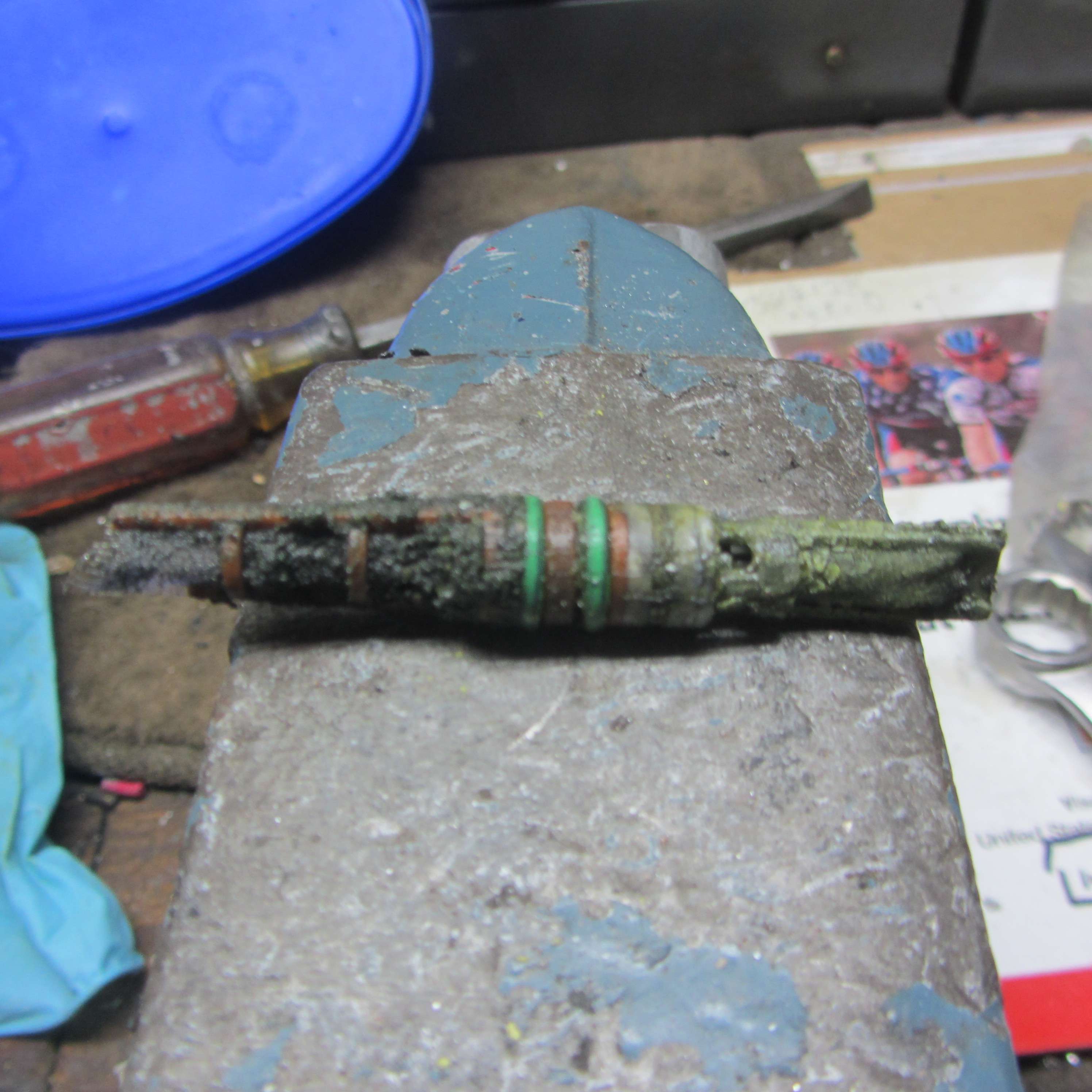

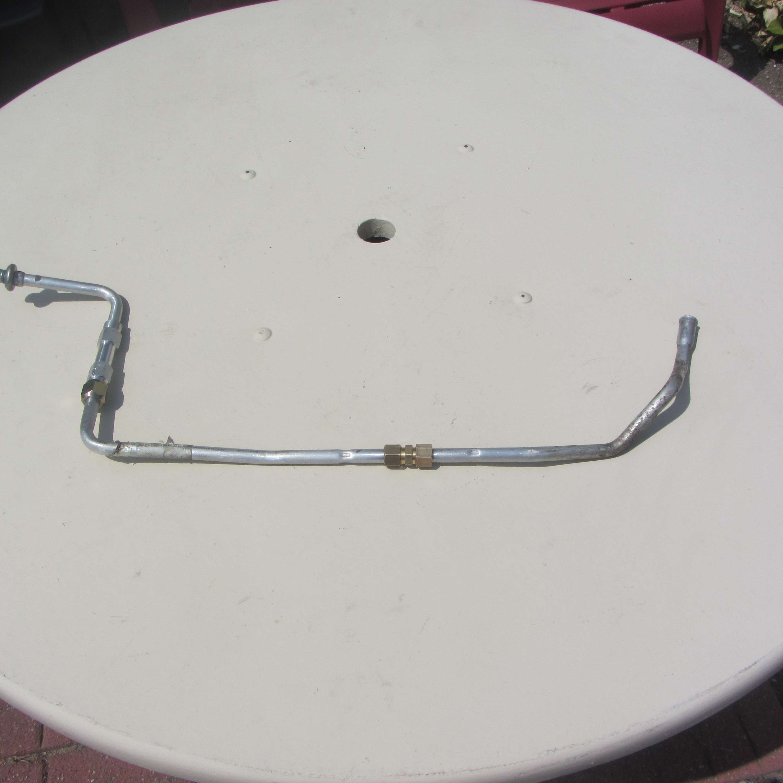

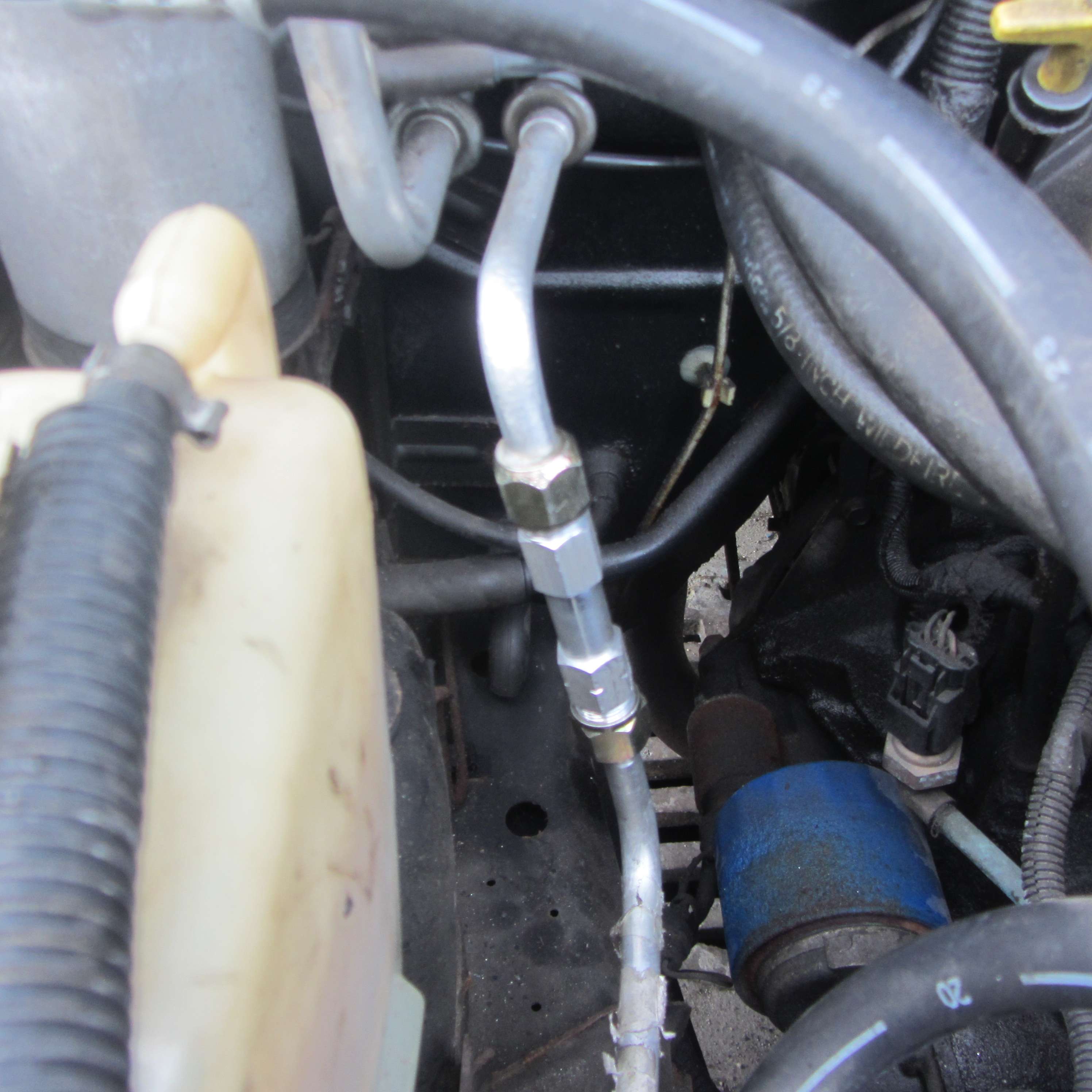

I have been battling my GYPs AC system for years. I refused to rip out the dash to get at the evaporator so I used a good sealer that has worked for me for years. It did actually seal the leak. But eventually my high side pressure got too high and was cycling the system on and off. I knew the orifice tube was probably clogged but mother NOPAR decided to locate it in the middle of the liquid line and used those impossible spring clamps at each end. After a day and a half of battling those clamps I got the line free. I cut the middle open and removed the totally gunked up orifice tube with 22 years of crud. IMG_0439.JPG Then I used a hardware store compression union to close it back up. I then cut the line where it was accessible, up near the receiver/drier. I used an orifice repair kit that someone on here wised me up to a while back. Now I can open the line and swap out an orifice tube without taking half the GYP apart. I charged it up without even vacuuming it down just to see if it leaked or worked. It works! I got 30° below ambient but my high side is still too high. Tomorrow if it didn't leak out I will evacuate, vacuum down, and add the correct amount of r134. A hokey fix but I am still refusing to open the dashboard for this. IMG_0440.JPGIMG_0443_01.JPG

I didn't know you could cut them and put them back together
