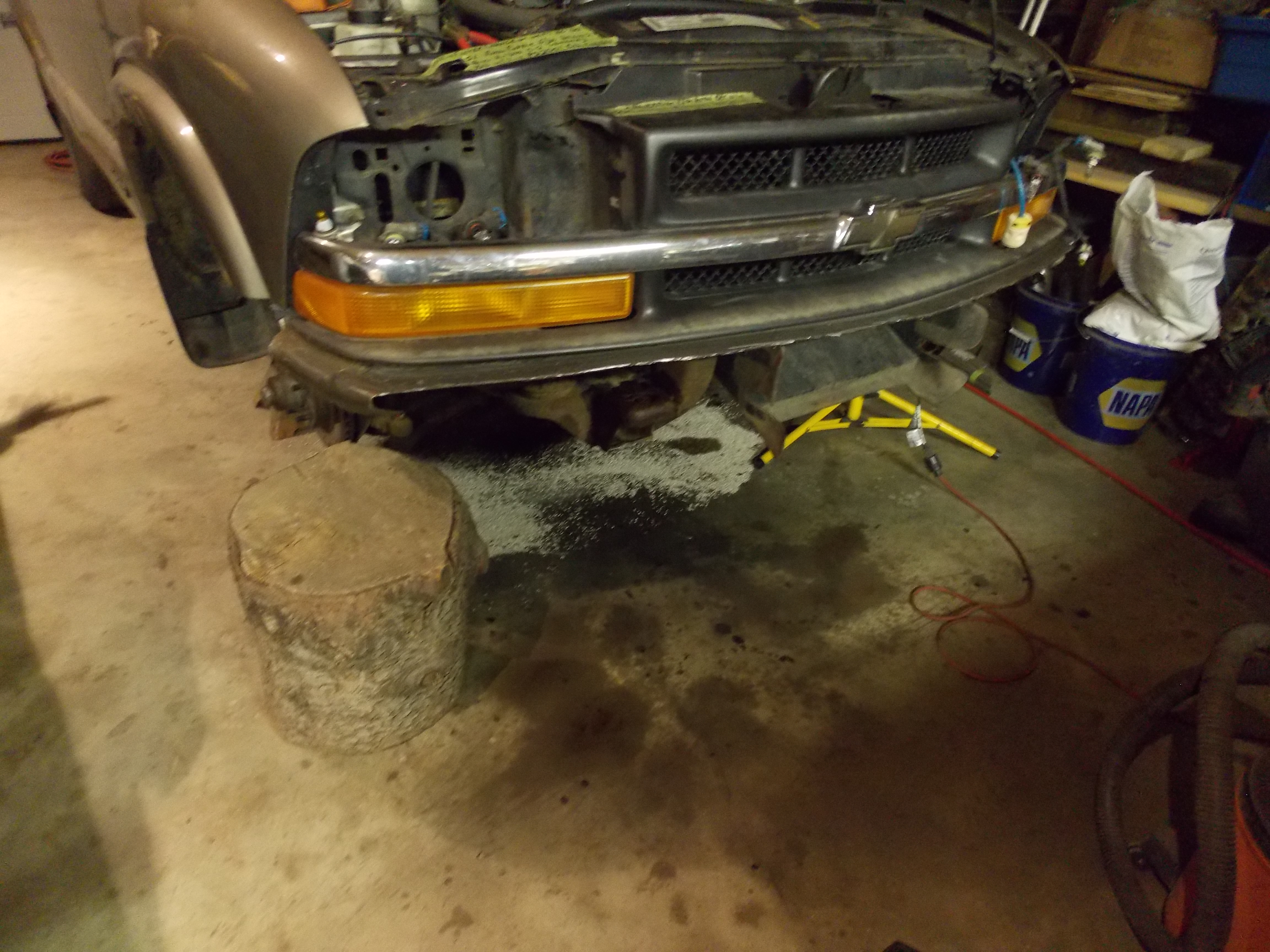

Further to the current status of the bumper in the pictures, it is now an Ex-Bumper. To paraphrase a famous quote from Monty Python, "It has ceased to be. Subsequent to getting off work this pm I headed for the shop, got into full welding mode with apron and jacket, added mouse muffs and a face shield, booted up the compressor, and proceeded to finish off the existing wheel on my cut-off motor, plus another whole wheel, plus part of yet a third by way of cutting away a significant amount of the bumper's corpse. That got me access to the push pins that held the lower fascia in place so that it could be removed. All that taken care of, I applied another shot of Deep Creep to the shock mounts and left it to soak some more.
Before I proceed with more demolition on the bumper I should take a few pictures to show to the point to which I have gotten. Don't expect much. Most of what was still holding the bumer together was the paint and undercoat. To put a point on it, the rust had rust! And that rusty rust had tin worms that were suffering from terminal cancer.
the only reason it didn't just fall off the car is that it was nailed on. lovely plumage, though!!

Other than that, I did manage to dismantle more of the front bumper. Only the upper center section is left and for that I have to figure out how to remove the grille. it is held in place be some kind of pressure clip and it is all plastic so extreme caution is on the table. Looks like a little manual time is in order.
Also threw a wrench at the upper nuts on the shocks and discovered they are pretty much welded to the shafts. So Plan Be will be an air tool assault.

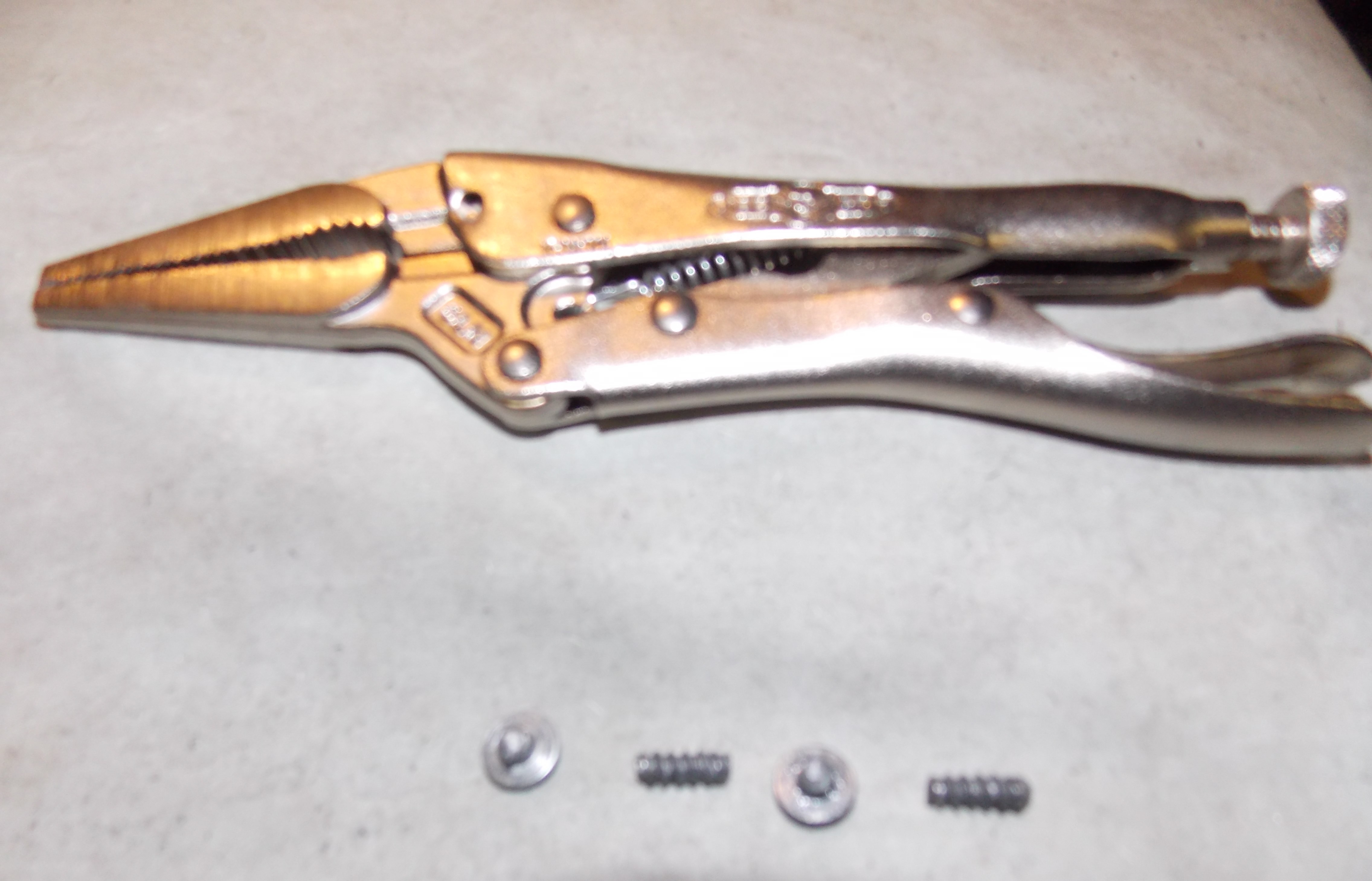

Thought a pic or two of the carnage might be appropriate so here are the corpses of the two screws that secure the distributor cap to the body on an S-10 distributor. In the background is the pair of thin jaw vice grips that got me down onto the screw stump and let me extract it. The only other option would have been to lift the distributor body completely and do teh work on the bench.

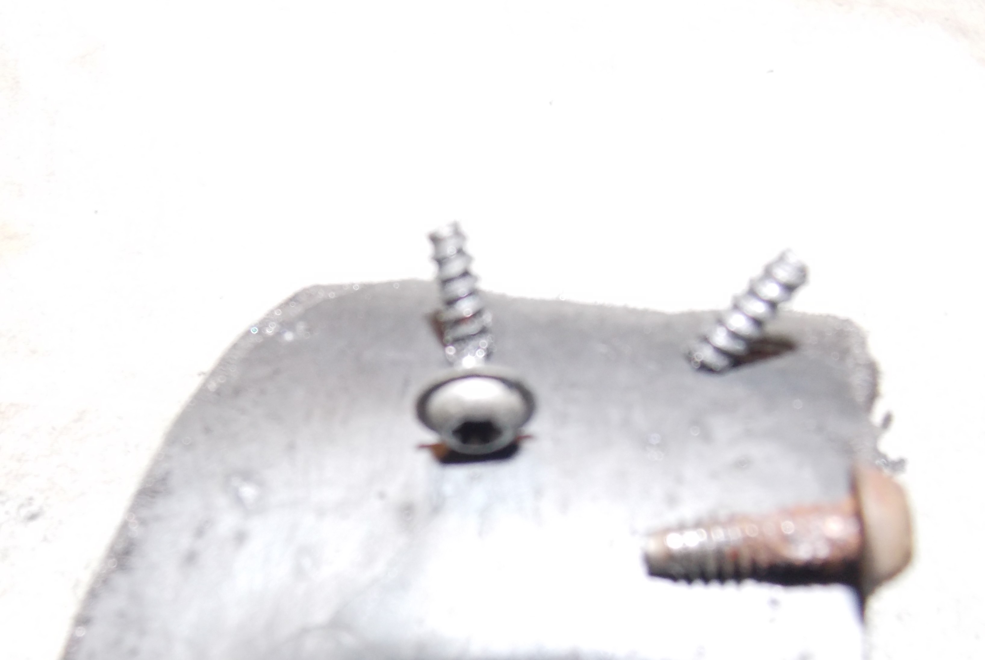

A close up shot of those screws showing how flimsy they really are. The one on the right lower came from the test bed timer and clearly shows rust and erosion of the metal.

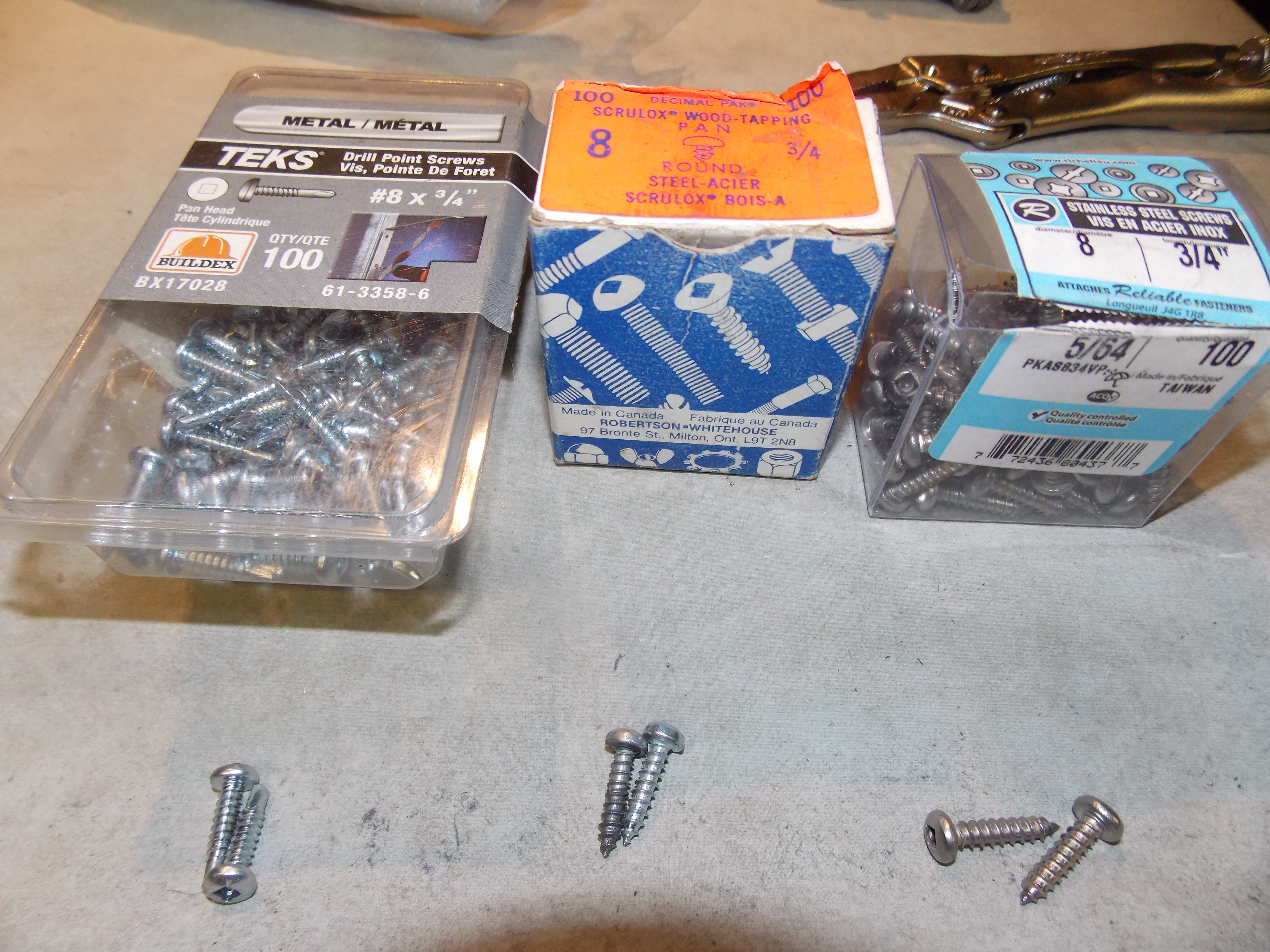

From left to right, the three options that I came up with. On the left is the #8 Tek screws, in the middle is a standard #8 pan tapping screw, and on the right is the Stainless version of that tapping screw.

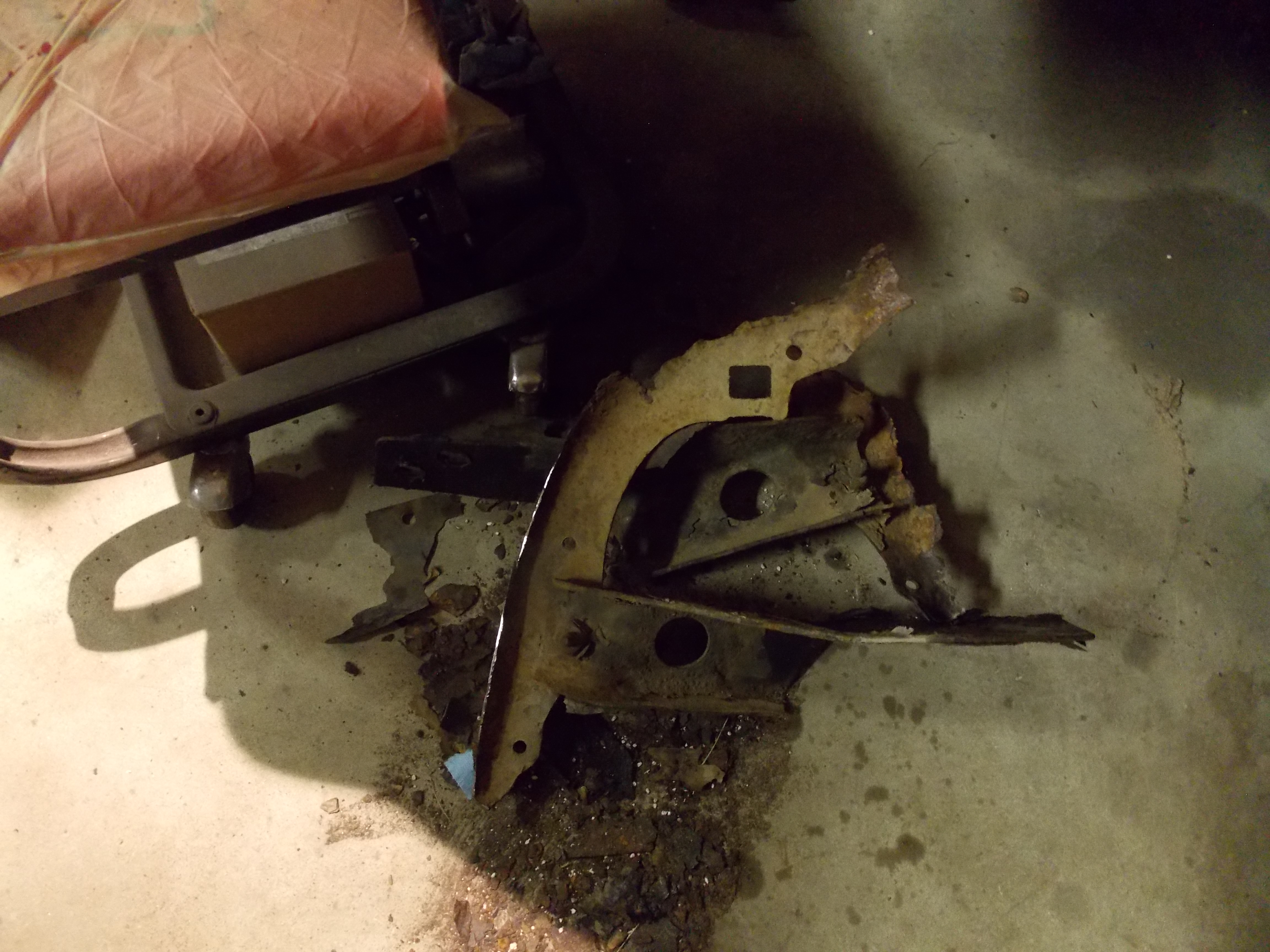

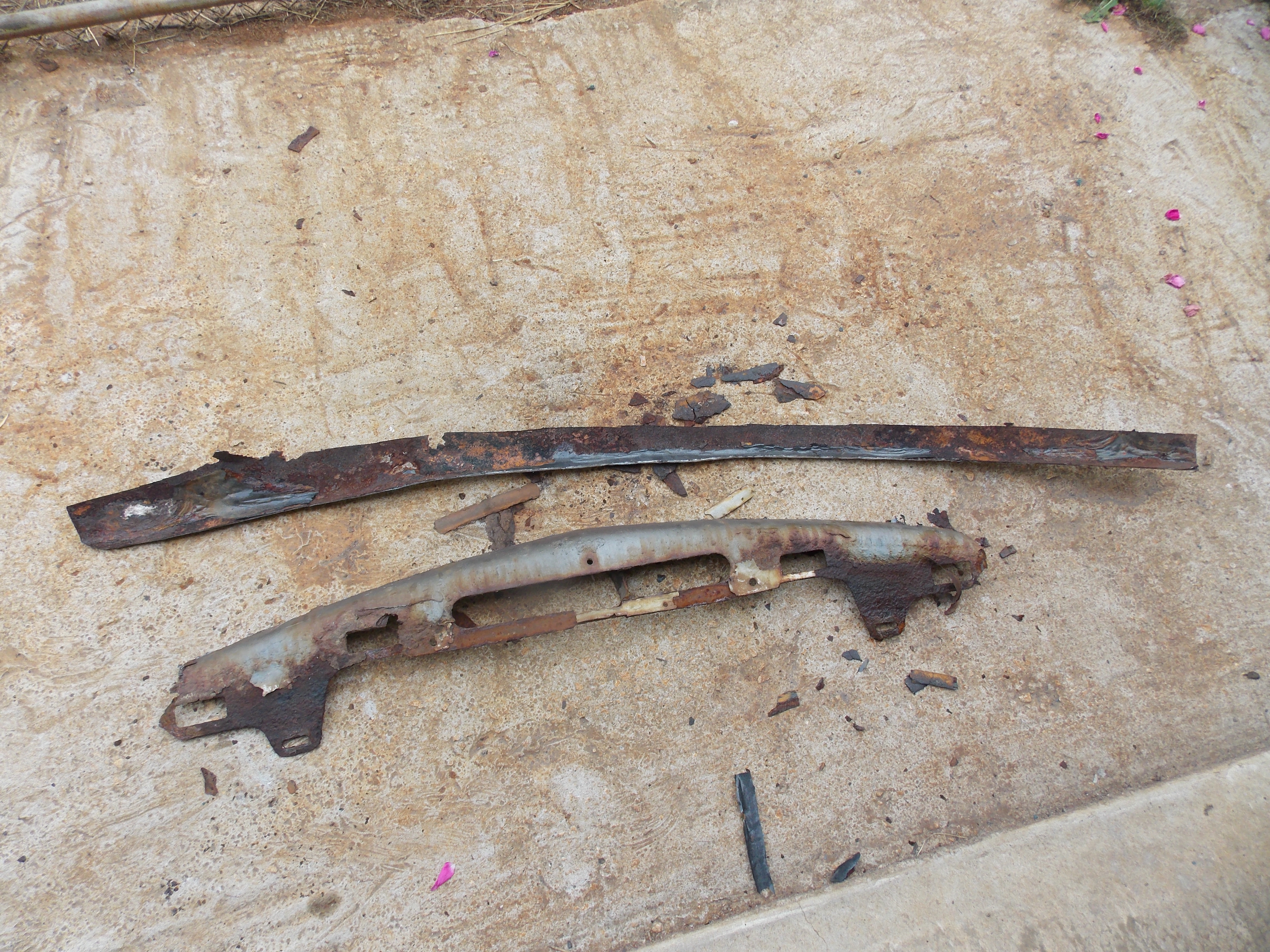

The end caps for the old front bumper. Once I removed the attachment bolts that held their brackets to the frame, they fell off.
And the remains. The last section to be removed will be the upper bumper face. For that I will need to remove the grille. In that last shot you see the front and lower faces of the old bumper, post removal. The bits of rusticle that are laying randomly along side the sliced and diced are typical of what was left to hold it all together. Not even worth cleaning up for donor metal. RIP. The frame horns and brackets are still very solid and will be getting wire brushed and cleaned and a generous coat of rust mort applied, then the usual series of paint/preservatives prior to the new bumper being hung.

Nope, not even close, but since we last crossed paths, the issue of the rotor screws has been more or less resolved for the present. I still have to source #6-40 x1/4 machine screws since it turned out that the number 8's were just not right once I was able to test them on the rotor shuttle wheel in the yard distributor that I scared up. For reference here in my narrative, I am calling it the test bed distributor since all the screws and bits get attached to it first to make sure they might work.
The self tapping sheet metal screws are a possible solution to Part Two of this problem, that being that the two screws that hold the distributor cap to its body have both failed; snapped off right under the screw head. One on the bench and the other on the distributor in the truck. My previous post shows the corpses of the screws and what it took to extract the one from the distributor on the engine.
The #8 screws, all three versions, were all possible replacements since they all threaded into the bosses on the test bed dizzies' base. Problem is that the base, like the cap is plastic, and does not take kindly to having things forced into place. The #8's need to be run in multiple times back and forth to get the plastic to "accept" them. Which both bothers and scares me because I do not want a repetition of the last screw's suicide.
However, this AM one of my little grey brain cells kicked me in the synapse and reminded me that there were metric screws in my stash that came fairly close to what I needed. So close in fact that the thread diameter and pitch were identical. Length came in at 15mm, and among the variety available, I had several pairs, one of which displayed identical heads at 7mm with a "2" stamped in the head. As a test I ran them into the threaded bosses on the test bed body and they went in without complaint.
So now I have a call in over at my Auto-Body supply shop to see if they stock this model of screw. These particular versions were salvage that, I think, came out of a G-Body dash, one of many, that I have dived into and dissected over the decades for various parts and components. Pull, the part; keep the hardware, because you just never know if a screw will escape or commit suicide.

Oh, yeah, for anyone else surfing this ongoing sage, You Tube proved to have a video on how to remove the upper grille assembly which gave me access to the final pair of bolts that used to hold the bumper in place. They came out and were bagged and tagged, the rusticle went out the main door to rest in piece with the other sections already cut and unbolted and tossed out.
