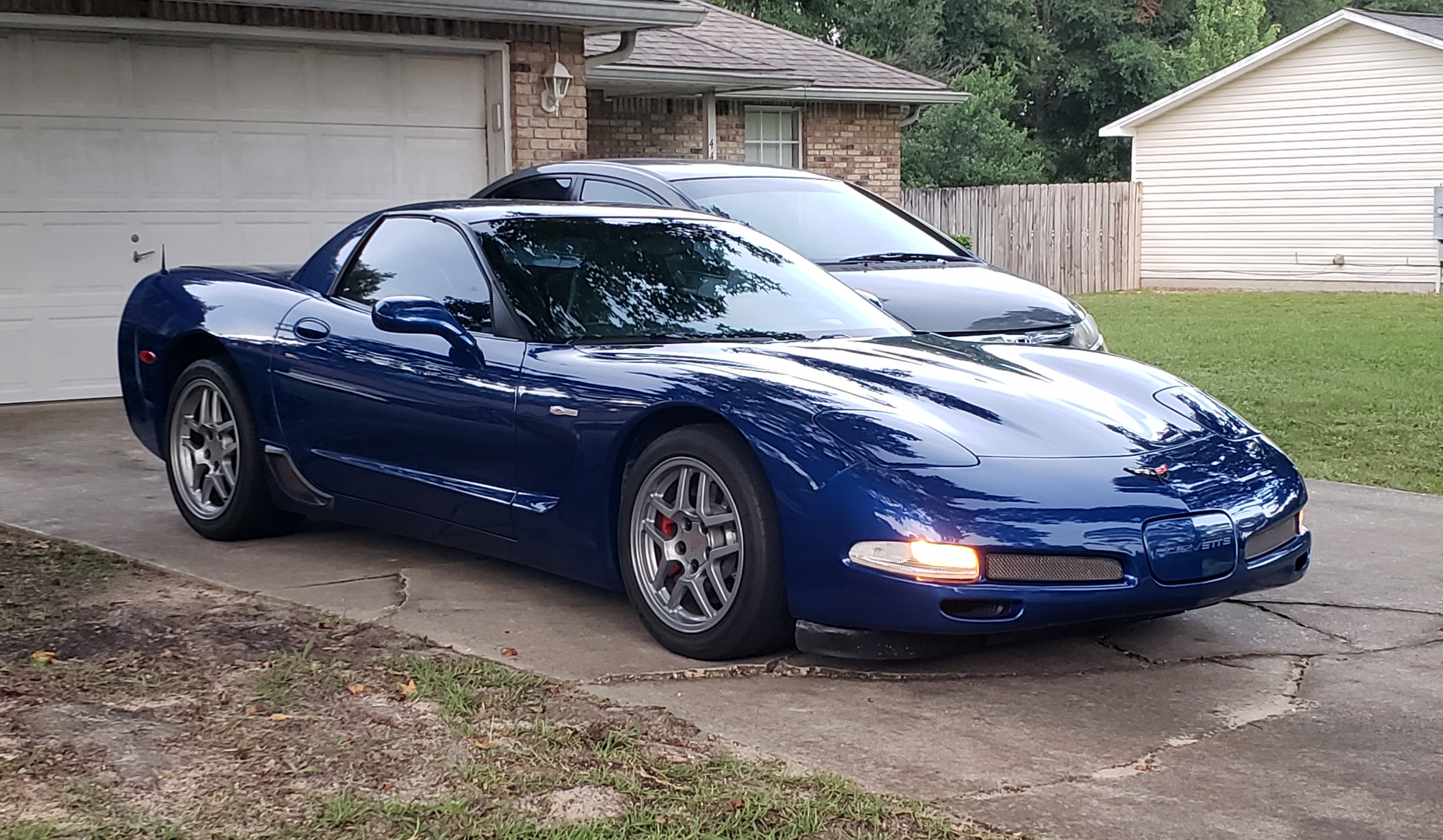

Out for a little spin around the block in the good weather, driver's side window doesn't work again it's the motor basically dry I'm going to get into that tomorrow..
Give the door panel a pop near the speaker, should get it moving again. I have to do that to mine every once in a while.
I'm going to pull the whole thing off and lubricate it with white lithium..
