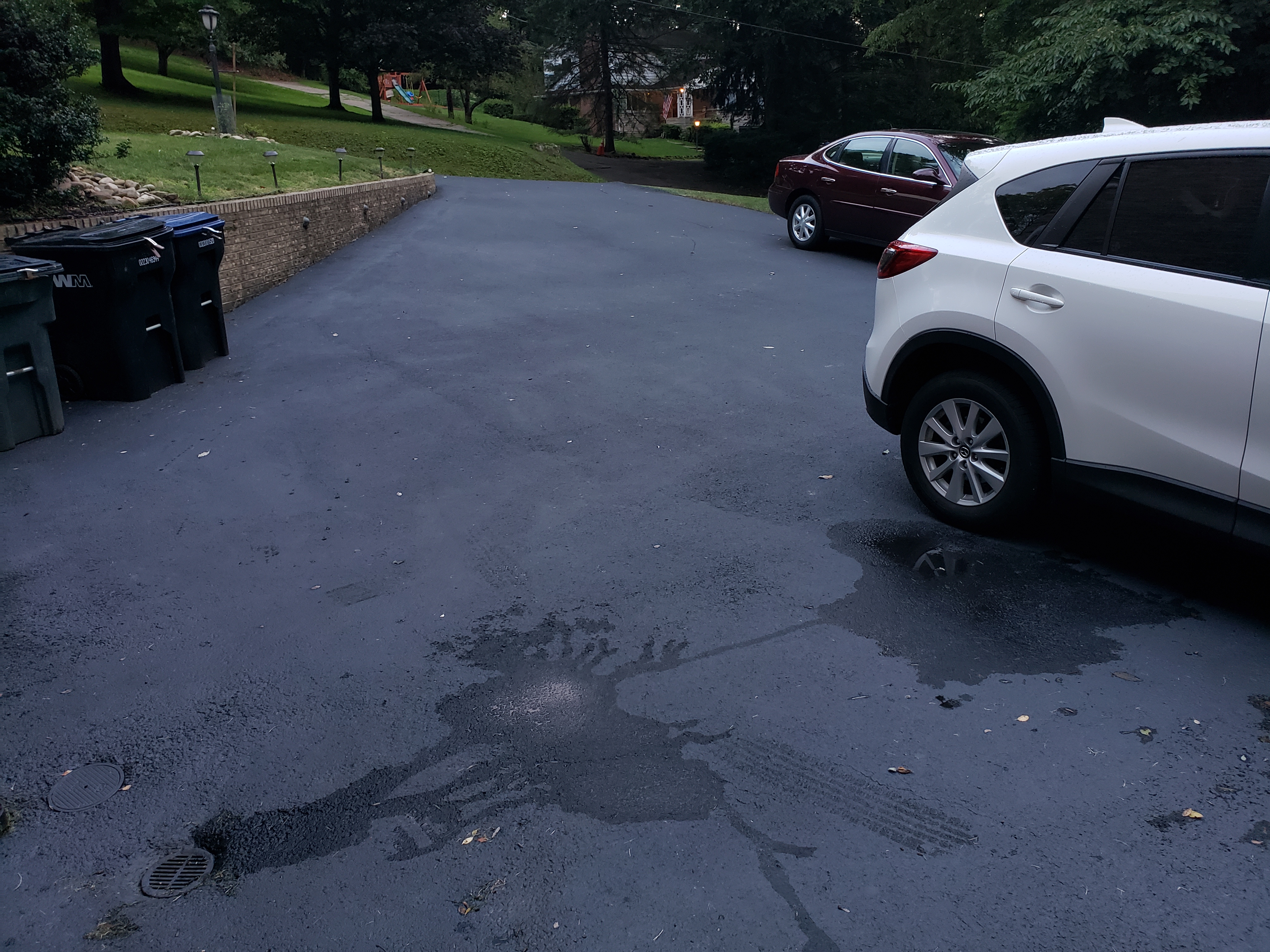

Wanted to work on the car today but it was rainy and humid and there was stuff to do around the house. Got the driveway sealed last week, finally able to drive on it today. Somehow the stuff managed to stick despite the countless quarts of oil that the Exxon Val-Dodge leaked all over it.

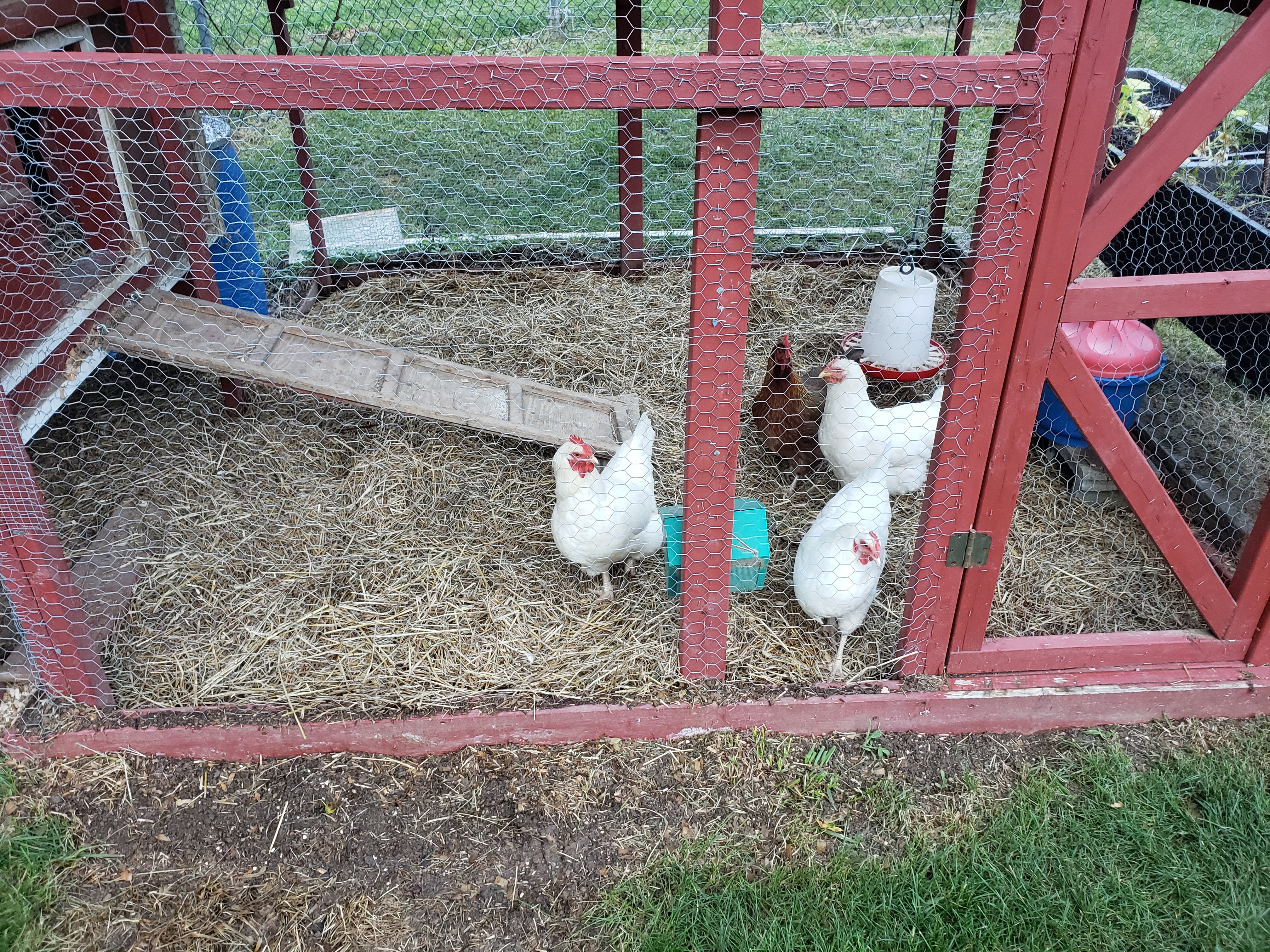

Cleaned out the chicken coop, it was long overdue. Chickens are happy now. These hens are 4 years old now and still laying eggs consistently.

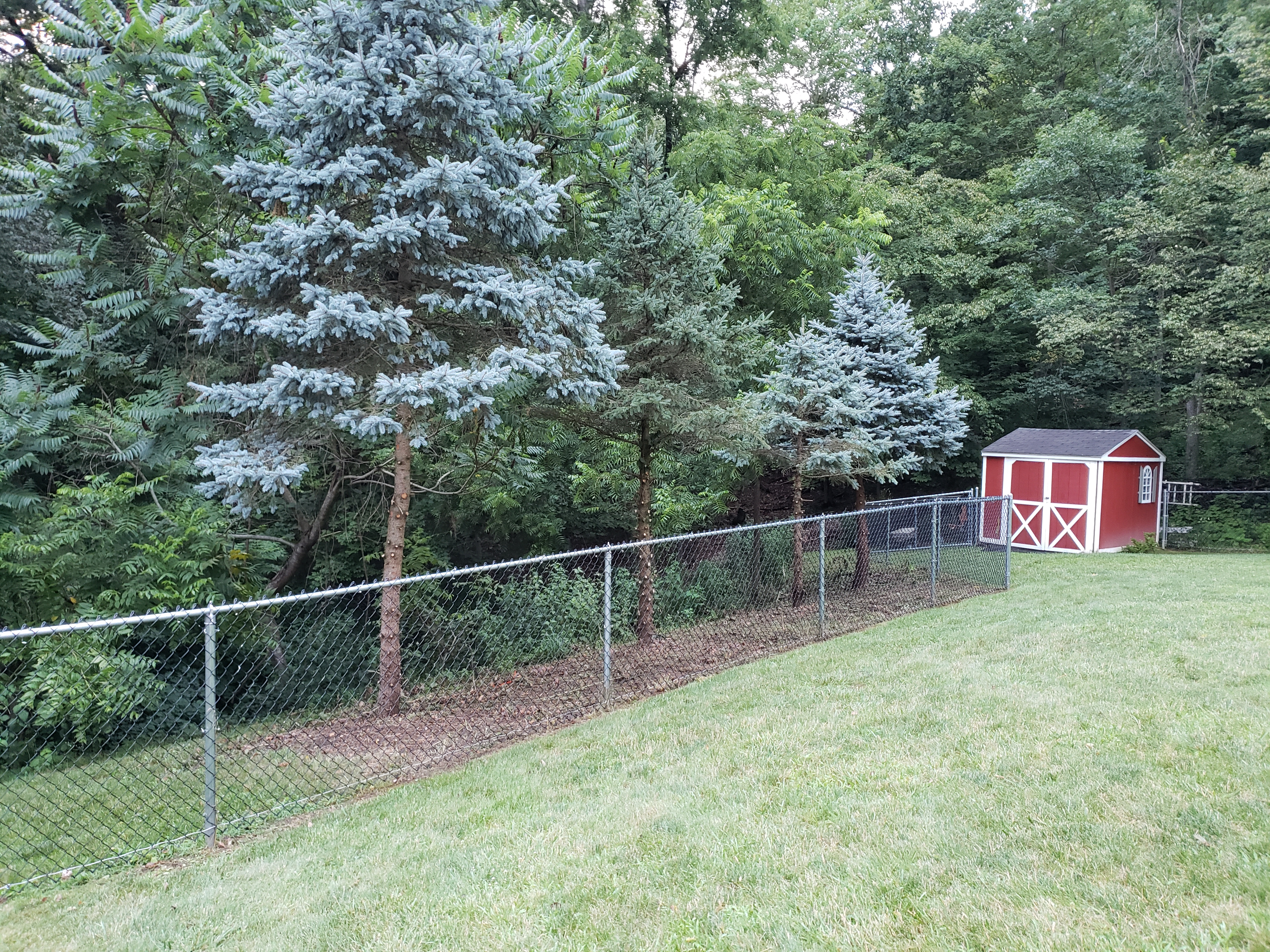

And I trimmed back the bottom of these four pines on the far side of the yard and cut down a fifth one entirely. They were overgrown and had a lot of dead branches. Also there are some really nice walnut trees on either side of them that I'd like to let grow in.

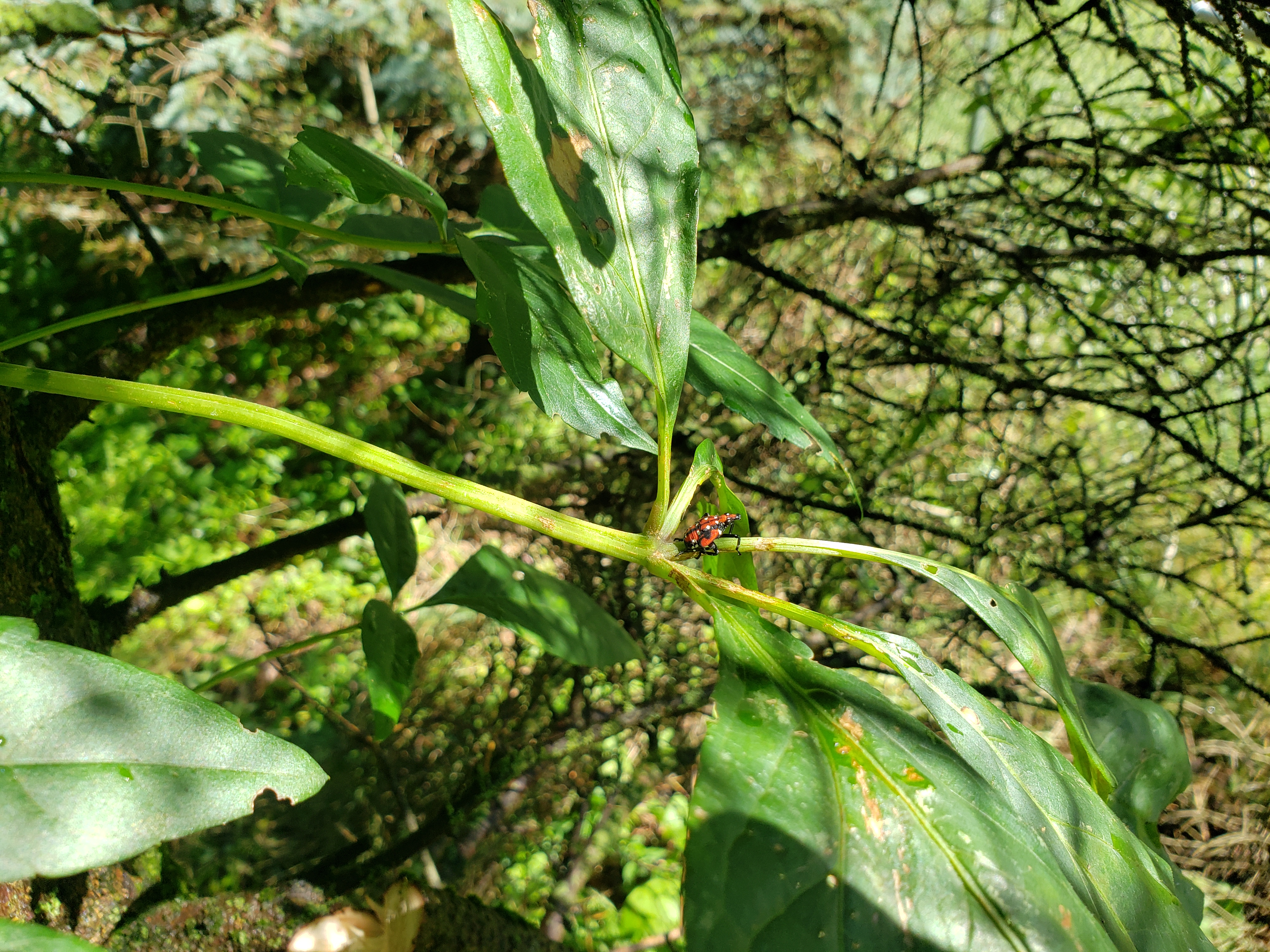

Unfortunately while I was cutting, I found some of these guys. Spotted Lanternflies. Highly invasive, super destructive insects. They are native to China but hitched a ride to the US a few years ago. They started in Philadelphia but now they are all over PA, Maryland, New Jersey, West Virginia and slowly spreading outward. If you see them, kill them.
Downside to the walnuts is they poison certain other plants and trees underneath through their roots.
If you plan to stick around there long enough, take that into consideration with what you plant or allow to grow nearby.

Look up Jugalone, its the name of the compound the tree produces, and what your plant palette should be tolerant of. Basically the root zone and the drip line, and/or anywhere you dump leaves and the rotting flesh of the walnut fruit casings.

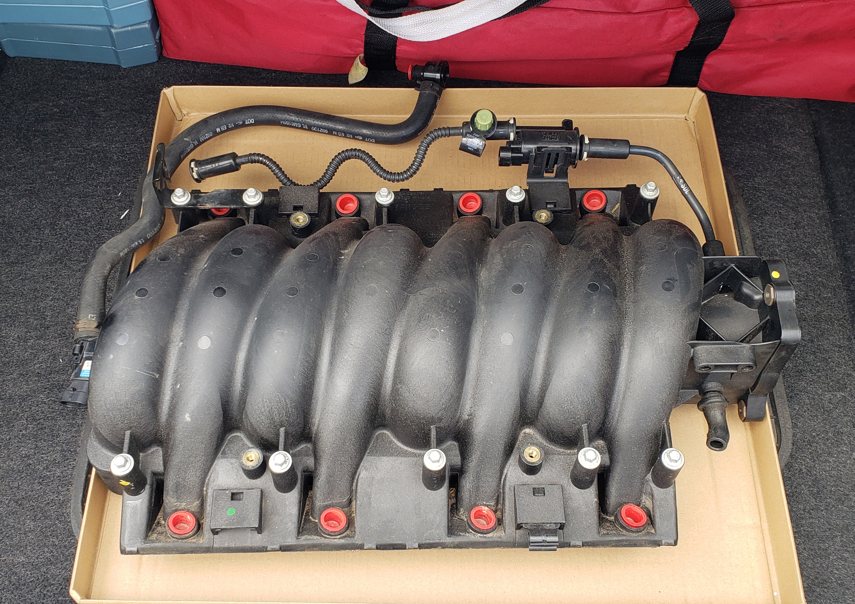

Snagged this LS6 Intake as is local for $100, guy pulled it from a 2001 Corvette Coupe so since it came from a LS1 it's all LS1 parts according to him.
Part number and flat bottom said otherwise..😎
