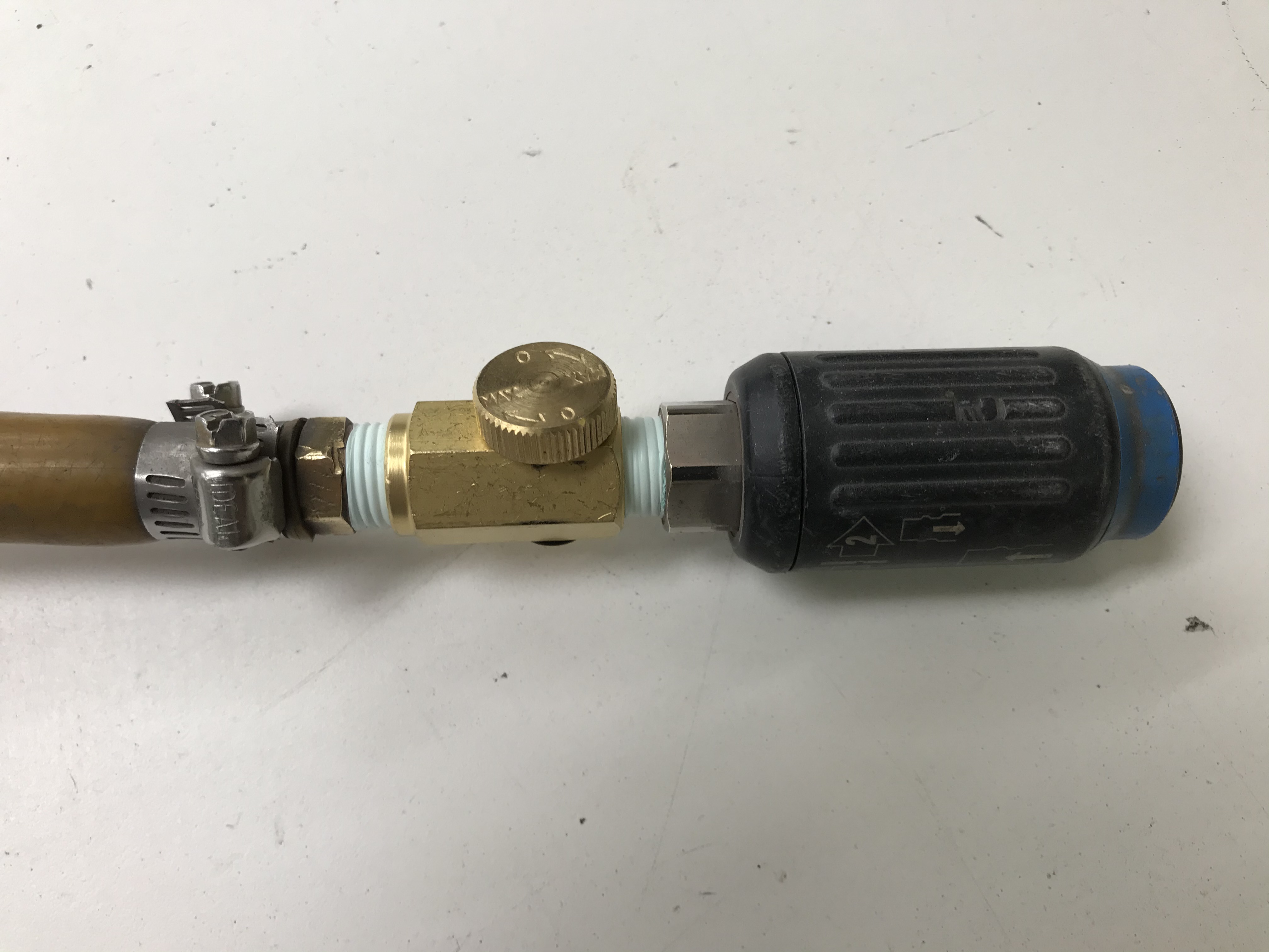

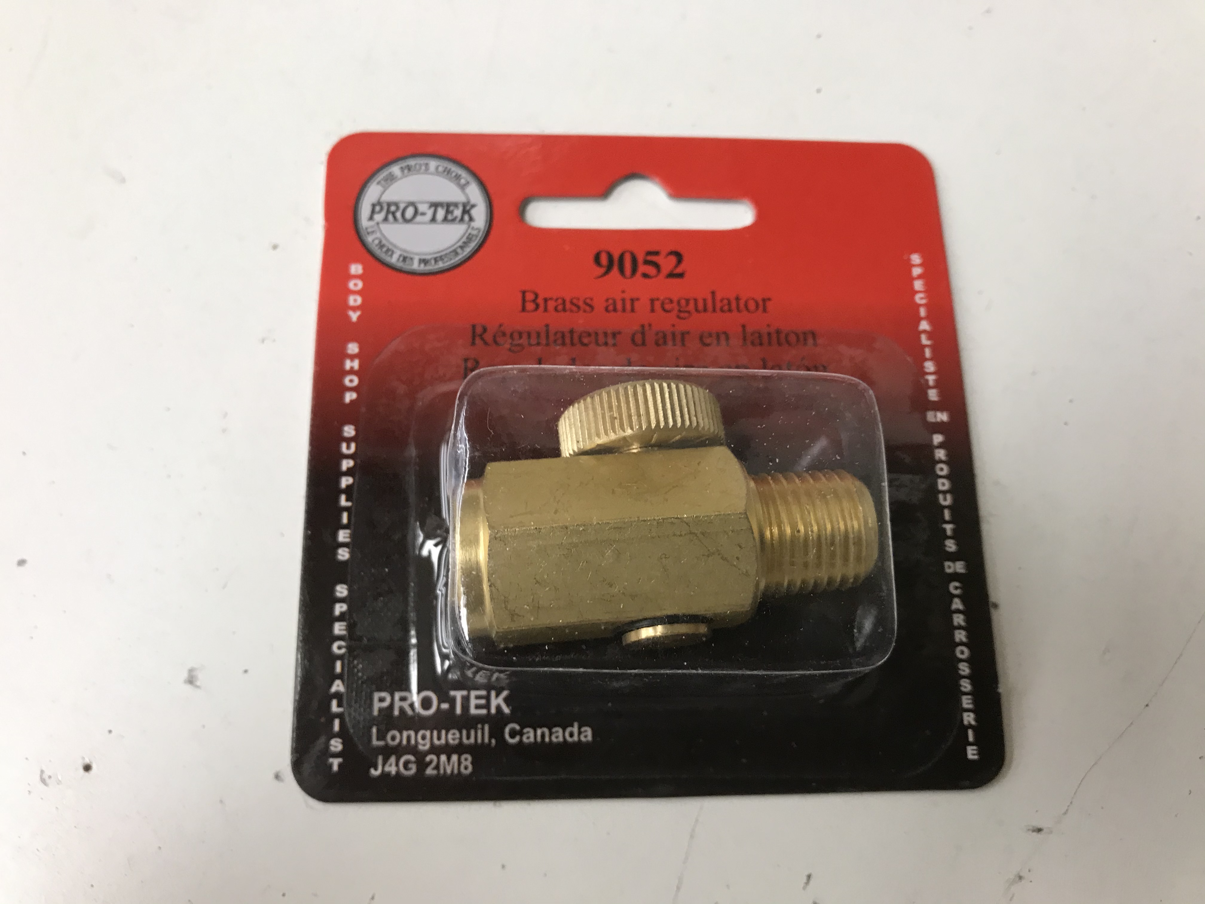

Nothing major, but yesterday decided to employ a little idea I've been considering for a while.
I have a large regulator for my air system hard mounted near the compressor, but there's been many times I wish I could adjust the air pressure as I'm working and with different tools at the same time.
So while I was at the parts store yesterday morning, I grabbed one of these little mini adjustable regulators and plumbed it inline on the hose before the coupler.
That way I can dial it up to full pressure for a cutoff wheel, change tools and dial it right down for a sander or whatever. Should be especially handy for my buddy Mike who’s terrible for using an air tool like a trigger: on or off.
Seems like a pretty obvious tweak to make, but you always see regulators mounted on the tool, not inline on the hose. I’ve used it for a couple days now already, and it works pretty damn good. Can’t believe this isn’t more common.

The problem I have found with them is... after some use they tend to leak. I know it is just o-rings, but annoying none the less.
